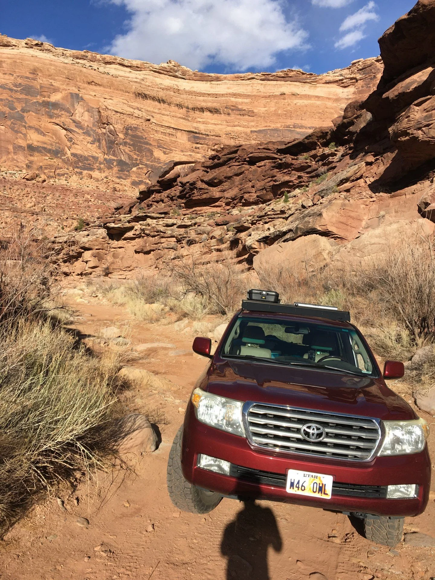

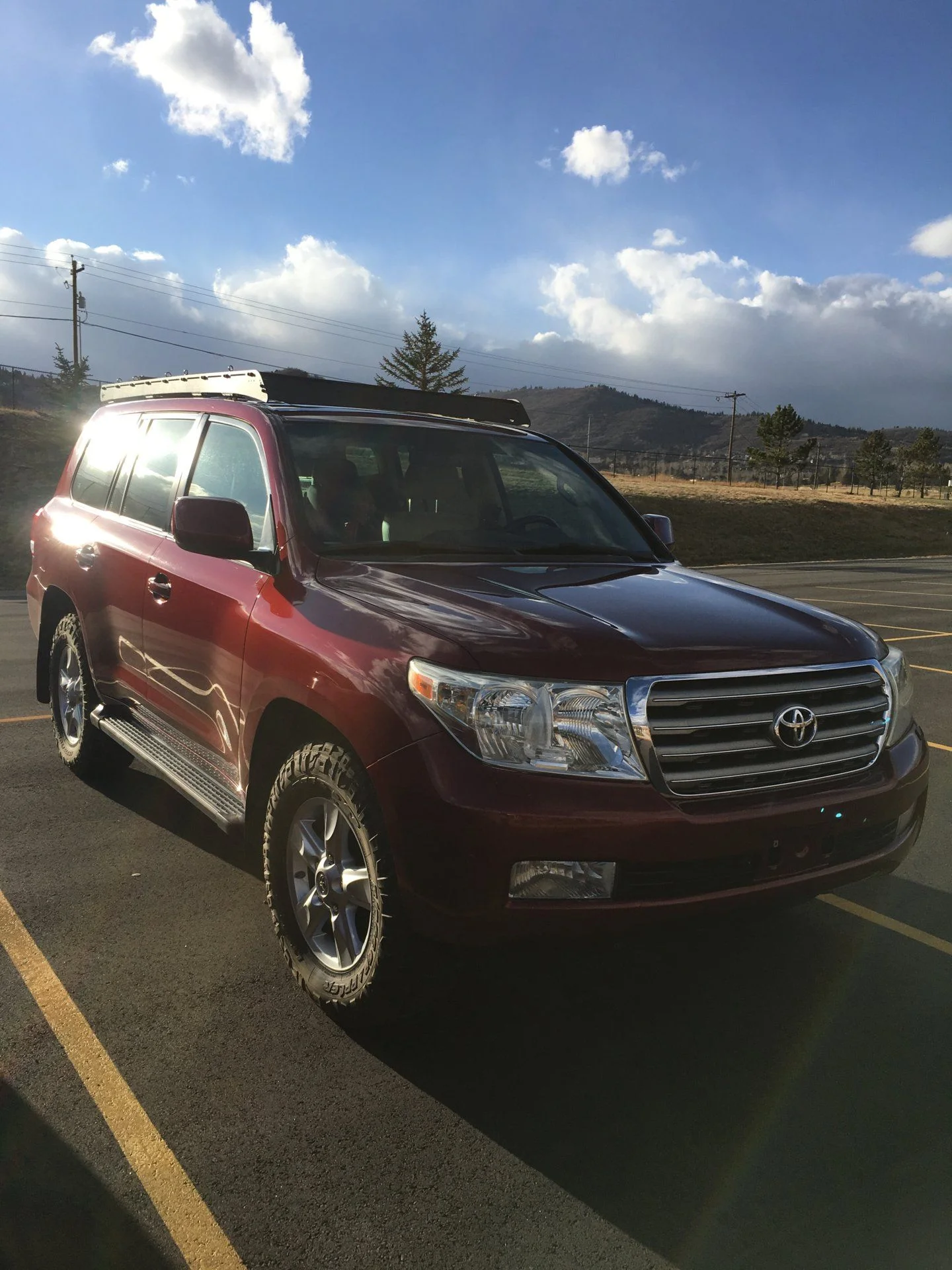

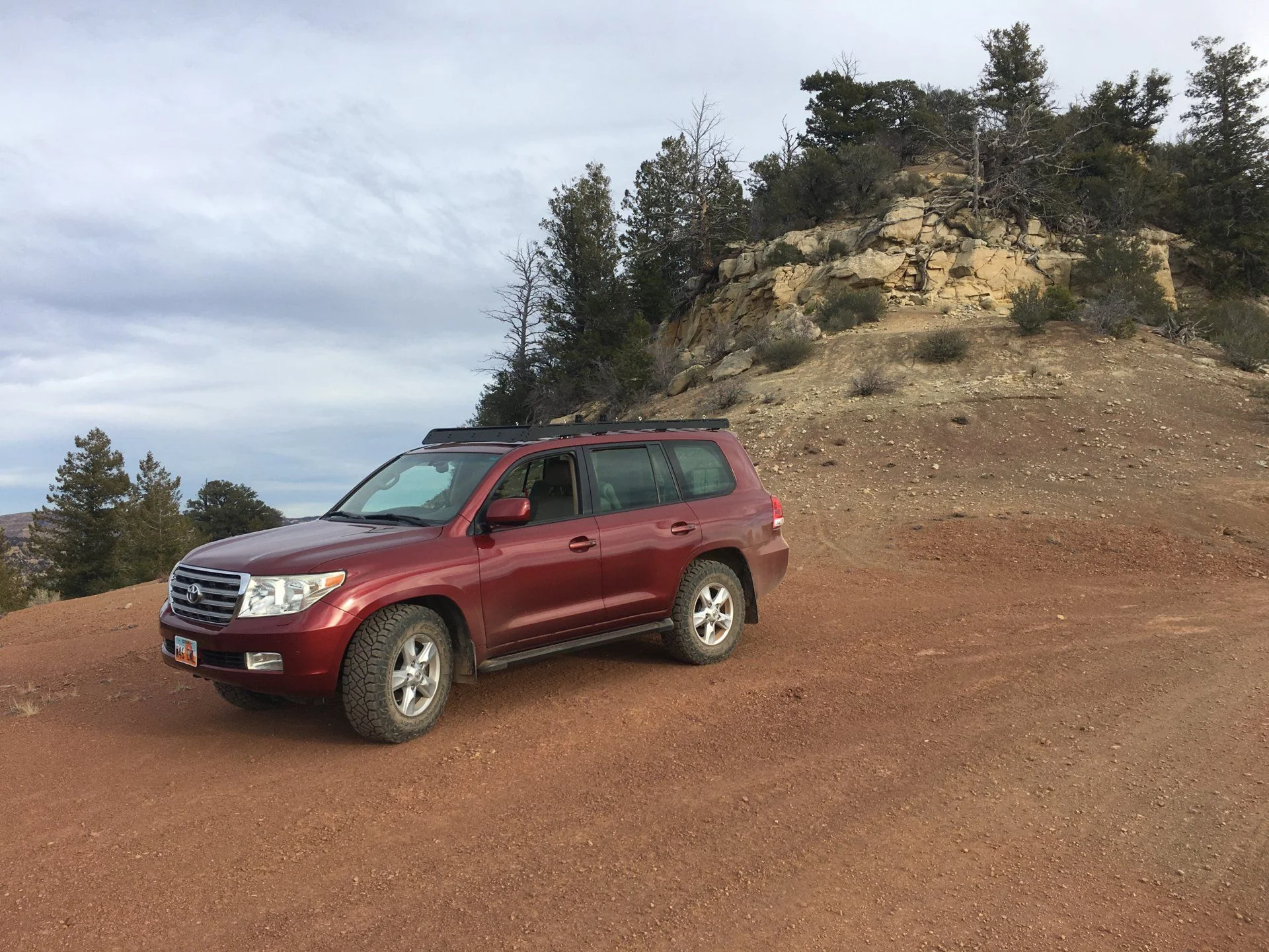

Not the best pictures but maybe they will help.
Not the best pictures but maybe they will help. ]
Looks good! Do you have OEM front coil spacers installed? Also, how are these on the highway (noise & ride)? The speed rating of 99mph vs stock Dunlops concerns me a bit even though I’m usually an “under the limit” driver. Haha
No spacers. Completely stock. I think the noise and ride on the highway are excellent for an aggressive AT tire. A LOT quieter than the Duratrac tires I had on a previous vehicle. The speed limit does not bother me as the cruiser is certainly no sports car and never sees those speeds in my driving.

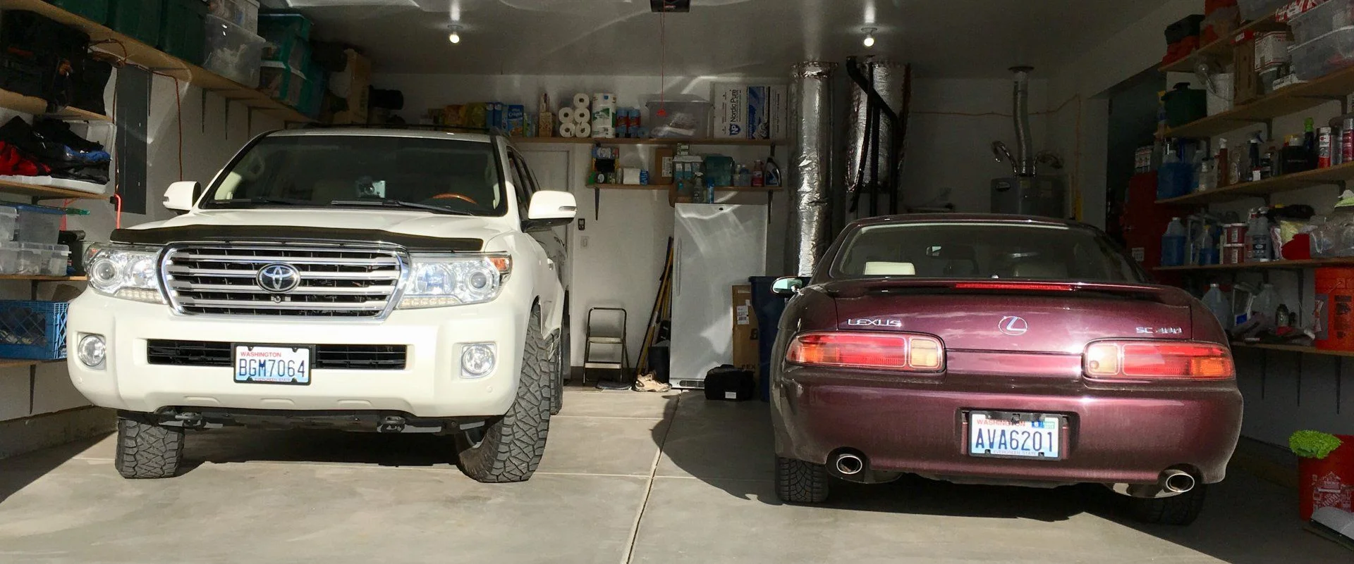

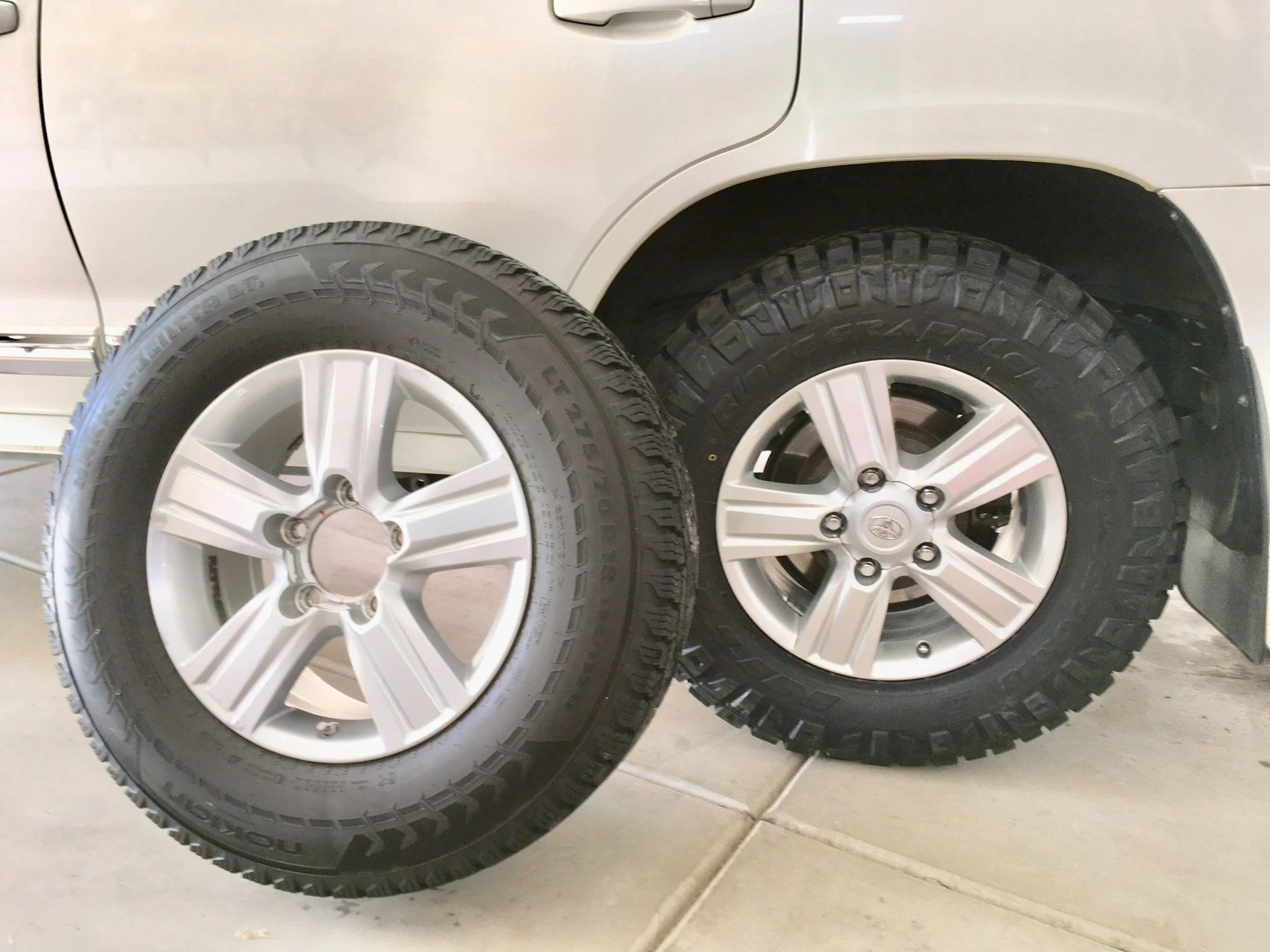

I just mounted a set in 275/70R18 on reman stock 2013 wheels ($170 ea, plus Schrader Easy Sensors $60 ea)
There is plenty of clearance, the tires are half an inch narrower than the Cooper P rated tires that were on the truck when I bought it. I have been running the same 33.2 inch size tires over the winter on my original wheels, and I am now set up where one snow tire will serve as a summer spare and one Nitto will be the winter spare. The OD and tread width of the Ridge Grapplers are identical to the Hakkapellitta LTs, so the speedo is happy (1 mph slow) and I don’t have to worry about a smaller spare or having to keep five snow and five summer tires. I only need four of each.
There is a full index fingers clearance with the mudflap.
I haven’t driven on the Nittos enough to get a feel for them. They are a little loud compared to the snow tires, but it is by far the least obnoxious sounding aggressive tire I have ever owned. I am looking forward to testing them on loose pea gravel. They look like they will grip well and not throw a bunch of rocks.
