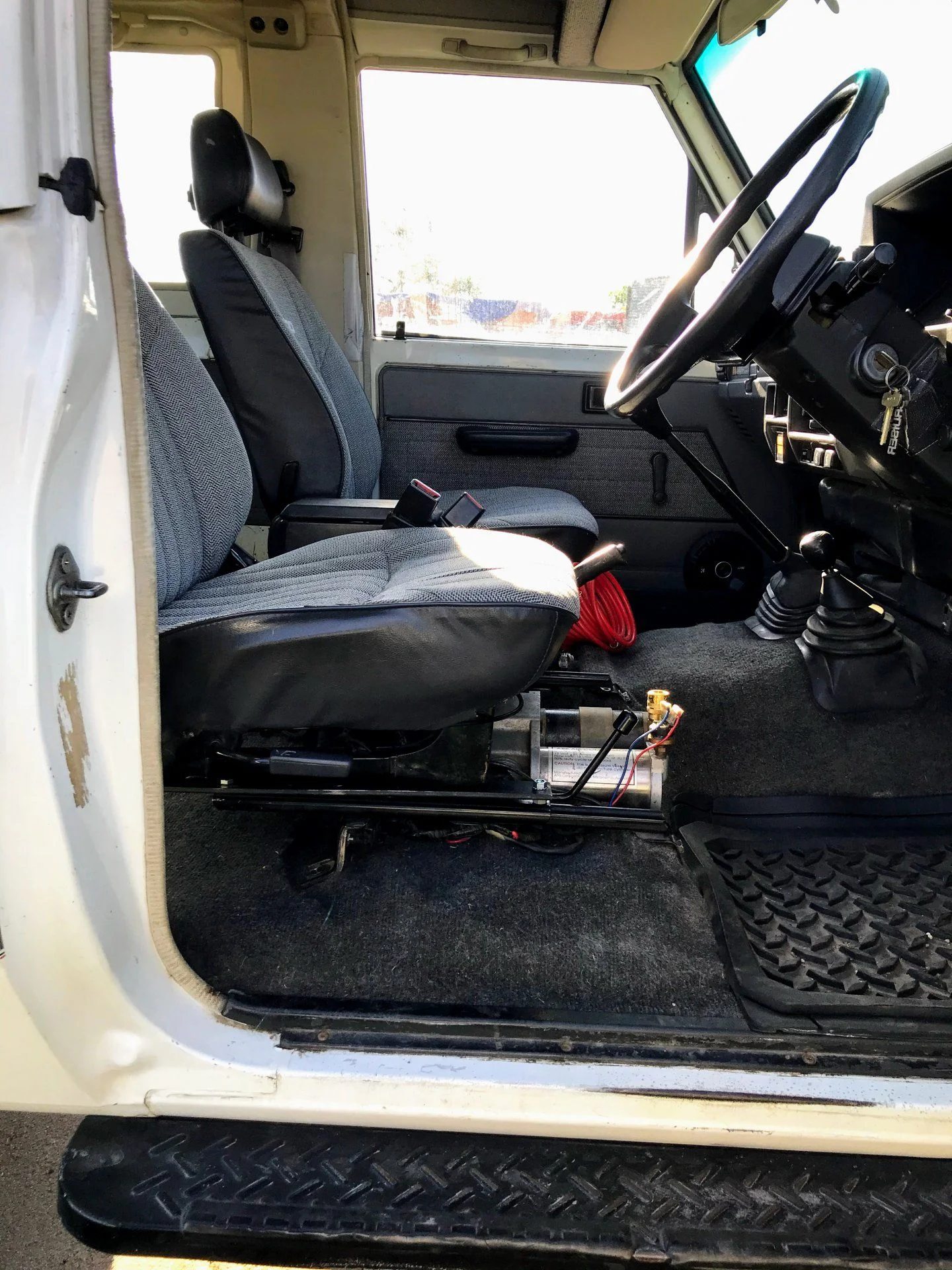

I am not near Allentown, but I am 6'4" and @FJBen is (I believe) 6'4" or 6'5". Head room is not an issue, but your knees will be nearly to the dash and long trips can get tiresome.
You can do a seat mount mod relatively easily to gain a few inches of legroom and it makes a big difference. You can check either of our build threads for more details on the seat mod.

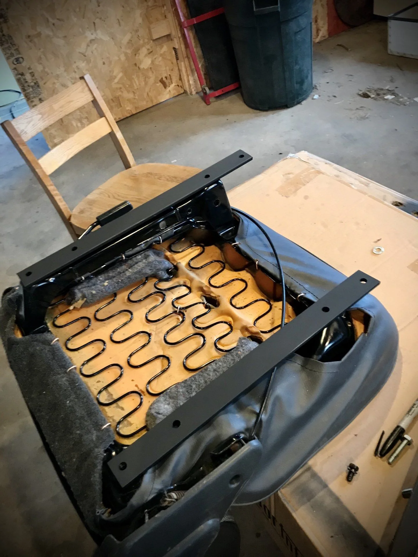

As @Rigster said I’m 6’5” plus and and daily an 88 BJ74. I ended up modifying my seat brackets for 3” more legroom. Super easy and makes a huge difference.
Thick flat stock. Match the holes
