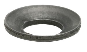

I bought OEM LC shocks to swap out my LX with AHC. The shocks only came with the rubber bushings and nuts, no metal retainers.
Every part diagram that I've looked at says that the metal retainers come with the shock, but I was told that they don't?
Anyways, I'm hoping some of you that have swapped out your stock stuff to lifted parts may have your stock retainers laying around??? If anyone could help out, that would be great.

couldn't you just use some conical washers? something like this:
seems like they would work just fine in this application. i also don't see how a standard washer wouldn't work either.

As stated above, how about using some HD standard washers? Issues?
Find some used ones. Its not a wear part [provided they are not too rusty]. Wire wheel cleans them up nicely.

They have a lip that engages in the shock mount hole. Would imagine positioning issues, bushing noise, and wear would result from regular washers, just my 2 cents...

^ THIS! Get the proper parts.
