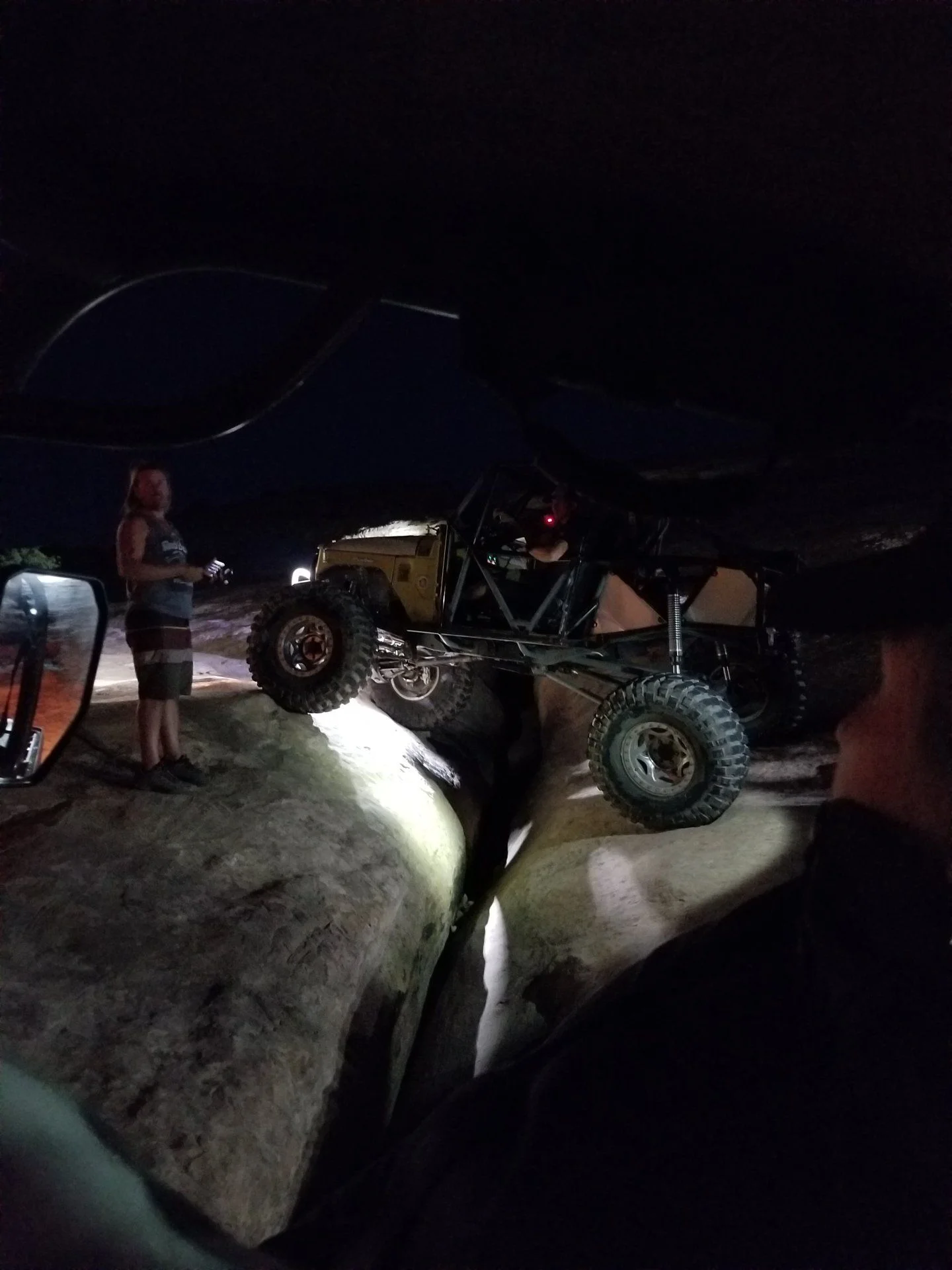

There's a linked 40 at GSMTR every year that has the struts in boarded in the back tub. Very capable. I'll try and dog out some pics tonight.
Here's two shots of "Sid's" 40 - I know there's a vid of him on YouTube as well.

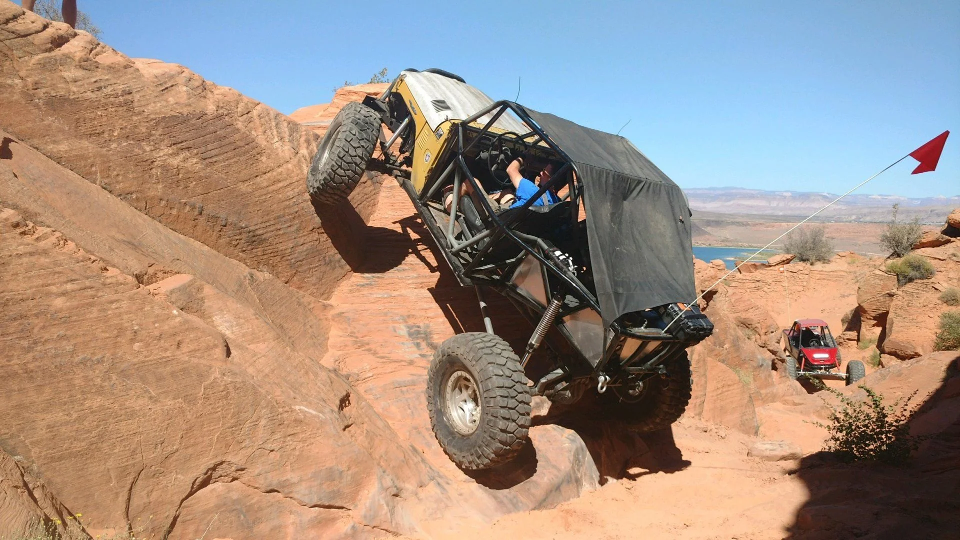

Two more shots of mine - lot if flex and super stable on side hills.
