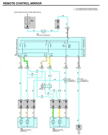

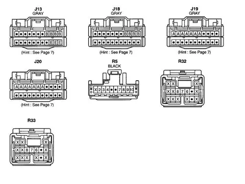

Could someone post or email me the wiring diagram for (1998) the power mirrors.
I would like close up photo of the wires going into the connector that plugs into the power mirror switch?
How's this?
Thanks. Is this the only info for the 1998. I have more (10) wires on the connector to the switch.
Toyota had to make this complicated.
The drivers side mirror only pans in and down. The passenger mirror only pans out and down.
