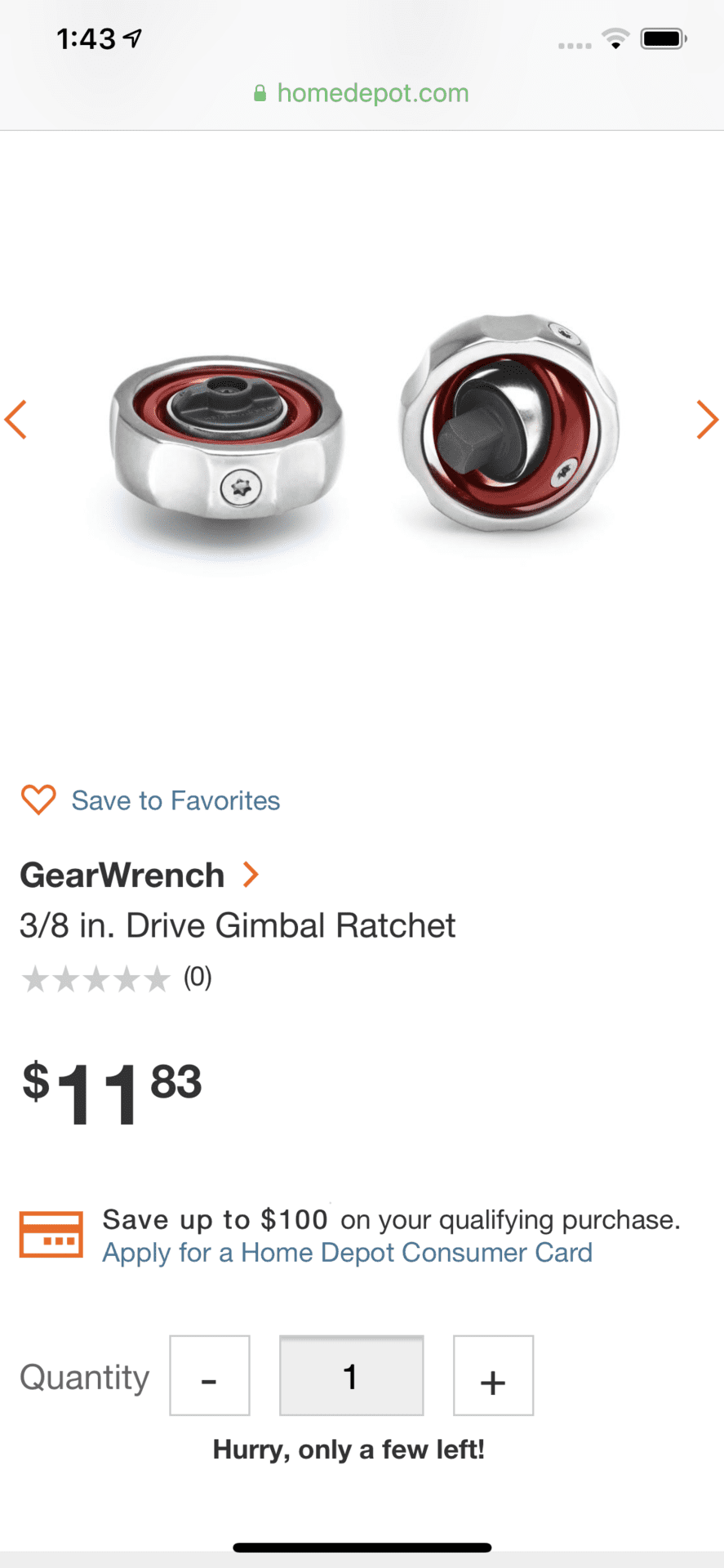

I used a hand gimbal ratchet. Can’t remember how I red neck engineered attaching the hole saw to the socket extension, but it wasn’t that difficult with the tools I had laying around. I know it did involve a little duct tape too haha.
