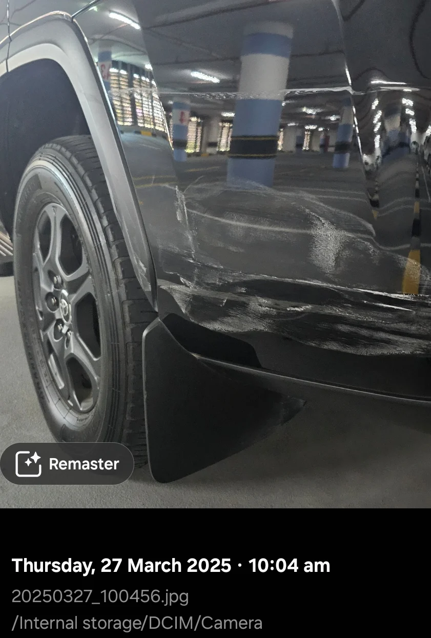

It's really crazy that in less than 24 hours of writing this comment, someone rammed into my GR while trying to park... Thankfully, the PPF took the full damage and protected the car which now makes me more biased when i say PPF all the way!
