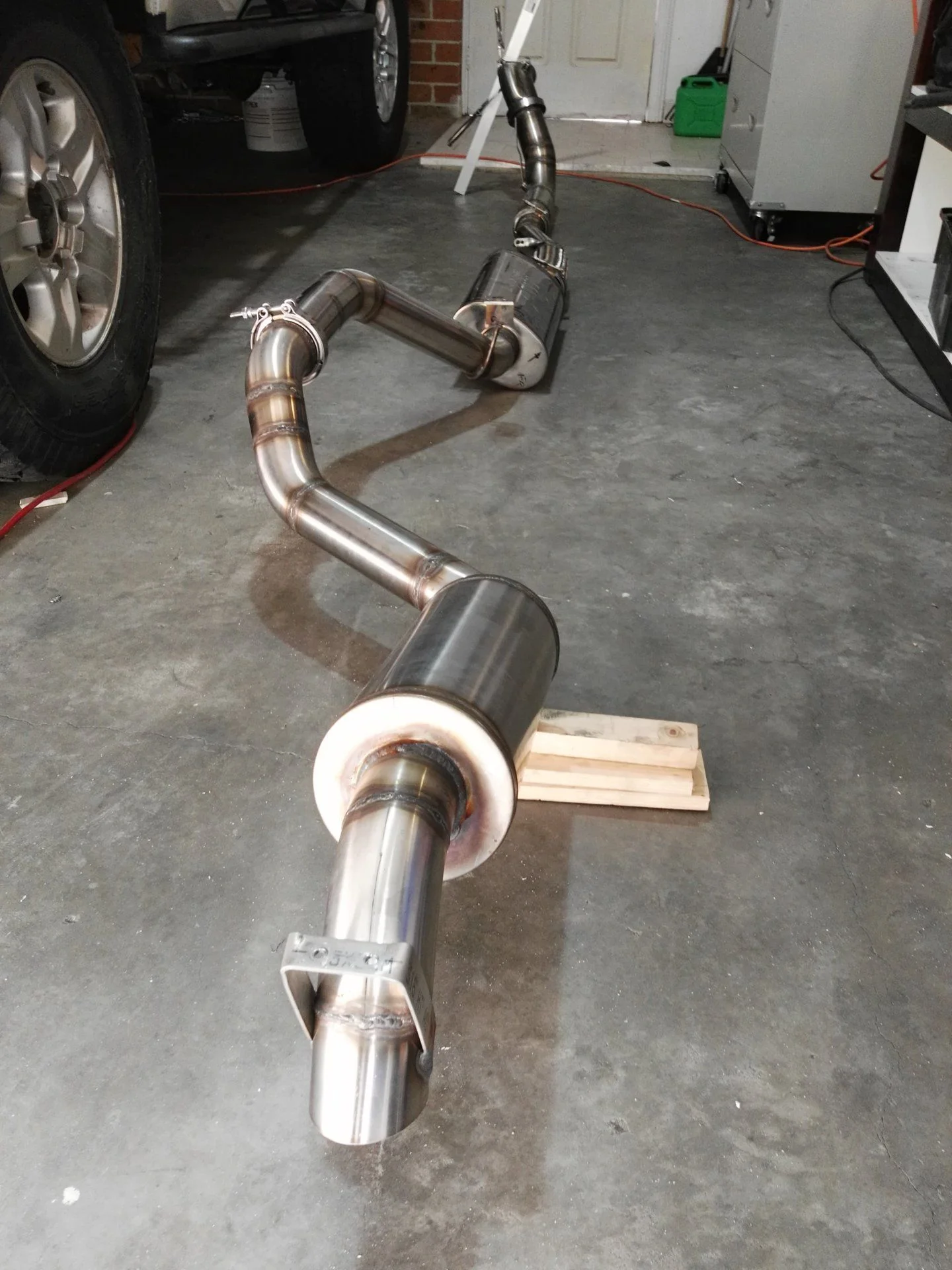

I want to keep this truck "forever" and I don't want to have to build new exhausts every 6 years, so I ordered a 304 stainless one from eBay all mandrel bent, bolt on for the 1HD-T 80. It came with a round muffler included. The turbo spool-up whistle is louder, which is cool, but it drones very loudly at all highway speeds 90+ km/h.
Installing the stainless, I got the feeling it is stiffer and harder than regular steel, and I was thinking this might contribute to louder resonance. Chatting with an experienced exhaust guy, he confirmed this is correct. Therefore, cutting out the eBay muffler and welding in my old Japanese muffler in its place would not necessarily eliminate the drone. He suggested looking for the biggest baffled muffler that I can make fit, and suggested I look at Flowmaster. I am not particularly worried if adding some baffles causes me to lose a couple HP. But now I see Flowmaster only sells aluminized steel mufflers, which kind of defeats the original purpose of going stainless. But maybe I get 10-15 years out of the muffler itself and can keep the rest, which might not be a terrible option.
Does anybody out there have a 3" stainless system on a 1HD-T 80 that does not drone? If so, can you let me know what style/size/location the muffler is? I want to minimize the guessing
