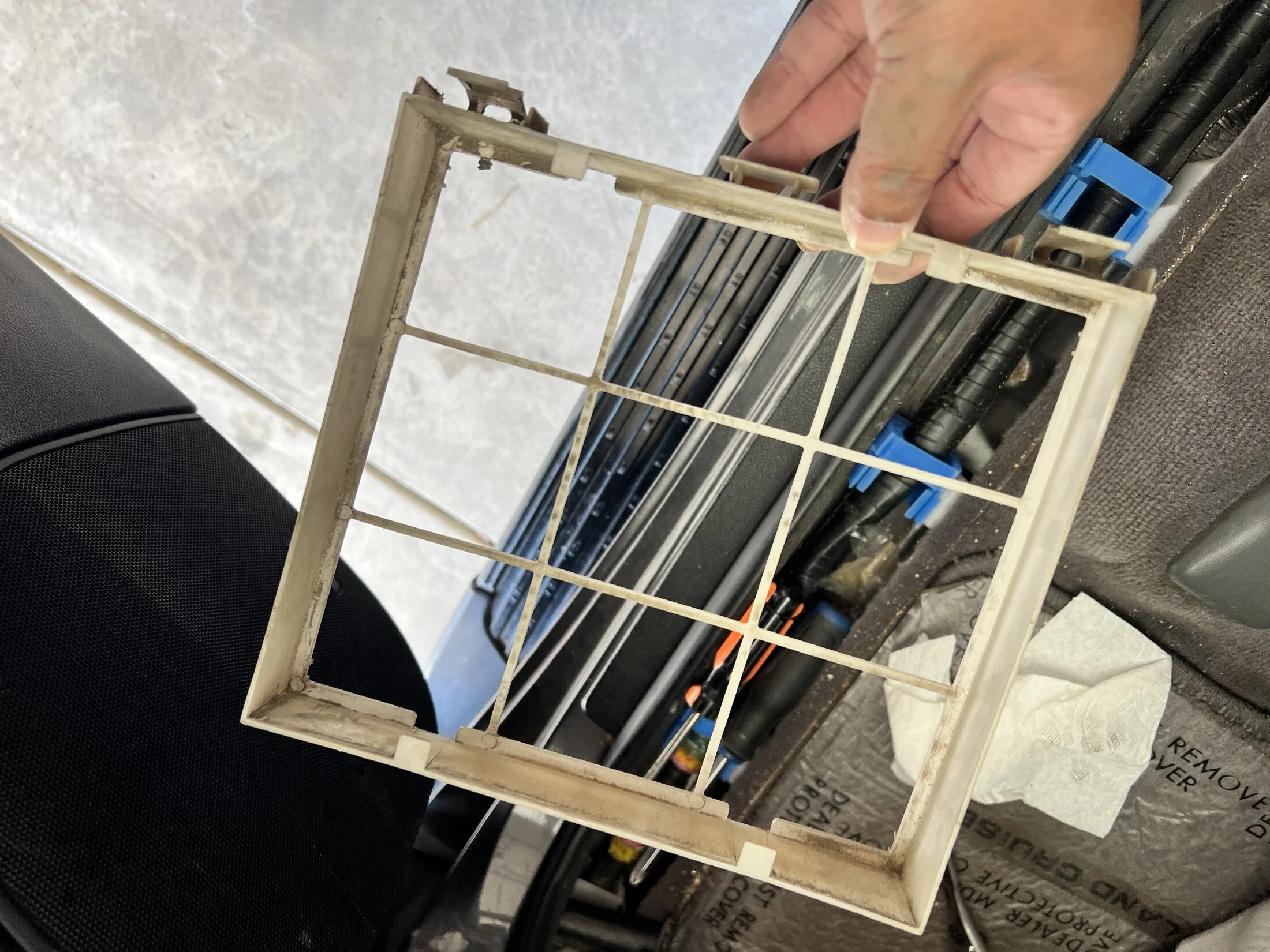

so my recirc on my 2008 doesnt work
I bought the part from @Oakleyguy to fix it
i toook glove box apart today and my arms and all are ok
but the plastic tray filter sits on is broken and it prevents the accordian thing to close
1) is the platic tray toyota dealer only?
2) if I put the glove box al back together can i still get access to the plastic tray or do i need to leave it all open till i get a new tray?
There isn’t any stress on the tray. Would tape and glue make it functional?
let me see if i can glue it back
would be nice to get some fresh air in the car after a year
so when accordian is open = fresh air
accordion closed = recirc?
Mine was in similar condition and I ordered a new one from the dealer, $14.00 bucks or so.
Filter blocked by the door means fresh air. Filter visible is recirc
This looks still like something you can easily glue with ca glue or epoxy if you want to give it a try.

plastic "welder" for the win!
