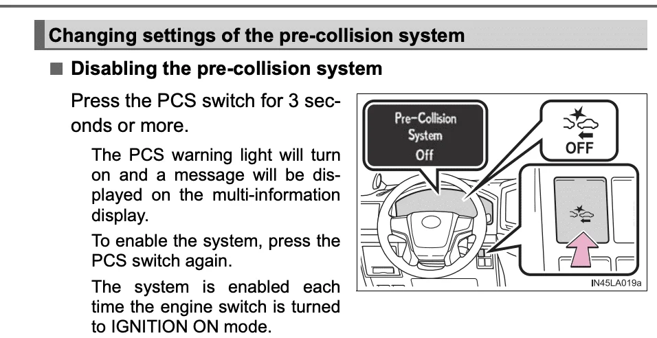

I spent 57 minutes online with ToyotaCare help desk, and there is no documented way to disable PCS in the 2013 land cruiser - not in manuals, not in tech tips, not in service bulletins, not in campaigns.
Note: There is an easy way to disable PCS on the '16+ land cruisers. They added a button.
The Toyota help desk guy said his understanding was that they added the button because they got a lot of complaints about not being able to turn PCS off during the many pages of situations they warn about in the manual.
The help desk guy said he was shocked that there isn't an easy way to turn PCS off...
He shared an anecdote where he had a customer that had his brakes keep on activating in a parking garage because of PCS!! Luckily he had a newer model and could easily disable PCS.
Note: for the '16+ there is also a Techstream setting to make it remember the setting it was on, so you don't need to turn it off again upon restart.
Screen capture from a 2018 manual:
