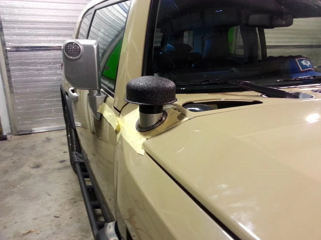

I'm looking for the same thing. I thought I saw a custom made tube and filter routed up to the windshield cowl. Not sure if it was for my vehicle but I'm almost positive i saw it here on ih8tmud. Looks more than doable on my GX470.
You could work up something like this option for the FJ cruiser.
