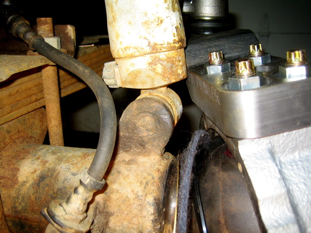

Installing Marlin Crawler Hy Steer on my '76 FJ55 because the welded double arm that was on there was breaking knuckle studs - it was creating all sorts of weird torque stress and was about to break itself. Also upgraded to FJ60 knuckles, the new fancy studs with the Torx heads, and 4Runner calipers. Probably do an FJ80 master cylinder to keep up with those calipers too.
I'll be checking the torque on these almost every time I drive it for a while....
Here's a pic of the new steering arm impacting the shock. :doh: I cut off and rewelded the shock mounts about 1" more inboard last night. No after pic 'cause I'm embarassed to show anyone my ugly welds. I think they are strong, though. I beat on one with a big hammer for a while and it didn't budge.
