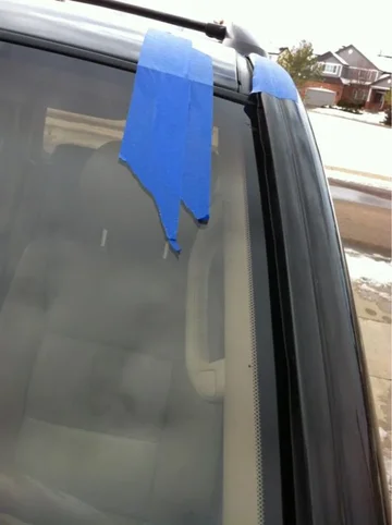

I knew the windshield did not look like the previous installer took pride in his/her work, but sheesh.
Safelite comes out today and tells me they will not do the job, due to liability (we all know about the leaking down into the computer issues), he said the last one they did cost them $7K in dual computer replacement.
The issue: prior installer did not bother with the Rivit kit and used screws for the holes. This enlarges the holes and the new Rivit kit will not seal.
Only solution per Safelite: Body shop to fill the holes and re-drill per FSM specs. Then the Rivit kit can be re-introduced to my cruiser.
The Curse of the Black Pearl Continues... will post up results.:meh:

I am going to try a local Autobody shop w/ Glass company combo, well see what they say. The Screw is double that of the skinny rivet, so no going back to Rivet at this point, unless all holes are filled.
What I don't get, is why they can screw into the roof for the rack and use silicone with large screws, but not the windshiled? Safelite installer left a Rivet my dash pocket, it has a plastic cover on it - I still think a healthy dose of Silicon would seal it. I have owned it for 4+ years without a leak.
FYI, if anyone is curious about your current situation, you can pull the small plastic cover up from the bottom of the Side of the windshield and see if there are rivets or screws.
