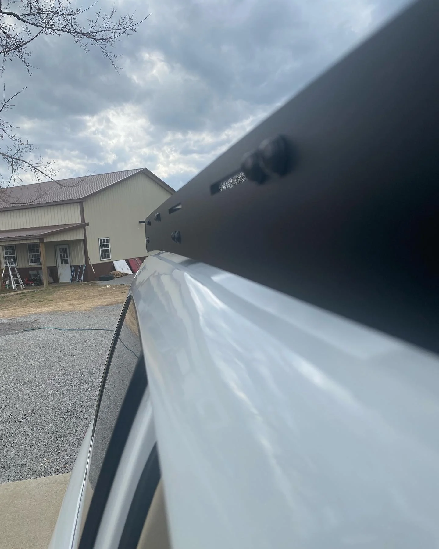

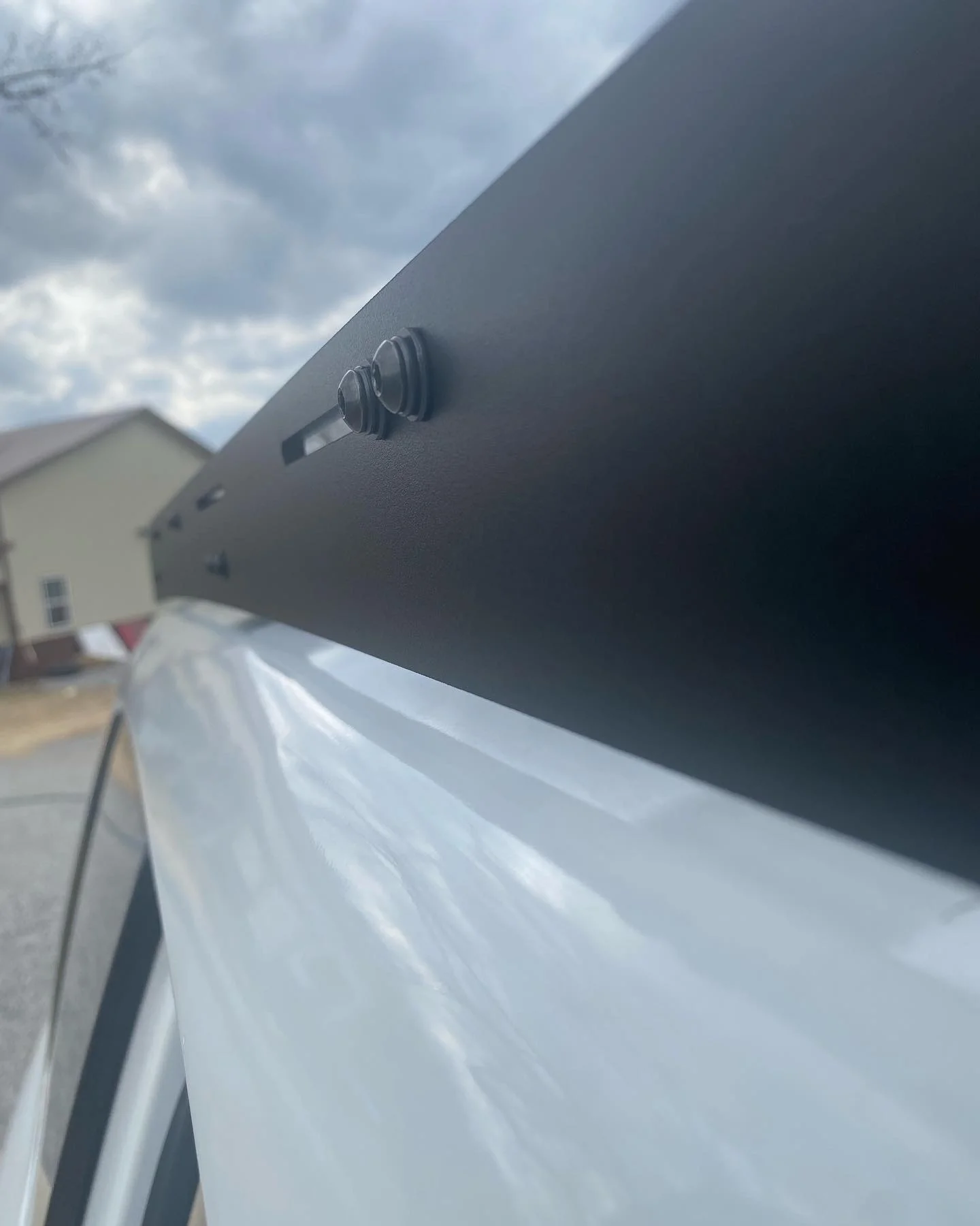

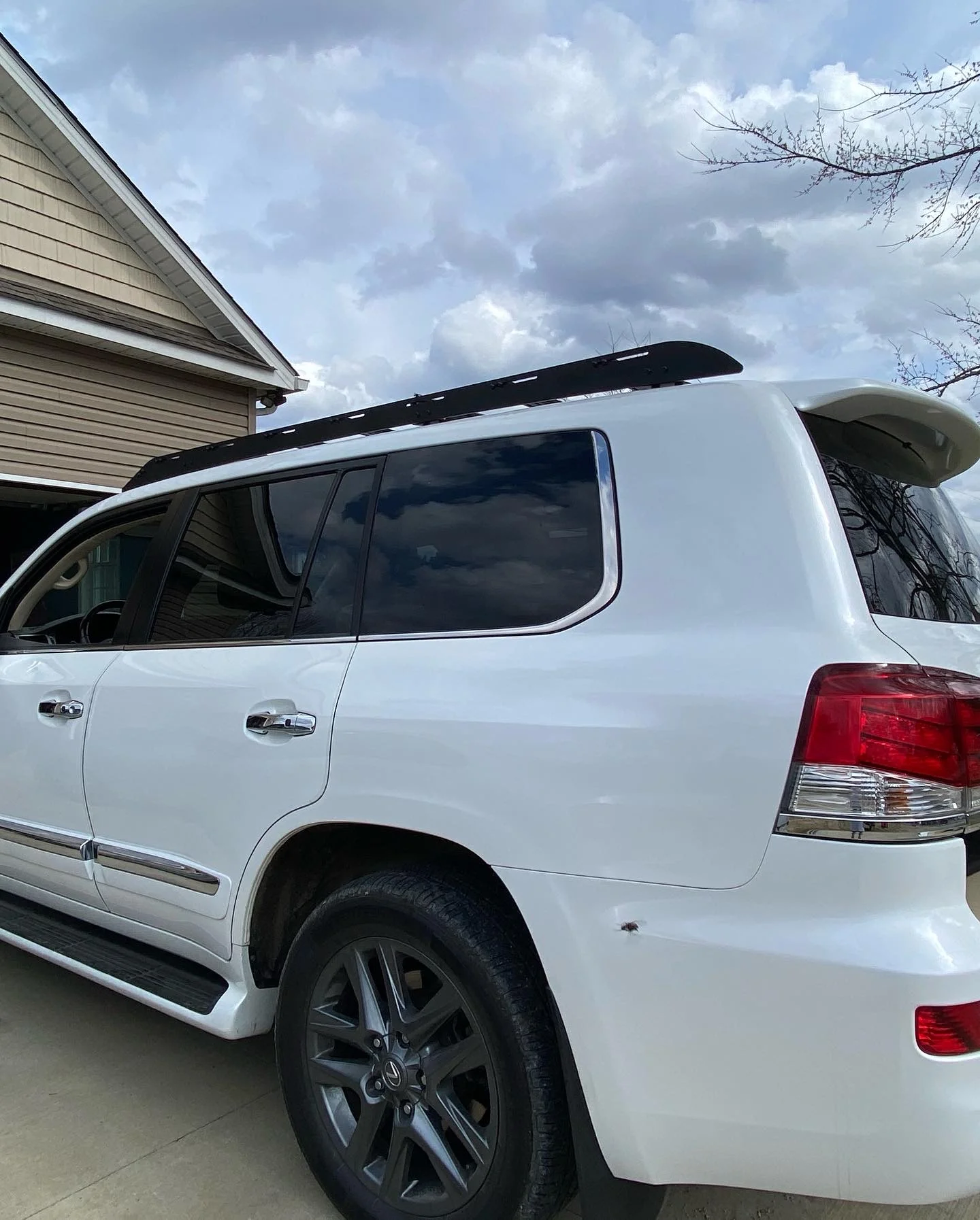

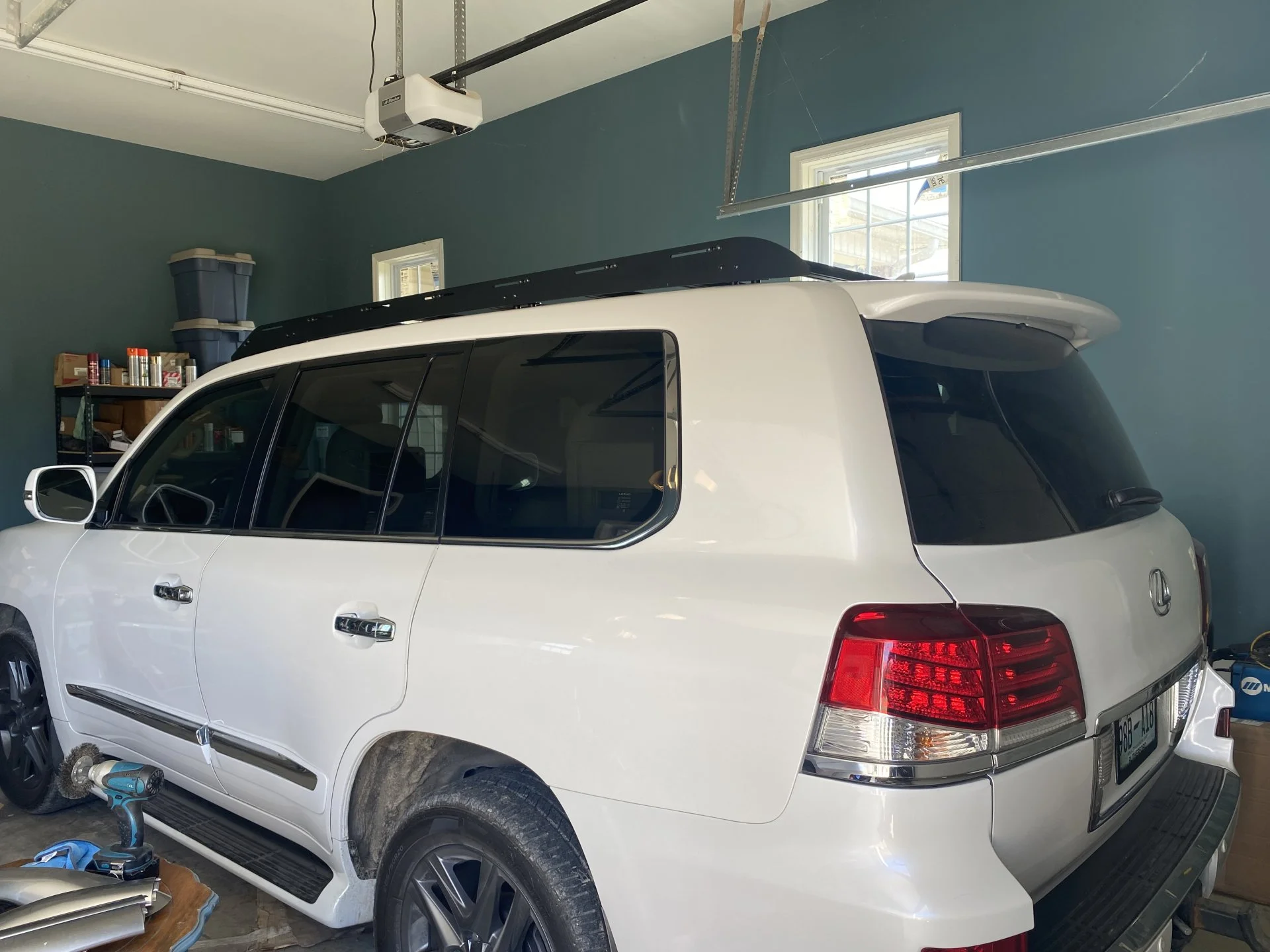

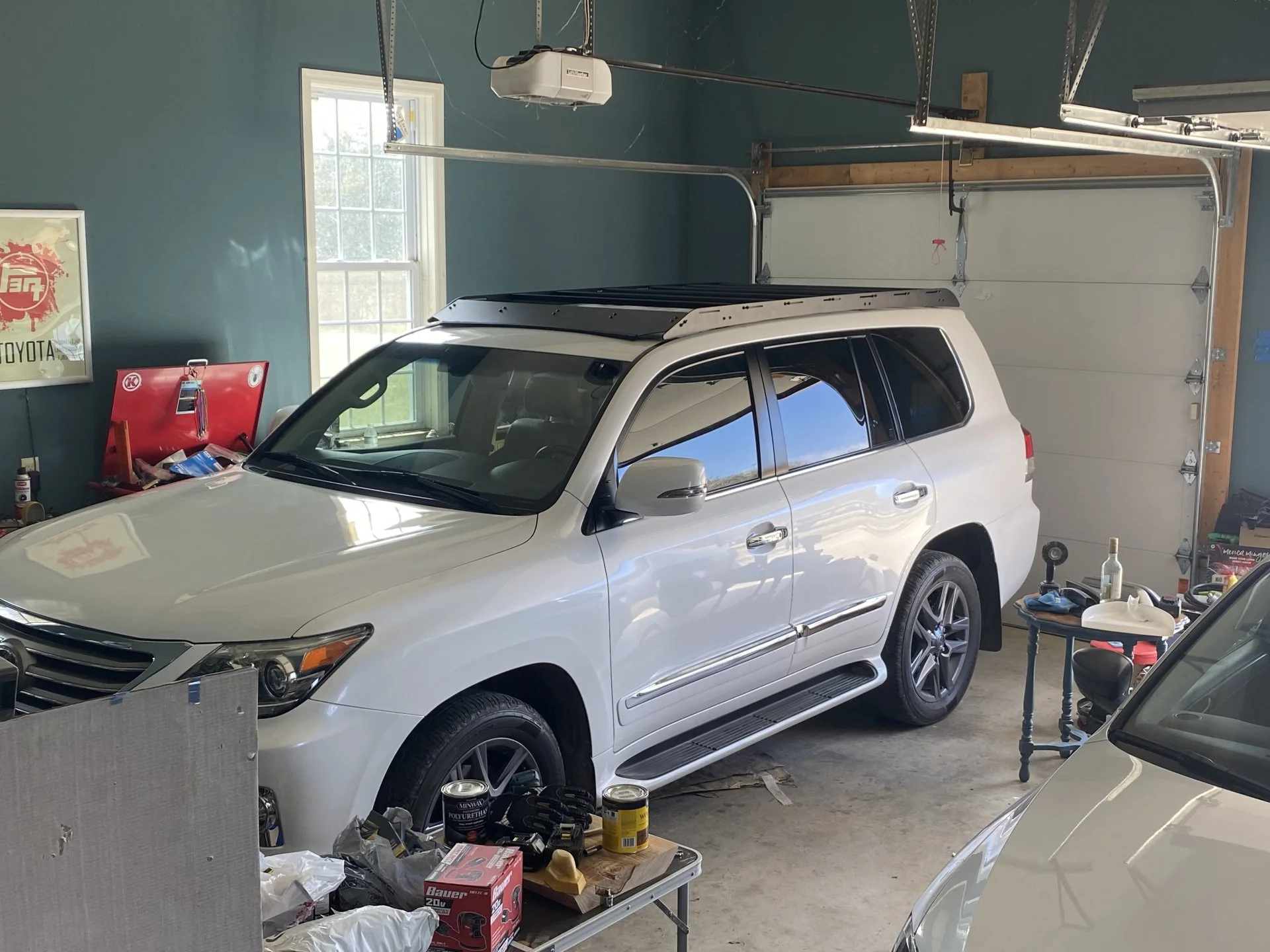

Finally able to get the ProSpeed rack on my 14 570 last weekend. Drove on a short trip about 3 hours minimal additional wind noise. Super low profile, looks great. Highly recommended. Install was easy and straight forward. 16 and up requires dropping the headliner though, however that will be the case with any rack for those model years.

I don’t know about car washes. It uses the front mounts and back two. I choose this one for its low profile, light weight and looks.

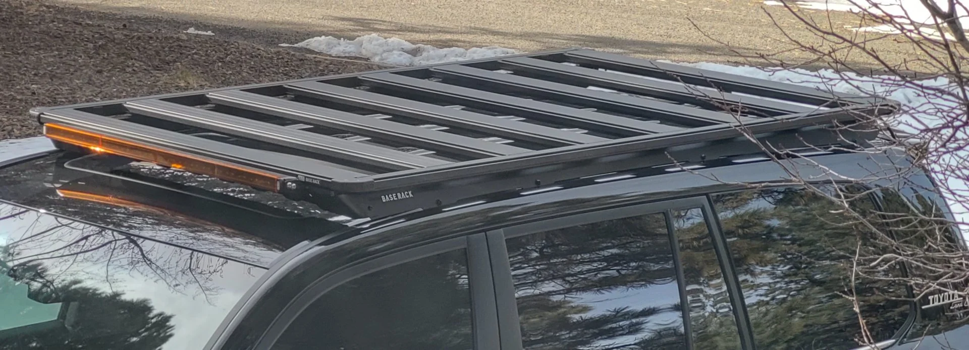

I installed the 51"x84 ARB BASERACK (#8 on chart) on my 2020 HE. It utilizes the four mounting points on each side. No cut out for sunroof, so the entire 84" can be utilized. By this ARB site chart: https://www.arb.com.au/roof-racks-carriers/roof-racks/baserack/sizes-guardrails/#:~:text=This means you can be,of load across three beams.
the carrying weight is 410lbs. The rack weighs 50.2 lbs.
Looks great how’s the noise, I ordered the same last week, here in Oz the wind deflector is now part of kit after many customers had been disappointed by the noise generated by the cross bars.
Without the light bar it was almost as quiet as a stock rack with the air deflector. I noticed after I put the Slimline light bar ( mounted in front of the air deflector) on the noise level increase just a little. Since I never use a sunroof I opted for the 84 inch long model and glad I did.
