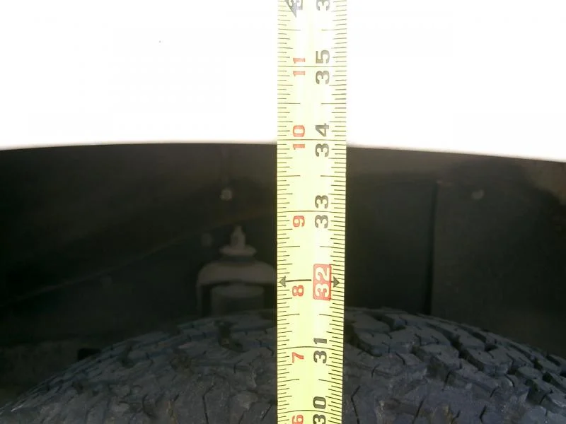

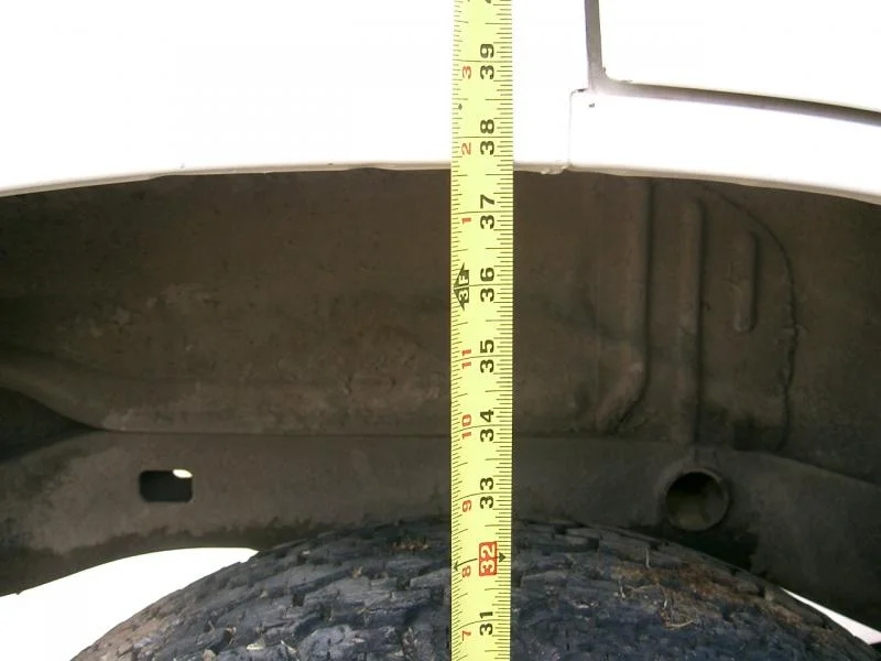

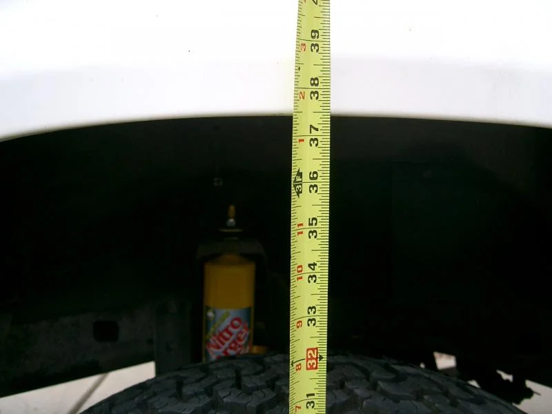

Can you take some wheel well measurements? curious to see what an ome with lift shackles and no shackle reversal will yield for lift and ride.
Dave
Wheel well dimensions.
here's the pass. front before and after.
and here's the pass. rear before and after.
Ride height looks like mine! I'm not all that excited about the stinkbug look, but I'l give it some time and see how it responds to my normal camping load b4 messing with it. Now to get the shock mounts done so that I can drive it!
