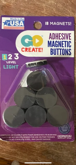

It was a broken pad. I have some on order, but I used this $2 fix (Found in WM arts & crafts section) until the parts get here. Works great and only 30 seconds to install.
