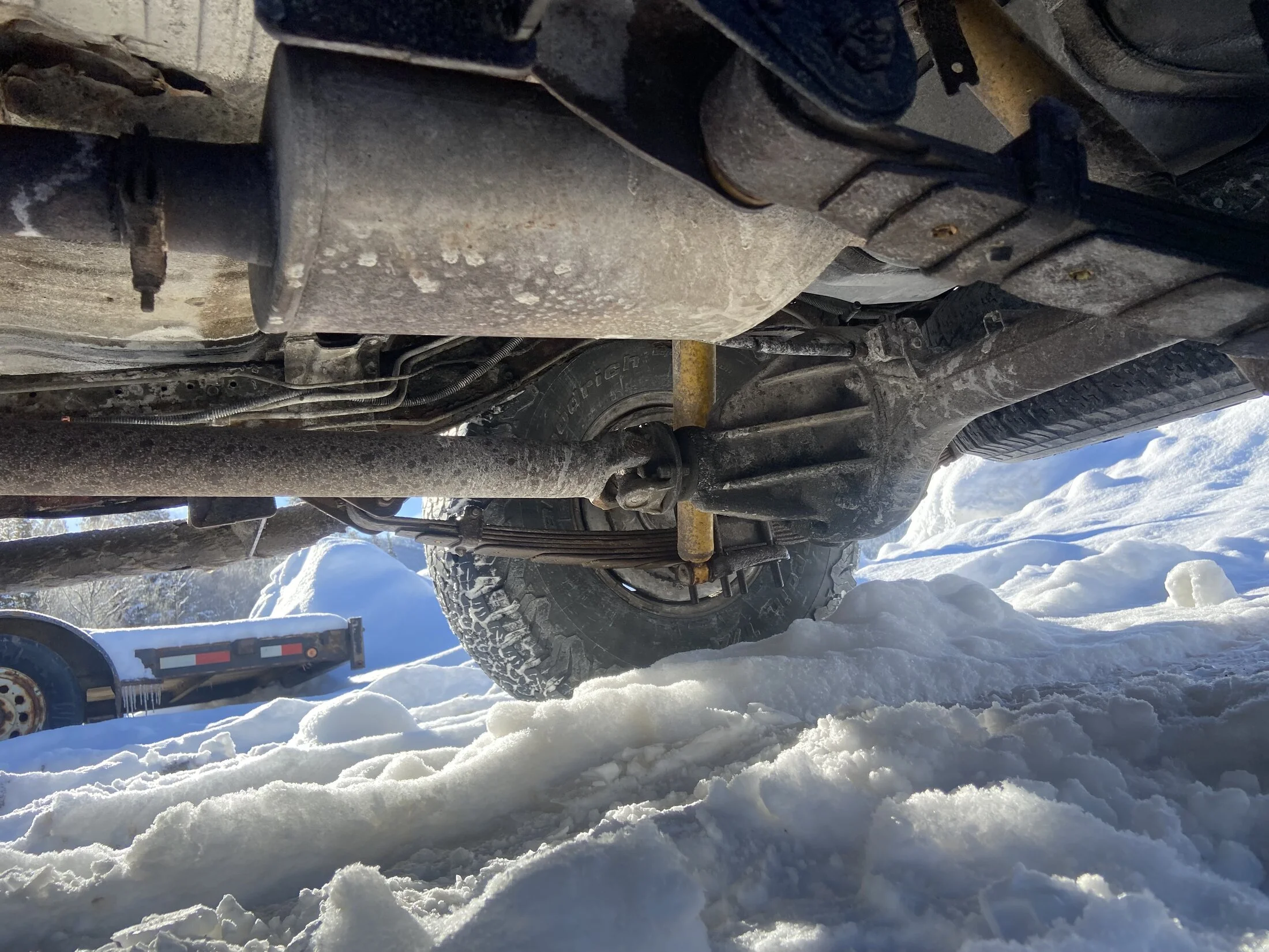

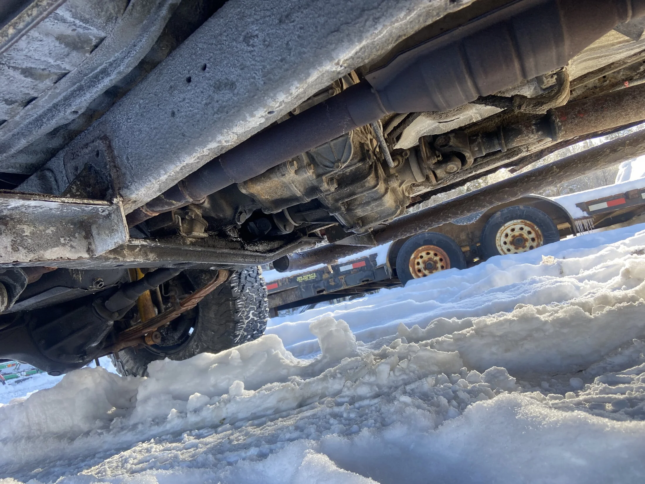

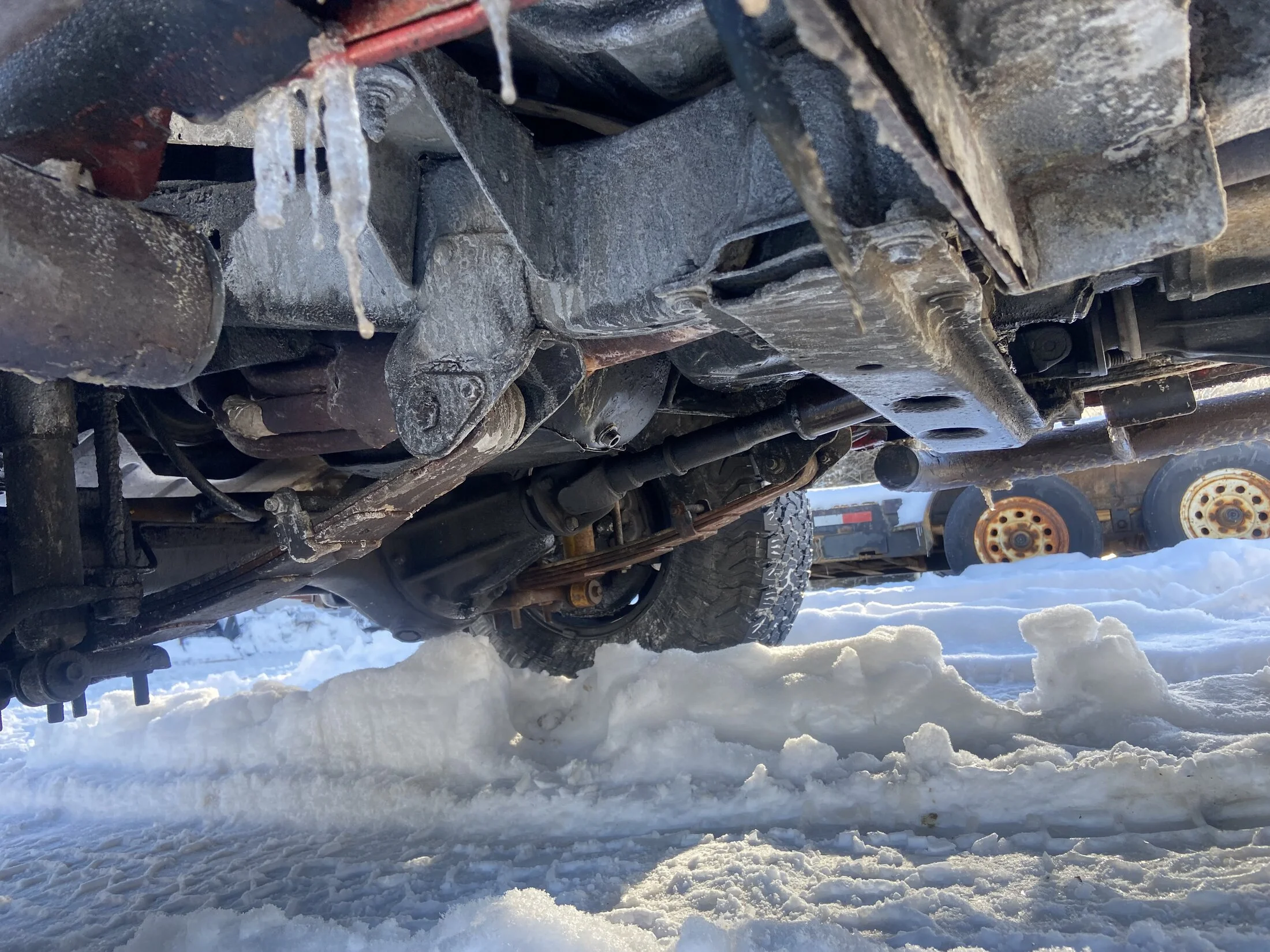

From the pics, undercarriage and frame look pretty decent.
