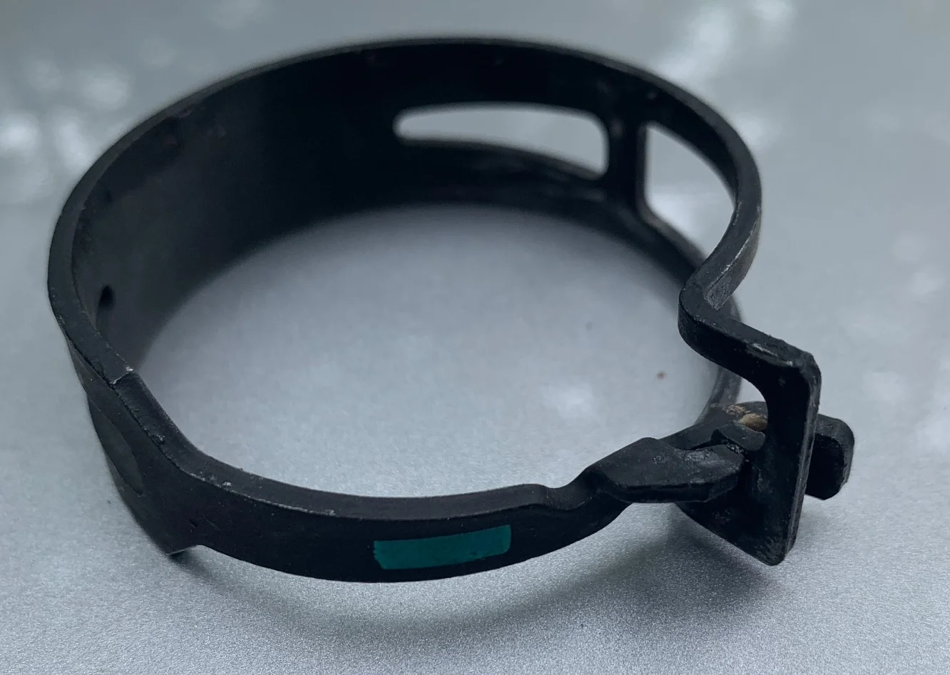

I found the problem. My mechanic didn't CLOSE the clamp.
Please see pictures. This is the condition of the clamp when the hose came disconnected.
By using pliers, I see that the mechanism snaps closed (if you use pliers to activate the closing mechanism -- which he didn't).
I'm calling my mechanic now.
Does anyone know if this is indeed the correct Toyota part? The parts schematic I'm looking at calls for p/n 96136-54801.
Grumvee
THat makes sense. That looks factory, and p/n 96136-54801 seems correct according to camelbacks site.
