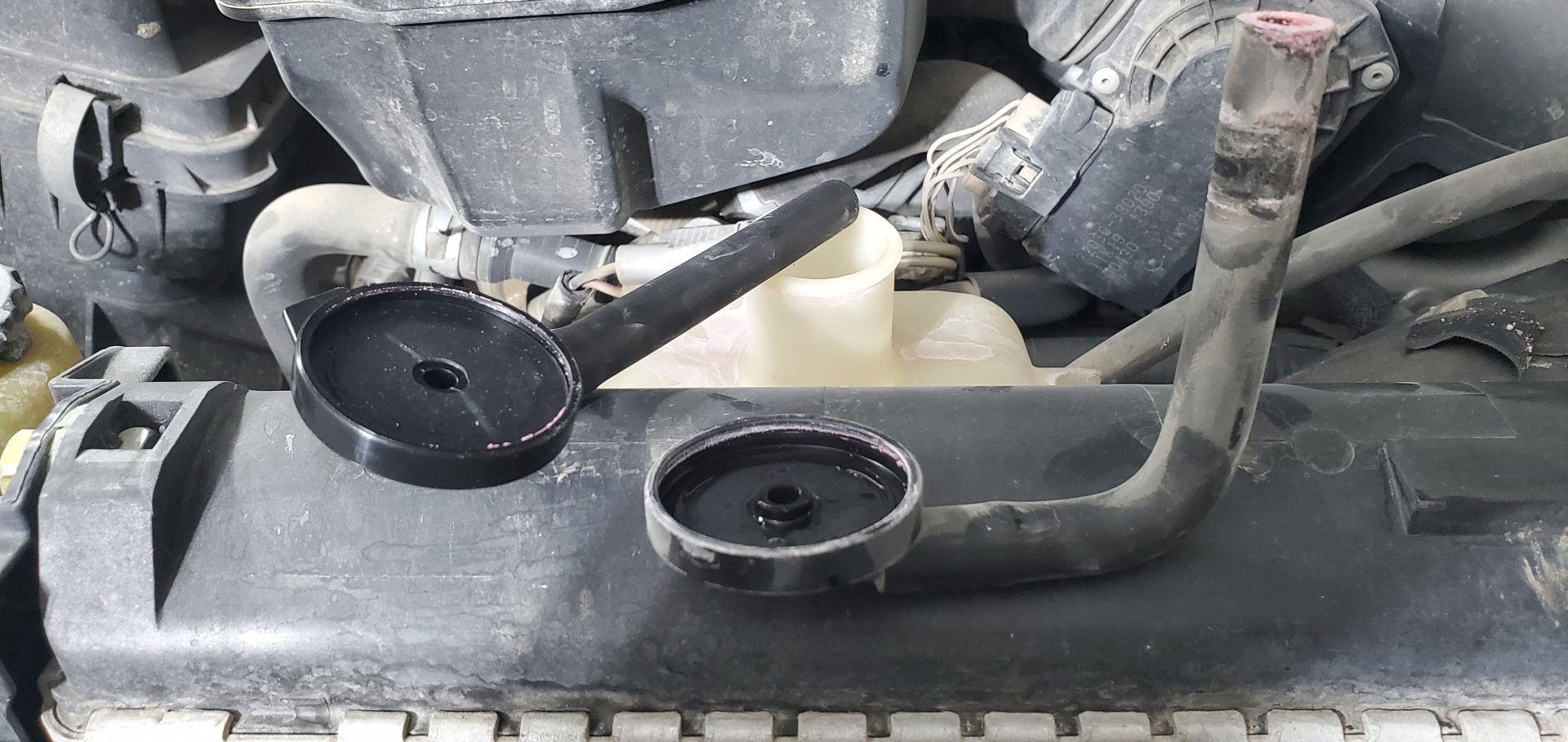

Check to make sure your reservoir cap has a gasket installed. Mine was missing.
New cap with gasket on the left.

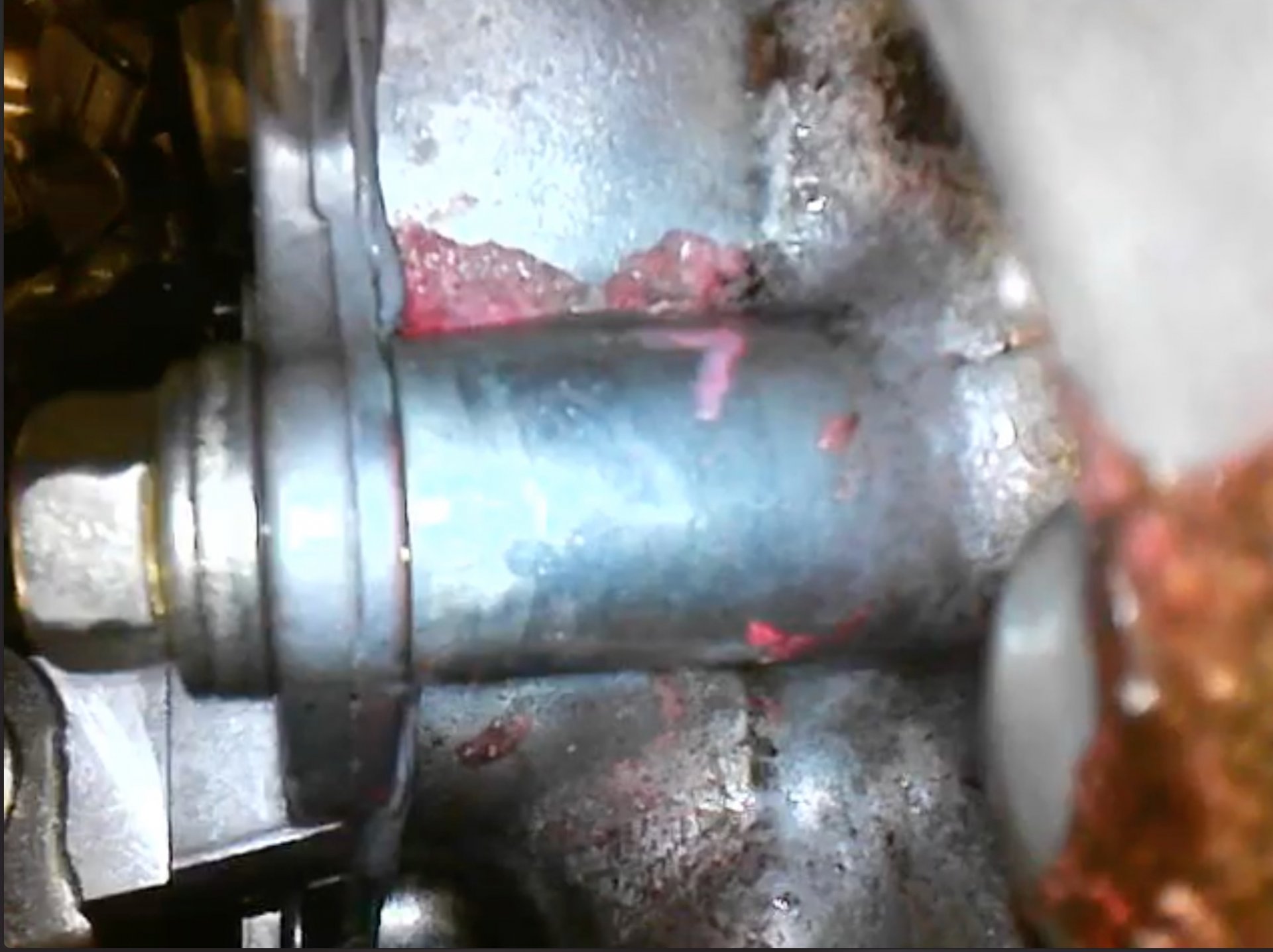

<Drum roll.....>
Valley plate leak.
I didn't want to believe those who were predicting that, but you were definitely correct.
Pictures attached.
To repair, my mechanic will use the OEM coolant silicon (hat tip to @bloc for telling me to confirm that), and will replace the intake manifold gaskets.

Valley plate repair in process.
For those interested, here are some pics from along the way (from my mechanic).

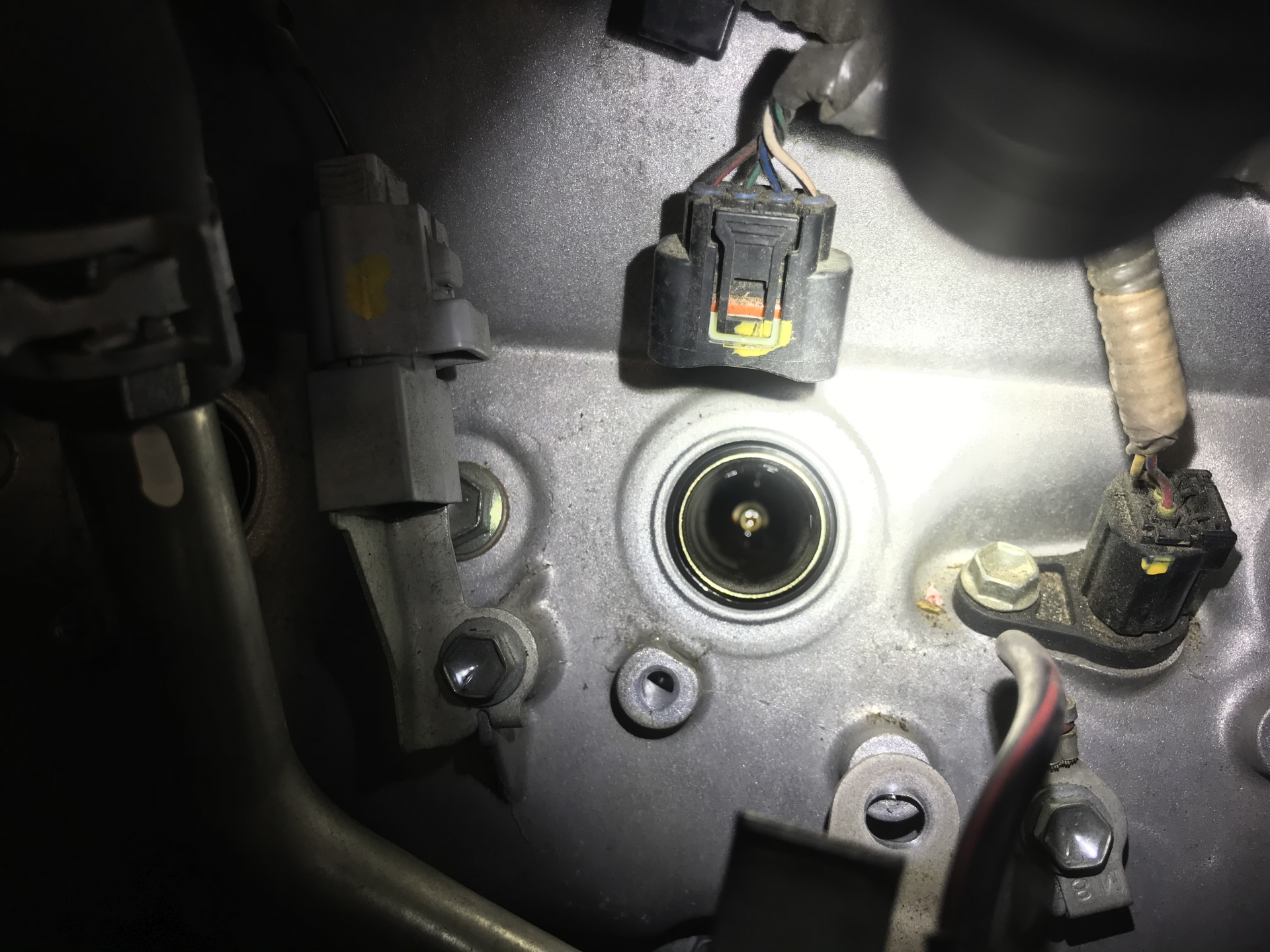

Long story short, I dropped the spark plugs off with the mechanic to have him go ahead and do those now.
He did that today, and found one of the passenger side spark plug holes nearly full of oil. The valve cover seal has failed. Some seepage on the other side, but not nearly as bad. So, I'm another $500 into this already crazy large repair bill for a vehicle that I got to drive for about 50 miles before it headed down this path...
(As a reminder, this is a 2011 LX with 118k miles.)
Thoughts? Is this another known failure point? Or am I just getting unlucky multiple times in a row here?

It’s not unheard of no. 5.7l will be fine. Take a deep breath, remind yourself that the car is 10 years old and seals and stuff will need refreshing. None of this is major work really.
remember you’re in a vehicle you want to know is running top top to get you back home from the boonies, so now you have confidence that the main engine side stuff is sorted for another 10 years.
Finish the fluid maintenance and profit.

Oil can come in from two ways. The top and the bottom. The top has an o ring type seal that gets pushed into the valve cover. Lots of people lead off with that, and concur that is what you replace first. If you still have oil seeping into the spark plug tubes, that is where it gets a little more interesting. The tube cannot be bought outside of in a new block, so don't damage the thing. It is pressed into the block with FIPG. The tube would need to be pulled from the block in a way that won't damage it, then cleaned and pressed back into the block at an exact mm depth. I figured it out on my personal 5.7. Took the risk and it paid off in that I have sealed up my 5.7 to perfection. I've done several other 5.7s as this is pretty common.
The good is that it is not going to hurt anything. It bothers the living crap out of me also, but it will not reduce the service life of your 5.7 even on mile. It an be fixed, but only by someone who truly understands engine work. If you can't find someone close to you, don't risk it. The juice is not worth the squeeze without the right mechanic (not some tech) conducting the work.
Great tech. Have you seen enough to make a rough estimate of what percentage leak from the bottom?
Really hard to quantity that, but I have started full service work (only for 200s) this year. So when I do look down in spark plug tubes of 5.7s that have over 100k, I… I honestly expect to see oil.
If there is ever any slight leak from cam towers or timing chain covers, I bet there will be oil in the tubes. I believe it is because the same process for FIPG was used and we should not be shrouded that if it leaks somewhere, it can leak in another place.
The worst situation I find is the new second owner who is an enthusiast. He buys a 200 from someone “who never beat it off road, just some soccer mom.” That’s not a good thing. The original owners of these trucks don’t give a crap about maintenance. They can’t be bother with it. And running old oil that now had low TBN, make seal hard. Then you have the gaskets that Toyota loves to not ever apply much at all. With seals and gaskets plugging two different ends of the same component, it doesn’t give the best odds for a dry environment to be sustainable.
