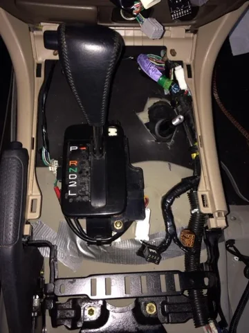

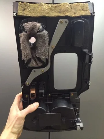

My 100 is in about 100 pieces right now so here are some photos of the center console area and the console itself. You can see the six clip connections in the second photo.
If yours is like my 99, then that rattle you hear is probably something hitting the metal support piece on the underside of the console.
