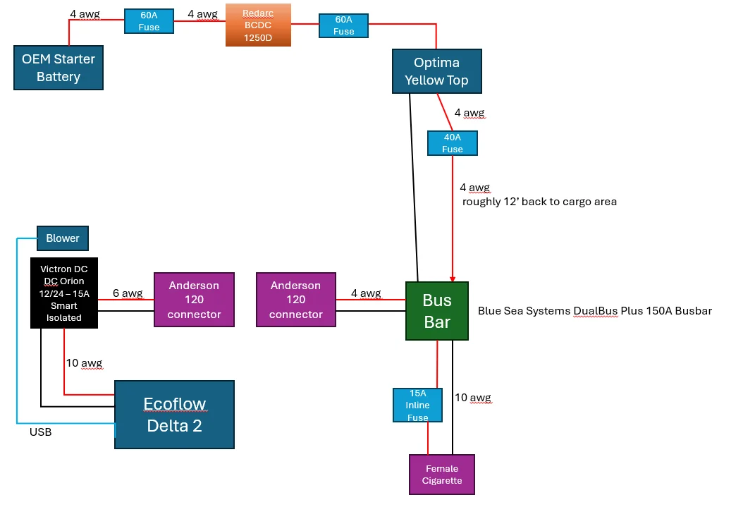

In terms of fusing, what is you SB120 currently fused to? I also have an Ecoflow battery (Delta 2). I have their branded “alternator” charger but haven’t installed it yet. I can’t remember if the XT connector input on the ecoflow is fused?
I have had only great customer service experiences with Powerwerx and likely they could make a custom piece you need.
Good to hear about Powerwerx. I’ve never had a reason to complain about anything I’ve received from them but have never needed to call the for anything off menu. I’ll call them on Tuesday.
As for my setup.
This is the diagram of my current setup:
I didn’t put it in the diagram but I also have a female cigarette plug coming off of that bus bar. When I’m in no rush to charge my ecoflow (like I have a full day of driving), I use the normal ecoflow car charger with the male cigarette end to charge the ecoflow.
Does that answer your question?
Now that the ecoflow branded car charger has been lowered to a sane price, I contemplate getting one, but I’m not there just yet.
I’m not sure where I would mount it.

So, you want to get rid of / bypass your Victron?

And now your question of replacing the victron gives me pause. I wouldn’t mind replacing the victron with the ecoflow device. But your question makes me wonder why I want this.
Maybe because it’s shiny and new. The victron works just fine so maybe I’m dumb to want to replace it.
As a side note: that diagram I pasted above isn’t entirely correct. I could never get that smart Orion to work. Something between it and the ecoflow never played nice and it wouldn’t charge the ecoflow delta 2 as fast as it should. So I replaced the smart victron with a dumb one and it works better (and then gave away the smart victron).
