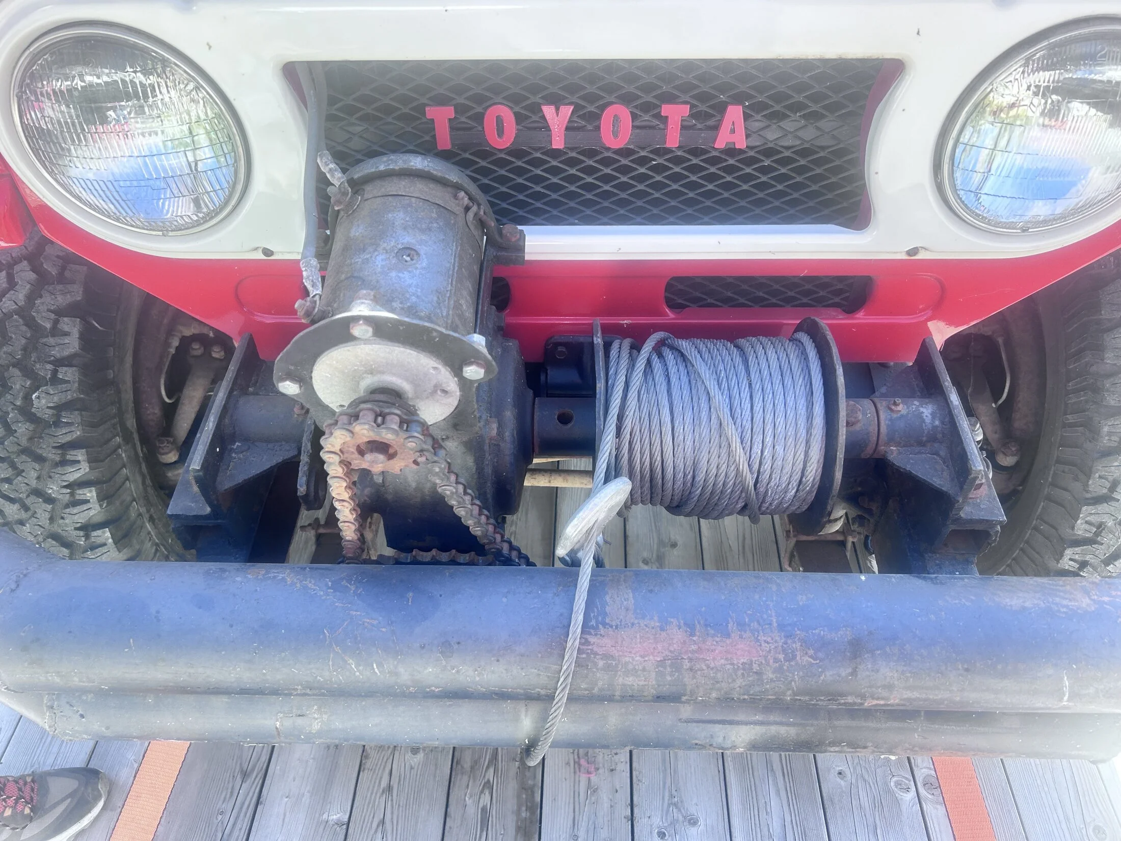

A buddy just picked up a ‘70 for a good deal. It’s far from pristine, but the price was more than fair. As an added bonus it came with an interesting winch. Can’t say I’ve seen this one before and I doubt the lawyers would let it leave the factory like this
As sketchy as the chain drive is being completely exposed- at least it’s loose too.

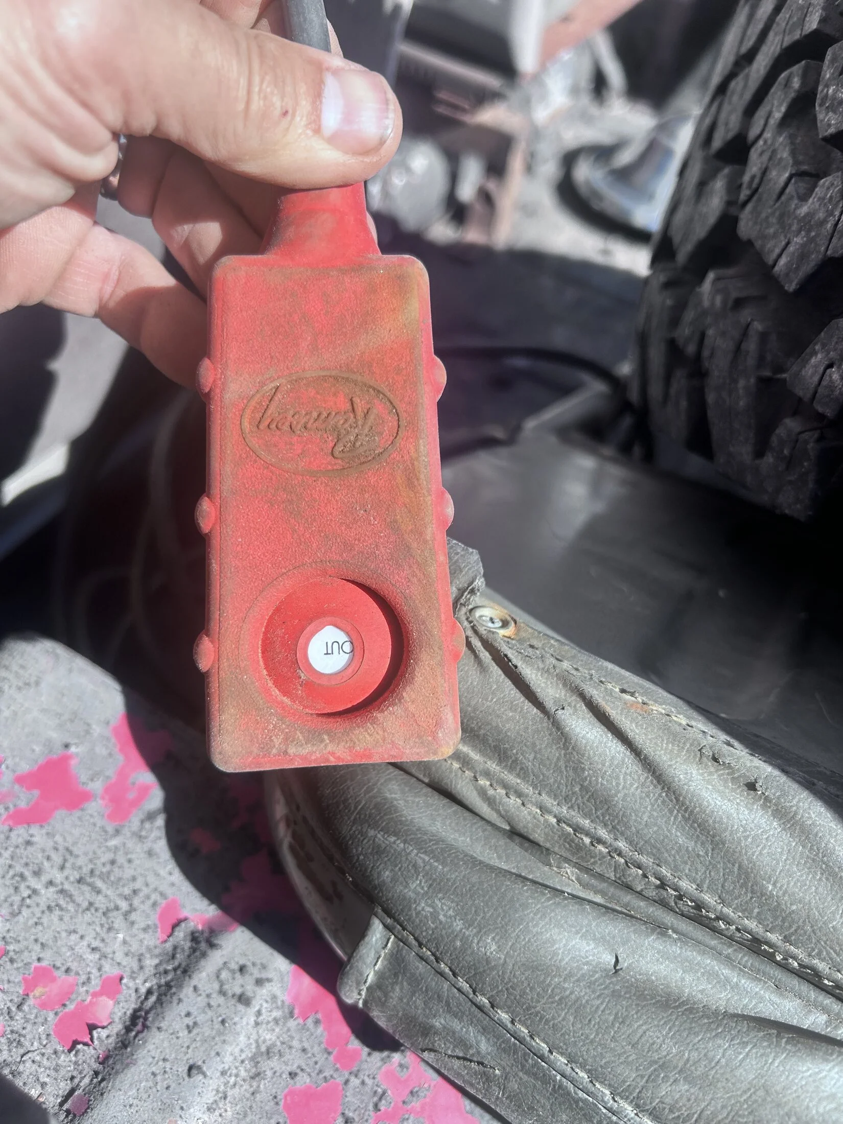

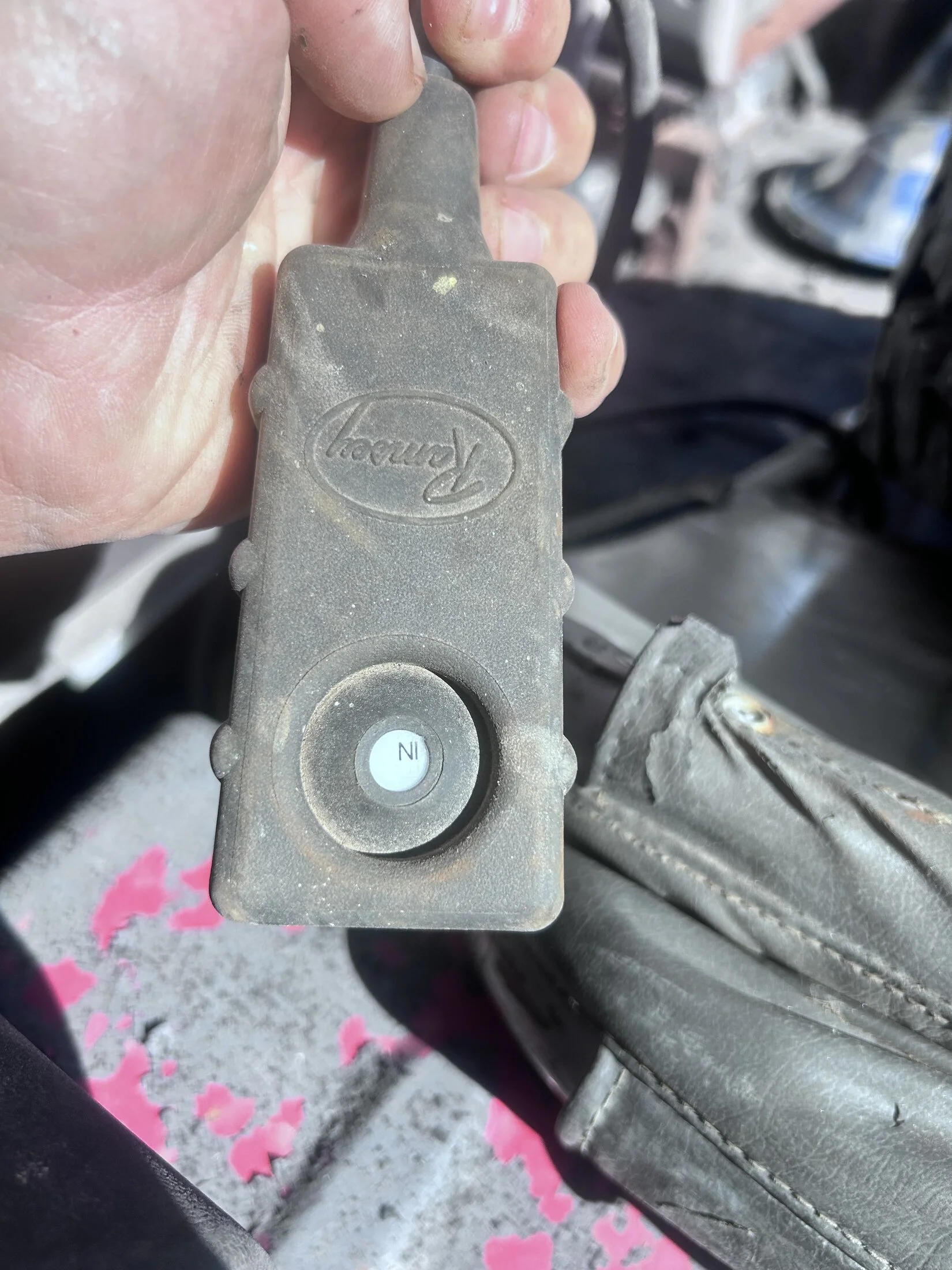

The truck came with a Ramsey remote, but I’m guessing it’s not a Ramsey winch.
Couple solenoids remote mounted to the fender well above the battery(s). No fairlead/hawse.
So has anyone ever seen one of these? I’m guessing it more of a hodgepodge then a store bought unit.
Looks "home built"/modified to me. Not seeing a brake/lock either - might be enough gear reduction to hold the load but I'd rather not be down hill when you find out.

Looks like it the winch was flipped 180° the input shaft would be close to lining up to the stock location of the opening in front frame member for the Toyota PTO winch and the Ramsey PTO winch. The Toyota was designed for the Land Cruiser. Ramsey were more more universal. The plates that bolt to the side frame rails were taller than Toyota's so the input shaft lines up with opening in the front crossmember. The lap of a chain guard or sign of brackets to mount one this winch start out as a PTO winch convert to electric. My 73 FST has a electric winch made from a military jet engine starter motor. It was made locally in the Phoenix area. Plate has a company name and phone number. While not home made it is a small step above home made.
