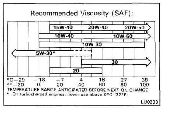

Which engine, and what climate? There are tables in the service manuals for most models that can answer this once we know where to look.
1HZ (NA) New England climate.
This is what I see in the 1HZ Toyota FSM. 15w-40 looks like a good candidate, which type of Amsoil, ya'll using? I'm thinking of DME.
Signature Series Max-Duty Synthetic Diesel Oil 15W-40
10w-30 has a pretty wide operating range, and also provides another -5F protection more than the 15w-40, which has a pretty narrow operating temp range. The "temp range" specified here is the ambient outside temp?
I'm running 5w40 Rotella T6, winter here gets down to -36C, summer gets up to 36C, so a wide range of conditions.
So which engine? I'd hate to look at your sig and assume its a 1hd-t. 5w-40 isn't even on the 1HZ FSM graph.
It is the 1HD-T, its possible 5w40 weight didn't even exist when these manuals were printed, lol.
