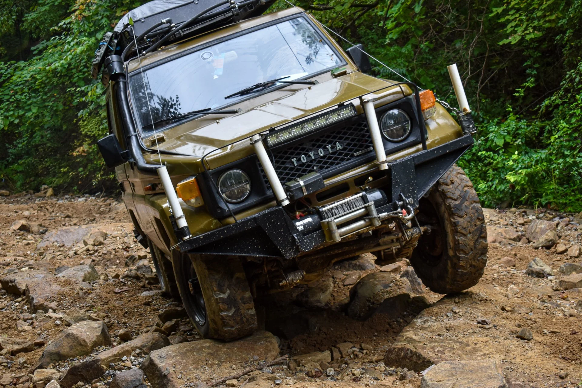

I have been considering fabricating a new front bumper to replace my previous creation. There's a couple key areas where my old design didn't have enough strength. I've also realized that I like the factory type winch bumper you can stand on and walk on. I'd just like it about 5 or 6" higher up. With the bumper sticking out that far you don't really need a brush guard loop. I've recently started welding aluminum and am considering fabricating a new bumper out of aluminum. Probably use steel plate to mount the winch and a couple of pieces of braced steel box tubes behind the bumper as a support to jack under. I'm guessing I could loose 100# off the front end this way.
Anyone have any opinion on aluminum vs. steel bumpers and what thickness is good for Al.?

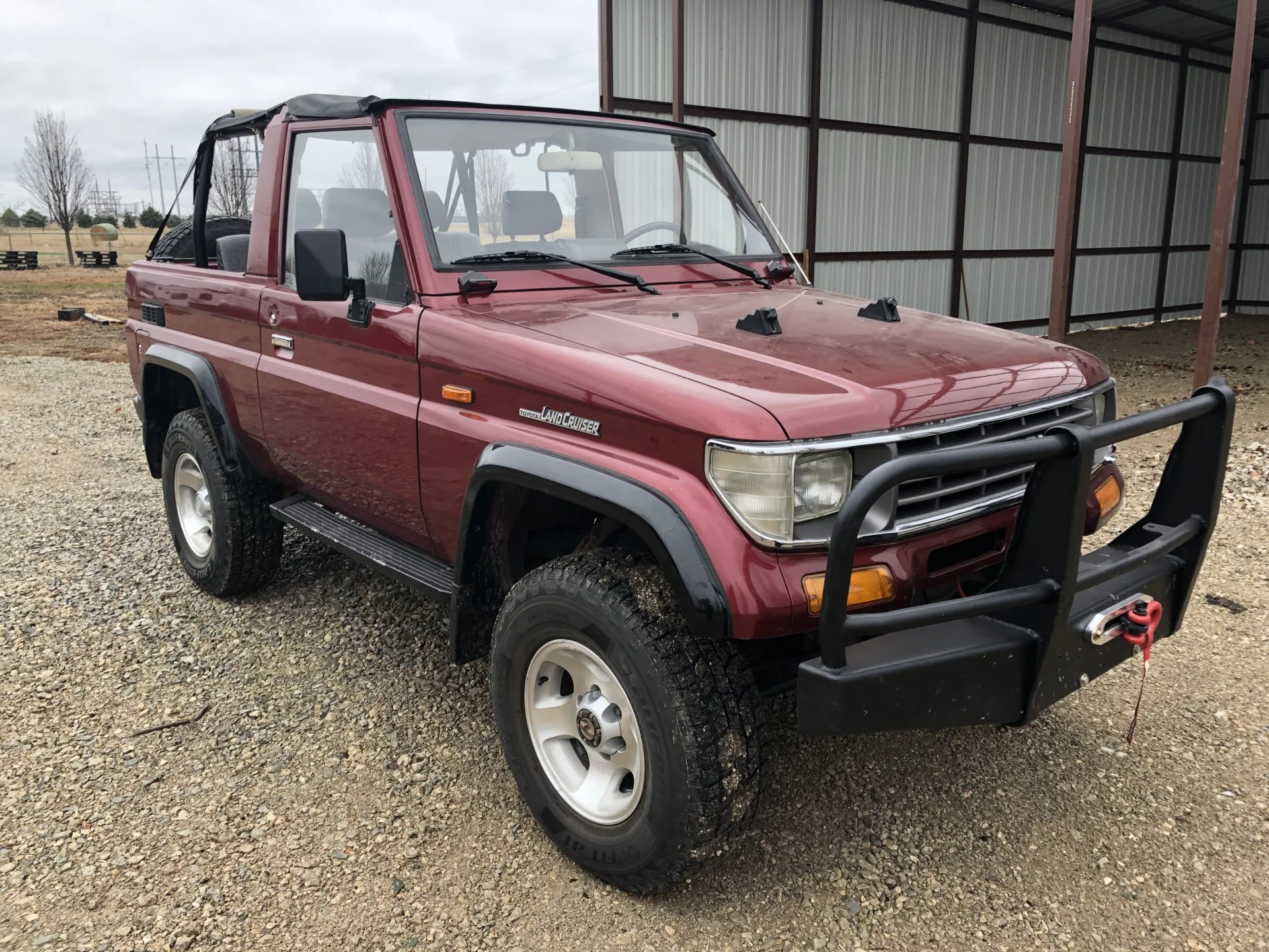

Thankyou for the information. This is a backburner possible future project for me. I designed my steel bumper with a number of requirements: Ability to put a high lift jack under the bottom of it all the way across(flat surfaces), Good approach clearance for the tires, Mount a winch, not restrict too much air to the radiator, Brush guard that also mounts lights and fishing rod holders...................It is not strong enough in the middle between the frame rails. I used 3/16" and some 1/8" plate and 1/4" bar. It is bolted to the frame not welded. In order to get the winch in and out it has a little less steel in the middle than I'd like. I used 2 pieces laminated/welded 3/16 instead of 3/8 plate under the winch. (not thick enough).
If I make a new one I will make a bumper out of aluminum similar to the factory winch bumper, but it will be about 4" higher for more approach ground clearance. Winch will be on 3/8" steel plate on top of frame rails/bumper. Bumper will stick out enough that I won't need a brush guard. I'll take a chance on the winch restricting airflow. to the radiator.
