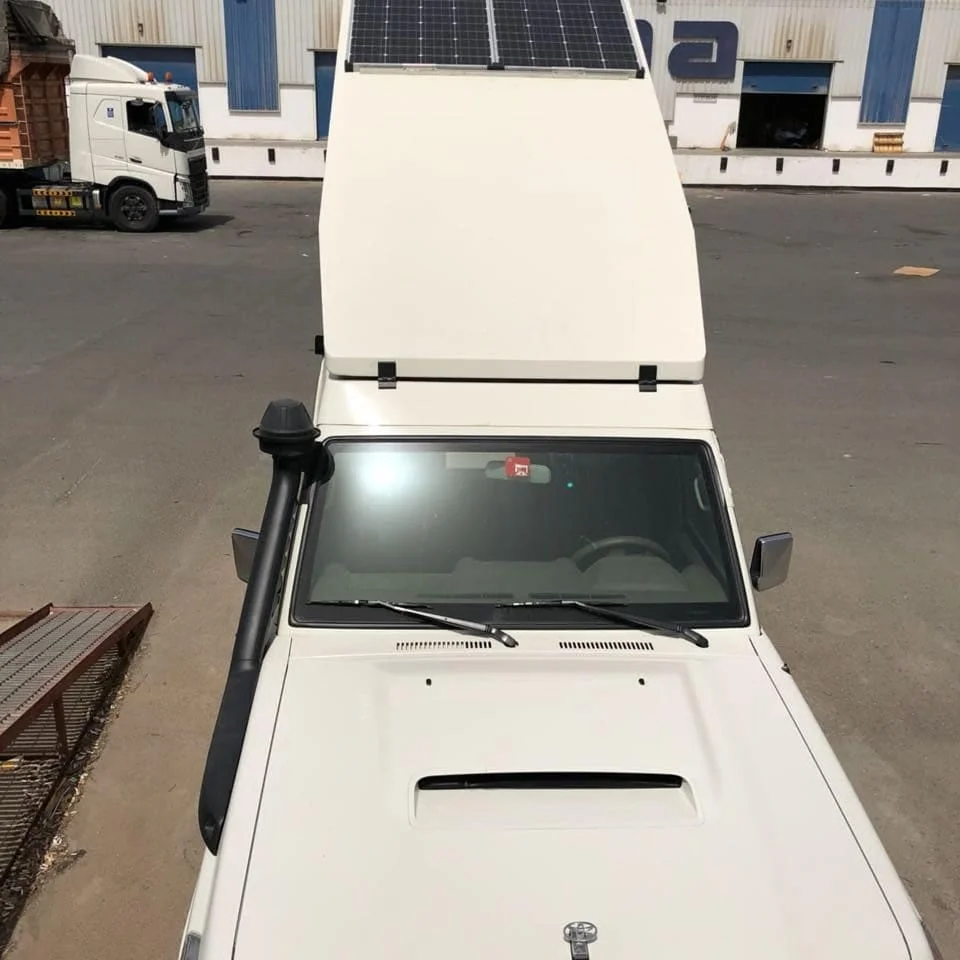

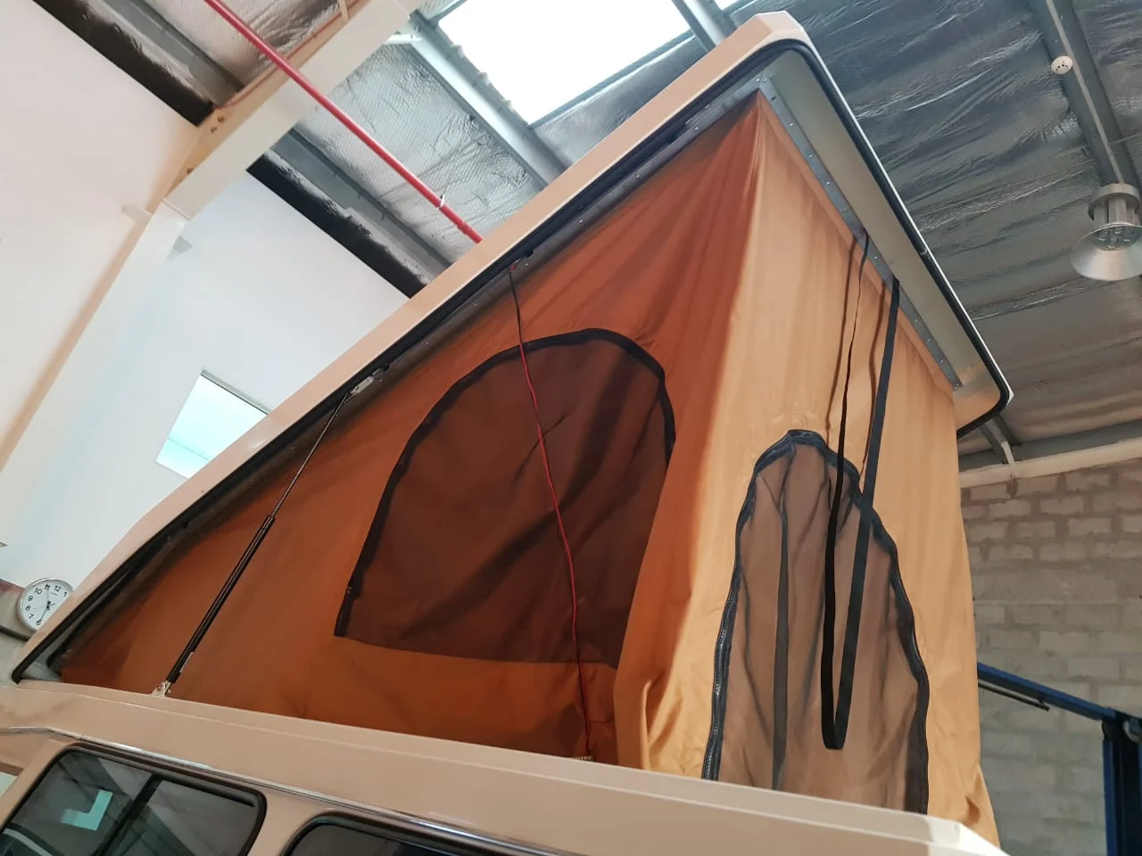

Does anyone recognise this roof conversion?

A couple more images. It looks like it may be locally produced here in Dubai. Alloy construction, similar to Alucab. Organised to go and see it on Saturday. Local cost c. $6k US.

Went to see this conversion today, and got to admit, it's impressive.
The roof is manufactured locally in the UAE. It's an alloy box frame and clad, similar to the Alucab roof, but keeping some of the original Troopy lines, which the Alucab roof is sorely missing.
The bed is a pop-up inside of the roof, so you still get the extra headroom when inside.
I haven't got any details of the weight yet, but everything seems extremely well thought out, taking the cues from the Alucab, but with some more thought.
The only thing I don't like is the front hinges. They're billet metal and seem to be solid - no lateral movements from the pivot, but I guess I'm used to seeing a more robust piano type hinge the width of the roof of the Alucab. I also don't like the fact there isn't some kind of shade over the end window. Speaking with the team who produced this one, they're open to making it fit my spec, which is nice.
Does anyone have nay recommendations where to look for different hinges for the width of the tent, mounted inside?
