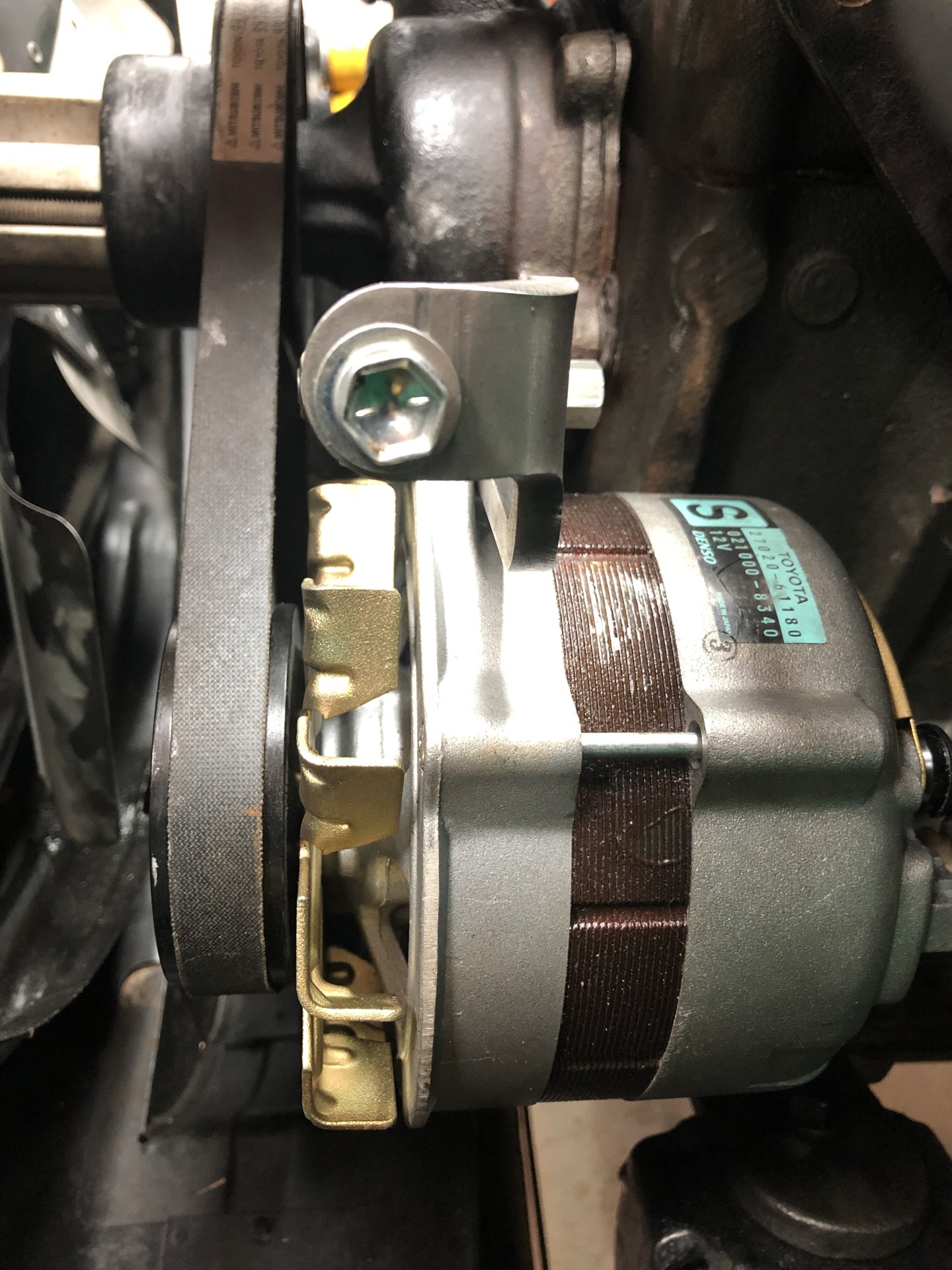

Head-scratcher, tech question. My 72 was totally disassembled when I got it. It came with a rebuilt 2F engine, engine / transmission which I’ve installed. From what I can see, the alternator bolted on the lower left side on the 1F engine, but on the 2F I don’t see any bolt provisions and the 1F bracket doesn’t fit. Anyone have a pictures of the alternator mounted on a 2F or a solution? I also need one of the bolts that secure the bell housing to transmission. I think is got a 19mm head size. Anyone know where I can buy one? Lastly, fuel tank is out and I am cleaning / sealing it. Trying to get it running by end of the month.

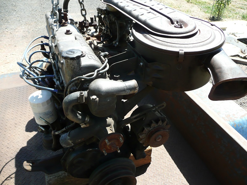

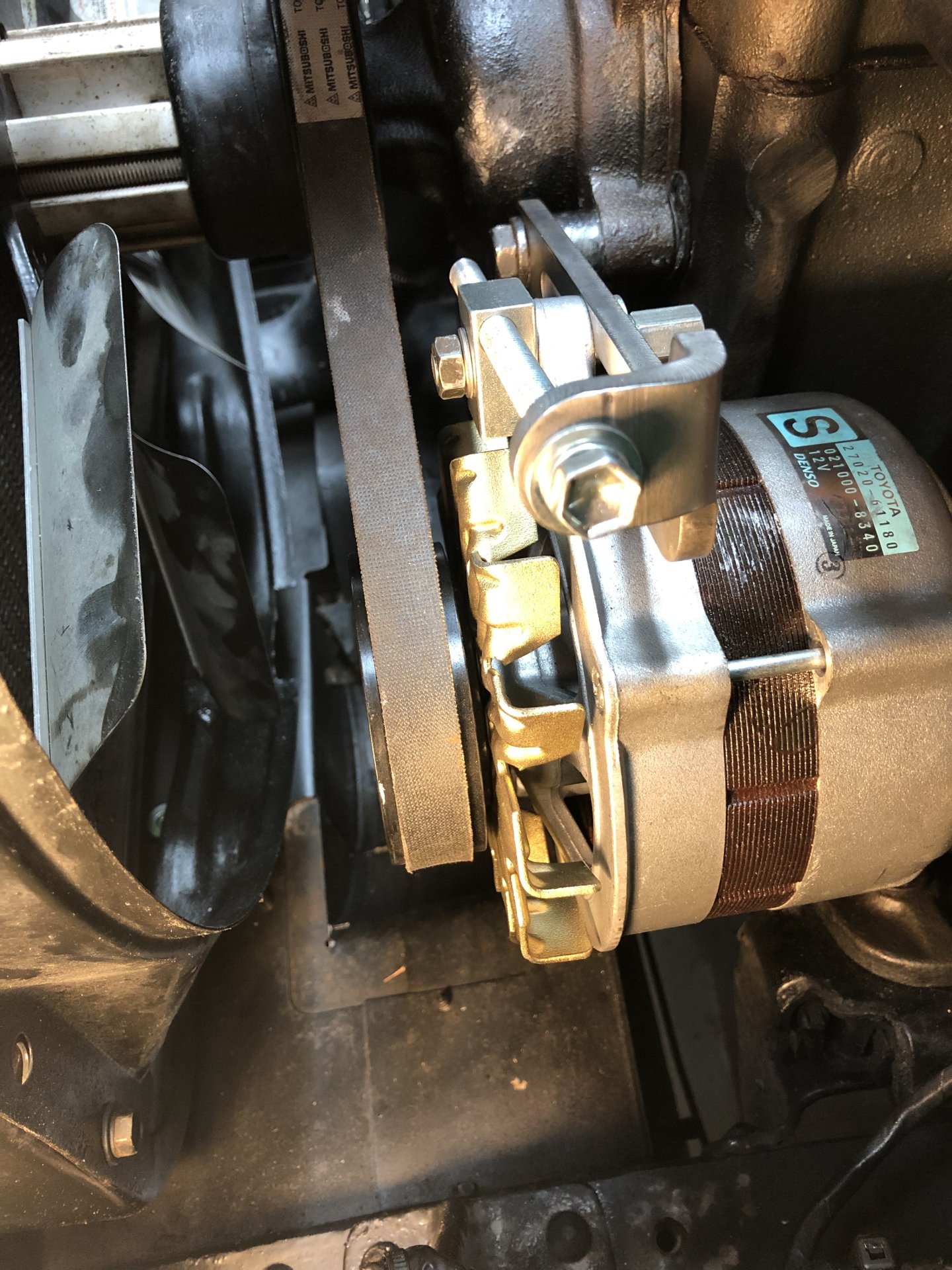

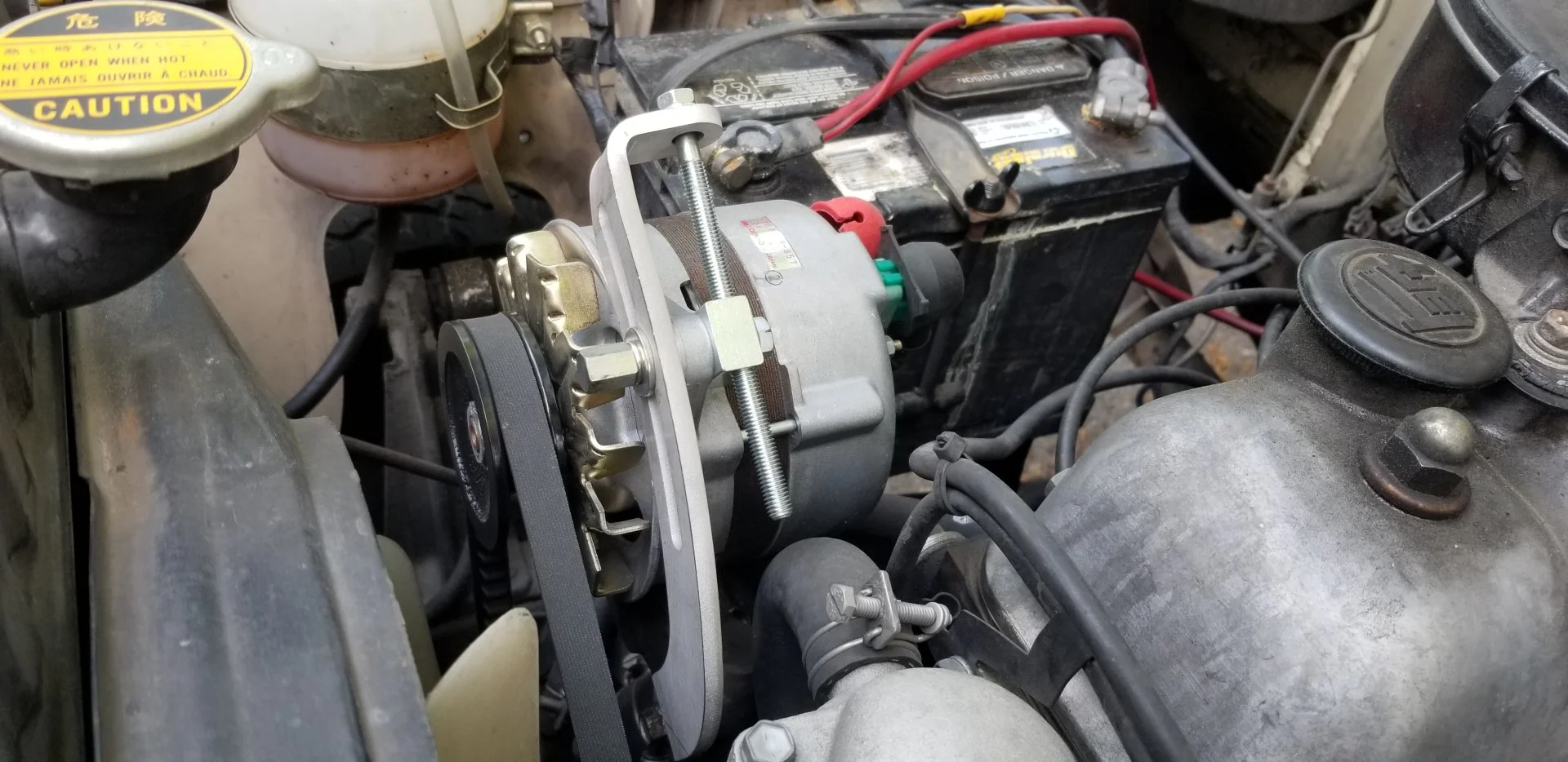

Plenty of 2Fs with the alternator on the lower left side. It was the US market with an air pump reason for the change. This is a 11/83 build 2F.
The original generator was mounted there. The alternator after that. The air pump was originally on the upper right and switched locations with the alternator on the 2F in the US market. I know the power steering pump would go on the upper on the engine pictured above. The air conditioning compressor was on the lower right on both. Would not be possible to run an alternator, air pump, power steering pump and air conditioning compressor with the air cleaner above.
