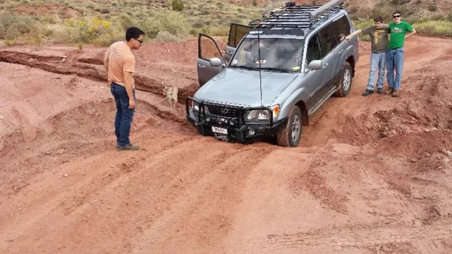

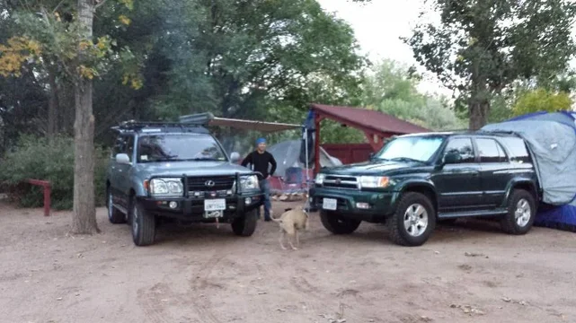

A few pics from Onion Creek Trail, one from camp and one view from the top of Canyonlands NP. We took the trail on the right, all the way to the trail at the bottom center of the picture. The trail got much much more narrow around that right hand bend. Worst part is that we had a Gopro and a Sony actioncam. Neither was pointed off of the 1000 ft sheer wall while I drove down there white knuckled and afraid to look over the edge.
So now I have to drive the scariest trail I have ever been on, AGAIN during Cruise Moab next spring so I can film it all in HD.
