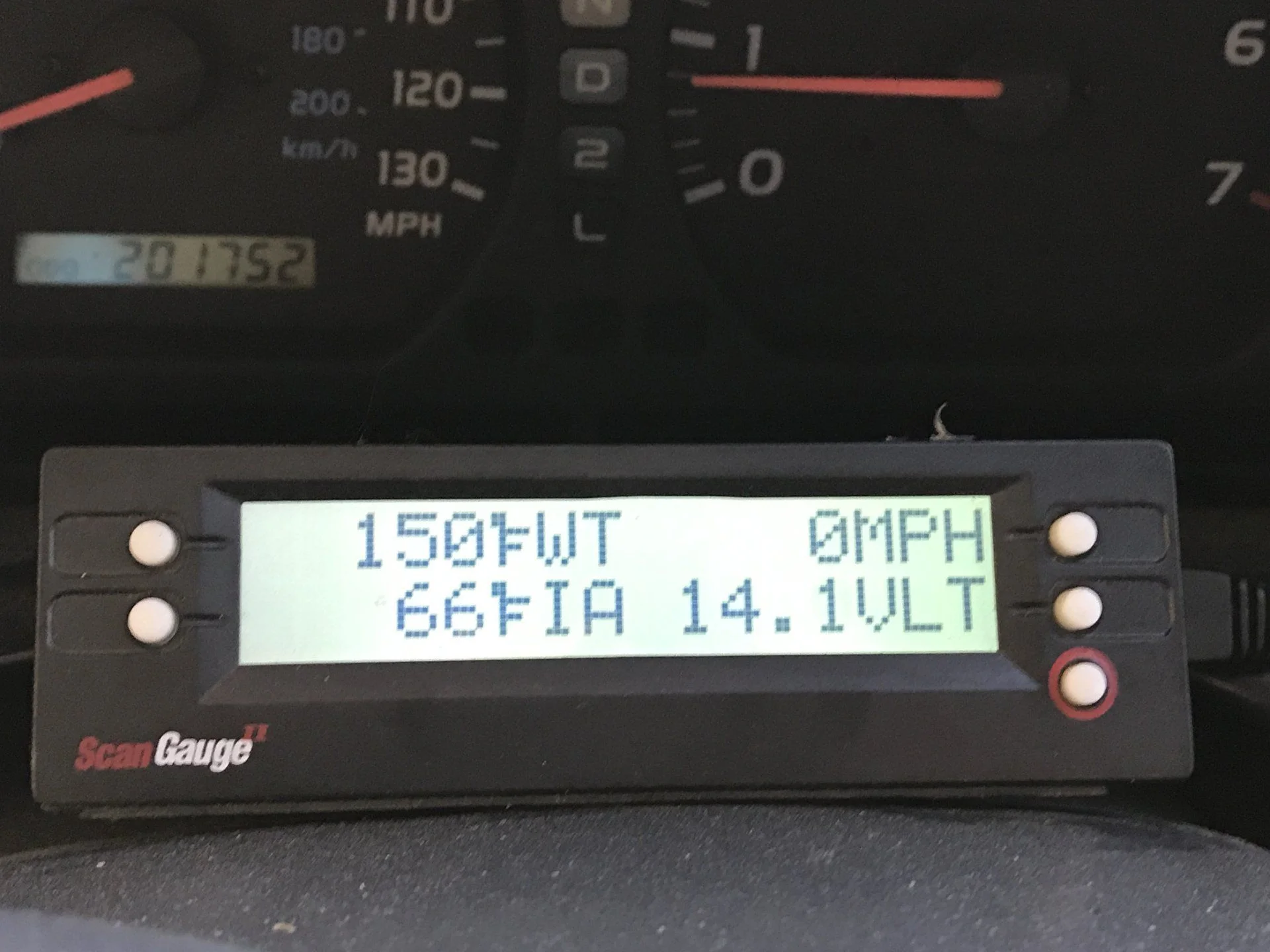

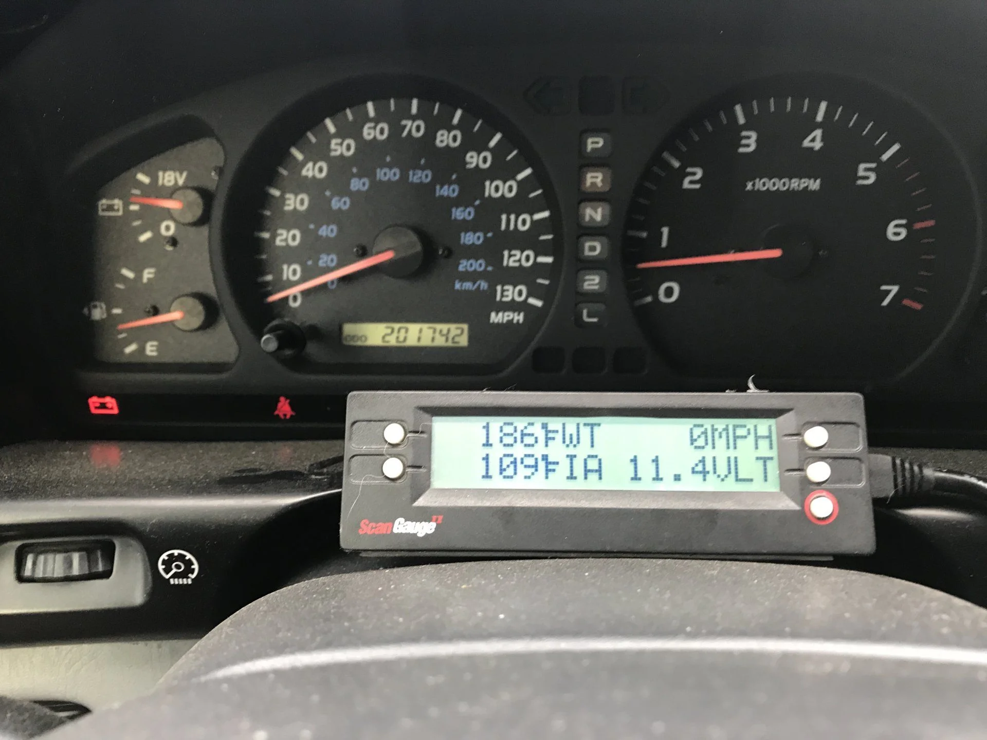

I have never had an alternator get weak. My experiences have been that that all of a sudden fail, completely.
Could this be a connection somewhere? Or is the alternator going out?
I would put a multimeter on the battery while running. See what voltage you get there but 11V looks like a shot alternator to me.
Always check connections first (leads, grounds, etc), but IF that reading is accurate, your alternator is No Bueno..
The 100 ALT tends to die with a heads up as you see. If not noticed then they appear to die "suddenly". 200k miles is well worn and shouldn't be a surprise. I changed mine at 188k. It was starting to be in the low 12v range so I put a big Amp replacement.
Multi multimeter confirms scanguage reading.
Thanks guys.
Like I said, any problem I've ever had with an alt was a sudden death, never a slow one. This confused me.
I appreciate all the comments.

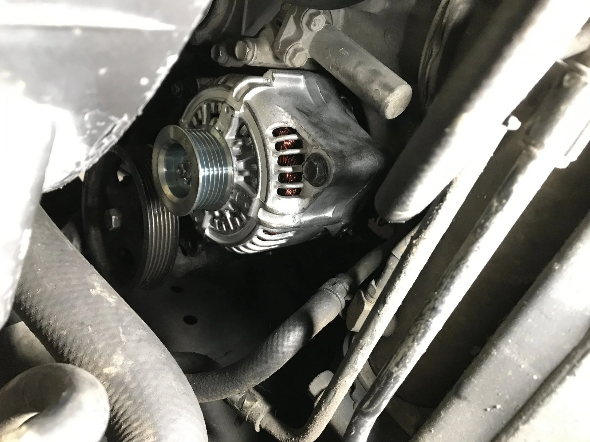

I went with the Napa reman 100 amp. It's all I could find in stock, and I need to get this truck back on the road.
You should have replaced the brush kit.
Got this sucker in there.
Wasn't too bad of a job working from the bottom. Took me maybe 30 minutes.
Did you have to move the fan shroud at all? Or just have to pull the PS pulley to get to it?
I just pulled the bolts on the PS pump, moved it up a little.
How the f$%k did you get this out the bottom? I have 3 or so cooler lines in the way.
Well, from what I remember, I had to rotate the alternator just right to get it out.
Follow the cooler lines back to where they are held in place by a clamp, loosen or remove that bolt so the cooler lines can be pushed out of the way. Turn the alternator sideways and sneak it past the lower radiator hose. Its tight...but its doable. Did mine that way.
