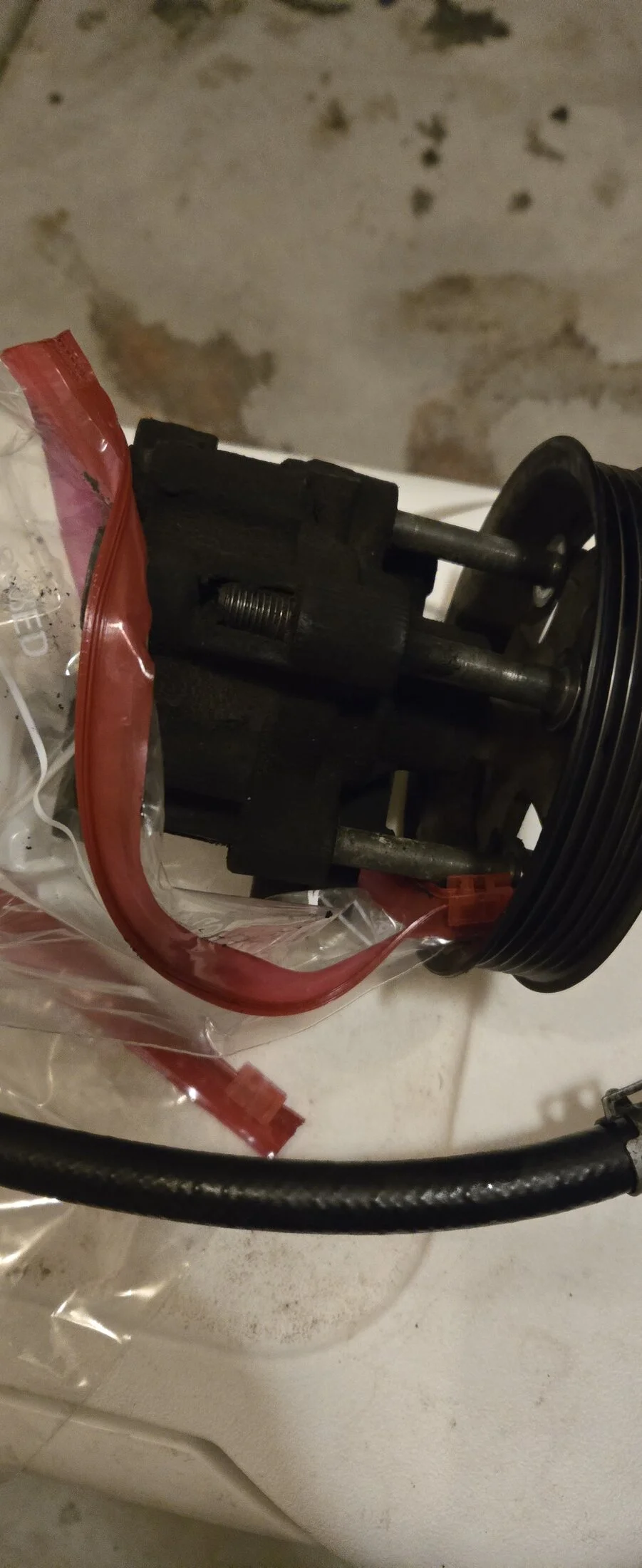

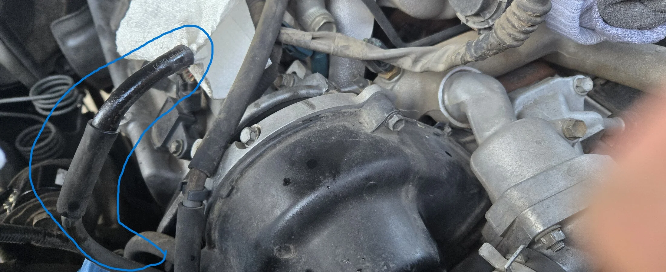

So I started on the belt tensioner pully. I figured it'd be a quick one. However, upon starting this job, there has been a leak from the two hoses that come out of the power steering reservoir. There is also a few lines I need to replace that were cracking or already messed up. As such, can someone recommend which parts to use for this please?
1. Both hoses that come out of the Power Steering Reservoir
2. Heater hose?
3. The other hose?
4. Power steering reservoir
Also, this power steering pully and such has tons of old stuff on it. How can I tell if it is still ok to reinstall, or should I just buy another one?

You can replace the power steering hoses with stock hose from your local auto parts store. Just clean up the pulley with brake cleaner or purple power. Someone found the reservoir is also on some GM product, IIRC. Search the forum for that. The top hose you circled is a breather hose that someone already replaced with stock heater hose.
This makes sense, thanks.
