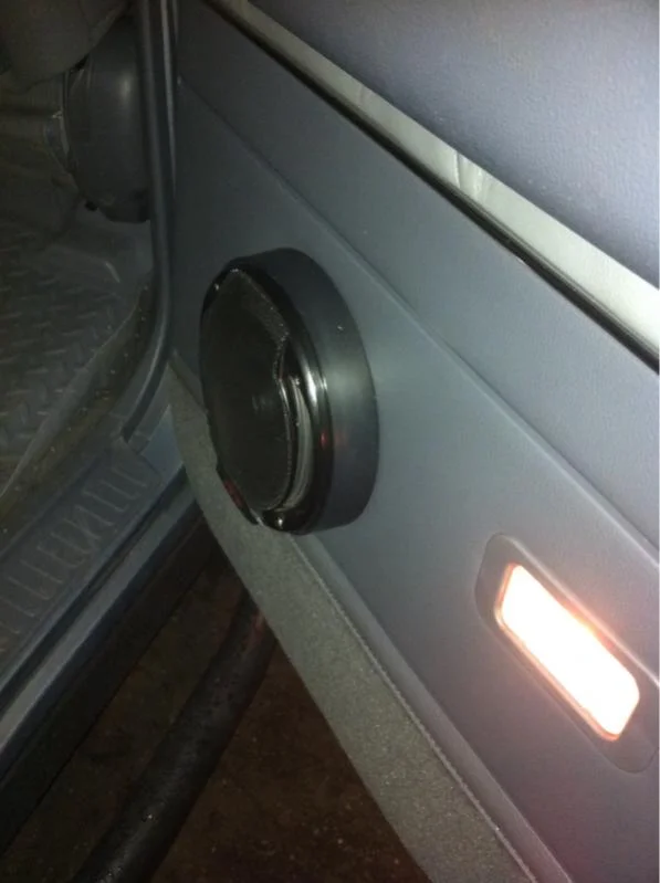

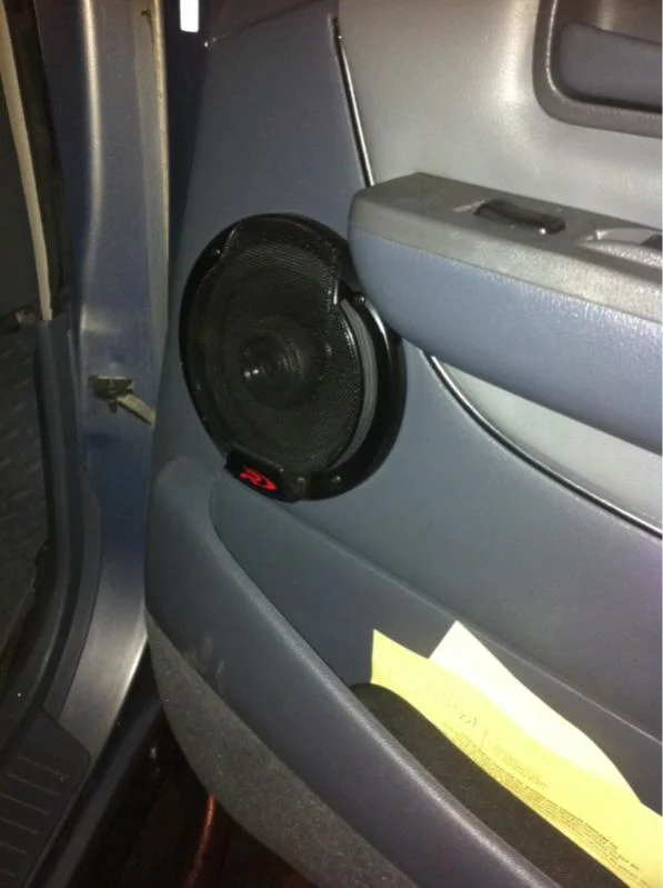

If you're ok using the Alpine grills and not the factory grills, you can use the spacer outside the door to pull the magnet away from the window mechanism. With my Infinity speakers (6 1/2" in the rear), I was able to put a thin spacer inside the door panel. It pulls the door panel out a little, but not really noticeable. They are a PITA to install behind the door panel, but it works.
Fronts
Rear
X2. That's what I meant by spacer.
