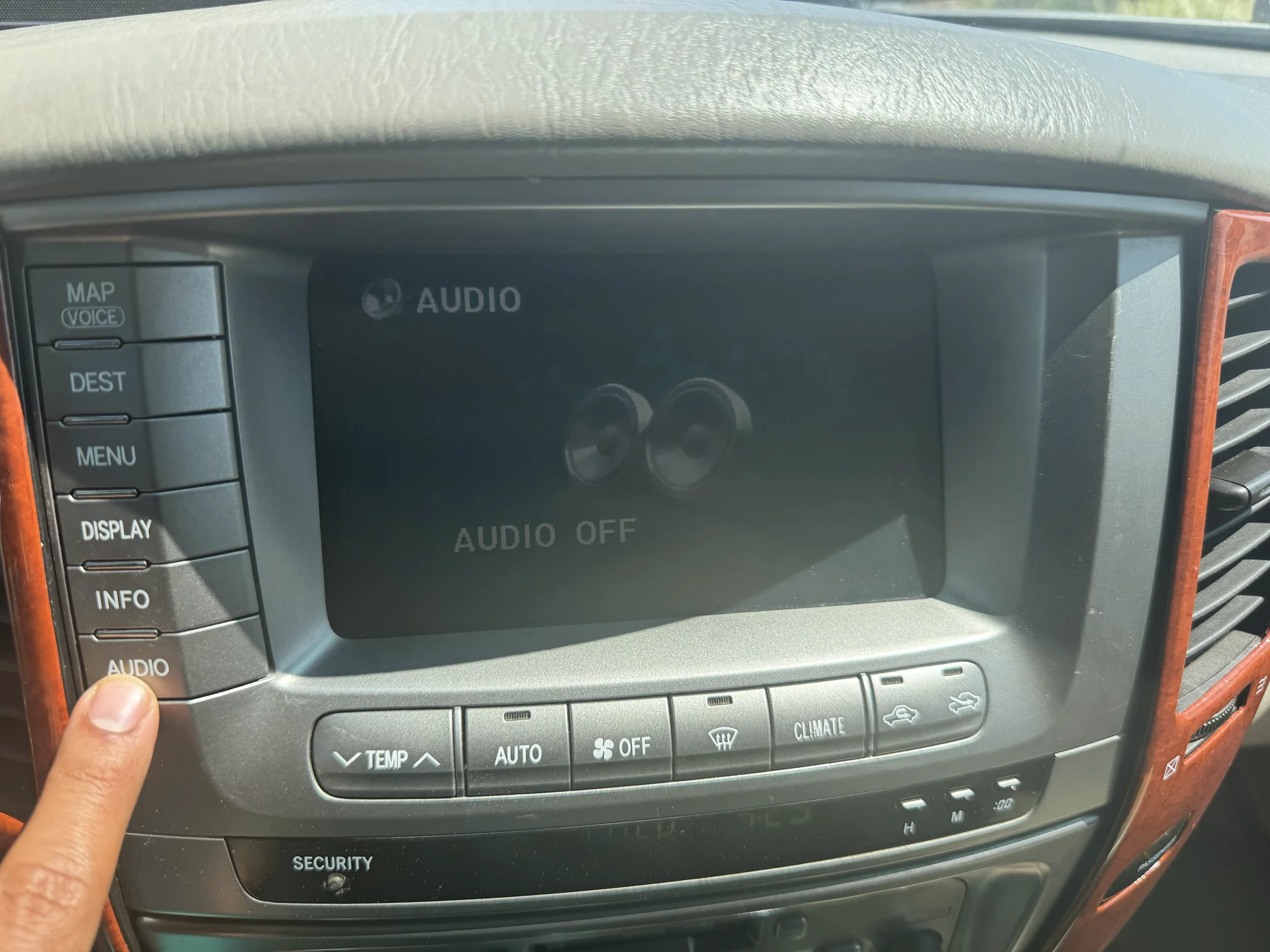

I tried to install an aftermarket headunit from china in my 2004 LC. When I plugged the headunit in, it turned on for a while and then turned off (refused to turn on again).
When I put my factory nav/radio unit back in the following happened
  1. ZERO audio in the car. Not even the nav screen touch beeps.
  2. Back up camera does not turn on when put in reverse.
  3. Clicking the “AUDIO” button just leads to “AUDIO OFF” screen.

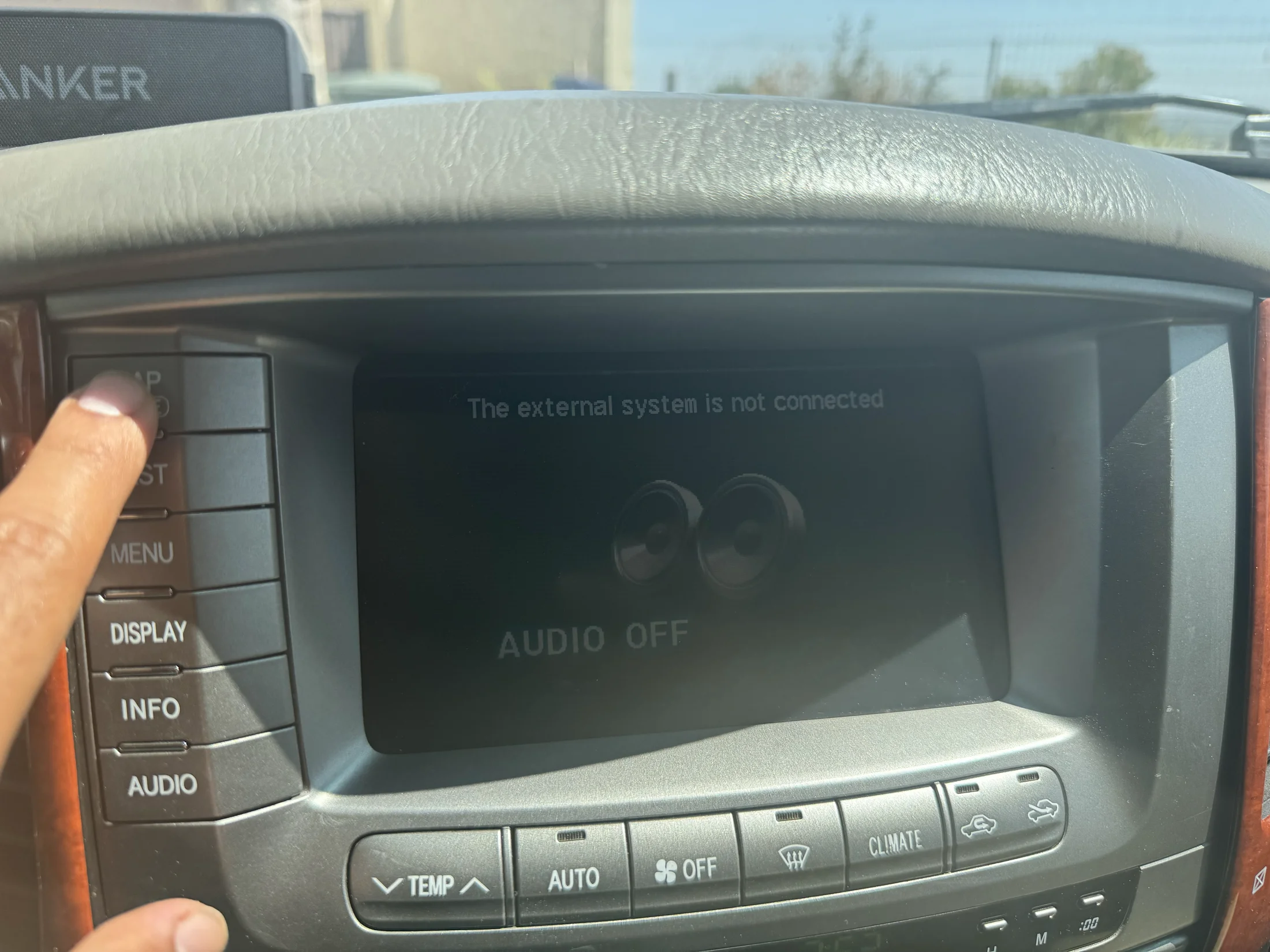

  4. Clicking the MAP button just displays “EXTERNAL SYSTEM NOT CONNECTED”

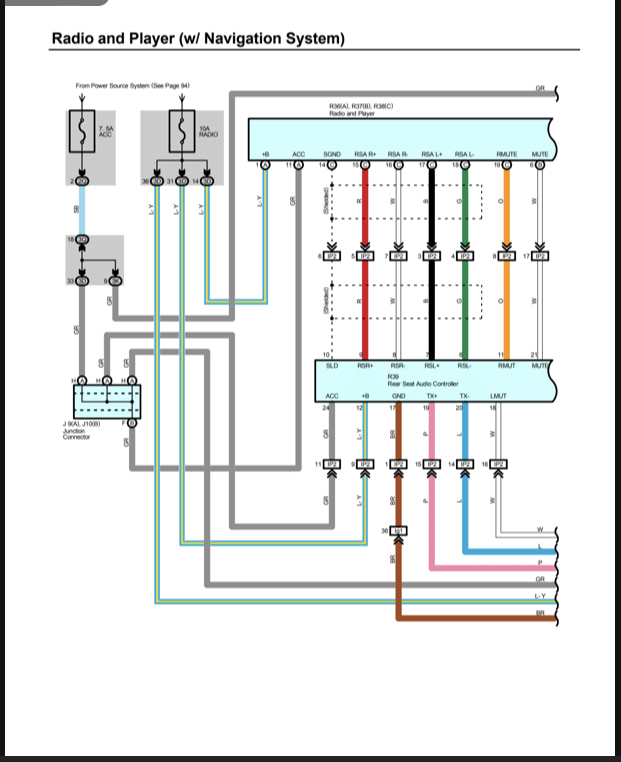

  1. Checked and replaced the radio fuse on the passenger side. Did nothing.
  2. Had a mechanic measure the power feed into the radio unit from the harness (and he said it looks good)

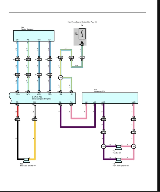

Have attached pictures here:

I don’t have a 2004 with nav, but they’re looks to be a diagnosis mode that you can activate. Did you try that?
The FSM also has the radio troubleshooting steps.
