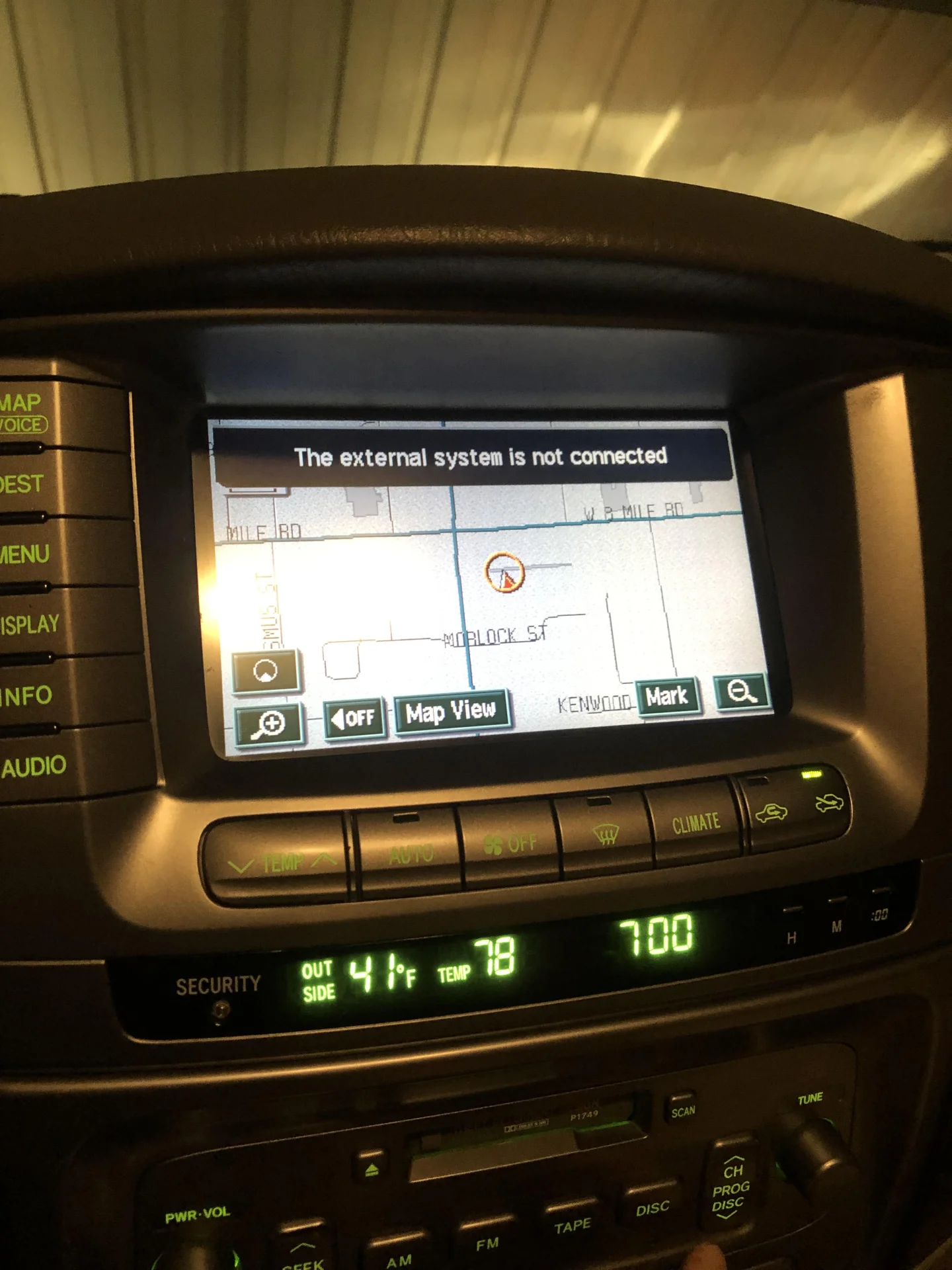

I did some inspections to the DVD changer and found few coins that may have shorted the motherboard, so I purchased a working DVD changer and installed it. Now, the DVD changer ejects the magazine but as soon as I hit Disc button, "the screen prompts with the following message "The external system is not connected" also provided in the picture below;
I also purchased a working RSA, and it is not working either. I disconnected the battery for 12 hours but again the RSA doesn't work same with the DVD changer, "The external system is not connected". I removed the overhead DVD player and the issue is still present. I am not quit sure what other sanity checks should be done. Anyone in here had similar issue could provide some insight. I noticed when I removed the battery for 12 hours, the configuration on my Navigation was not removed. I have seen in this post System Check Mode that it is possible to test/diagnose all of the units e.g. RSA etc by entering the "System Check Mode", is there any way to get to the "system check mode" like in the picture below;

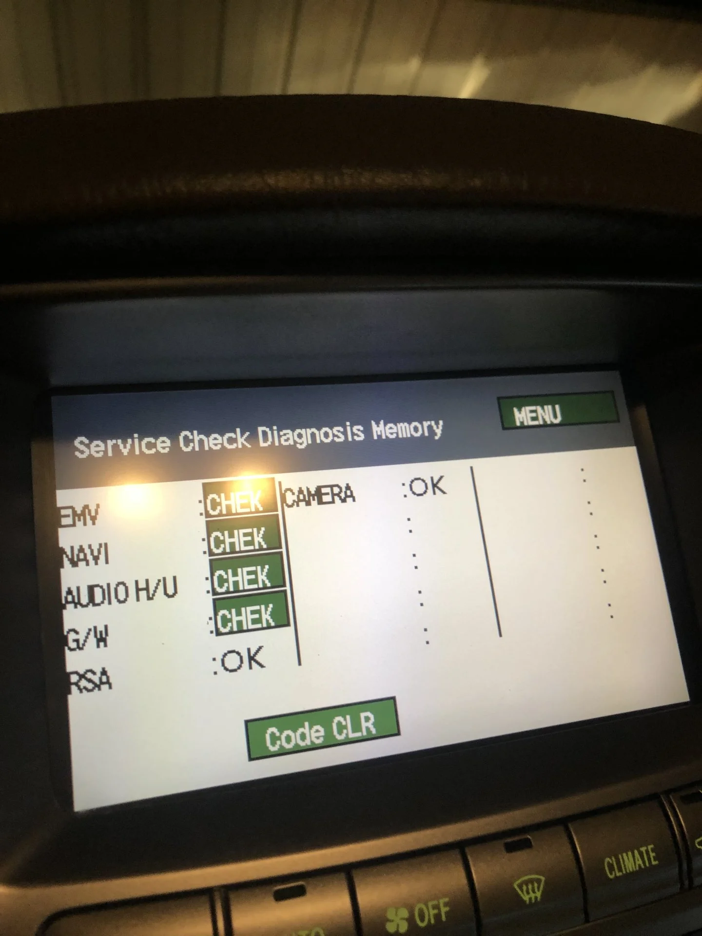

Got some time to work on my Land Cruiser today but no luck so far. I tried the System Check Mode and got the following;
So, the RSA using seems to be not connected or at least the MFD is not seeing it. I tried to remove the all codes by holding the Code CLR then pressed hold on the info button and switching on and off using the headlight button to see what are the possible diagnoses like below;

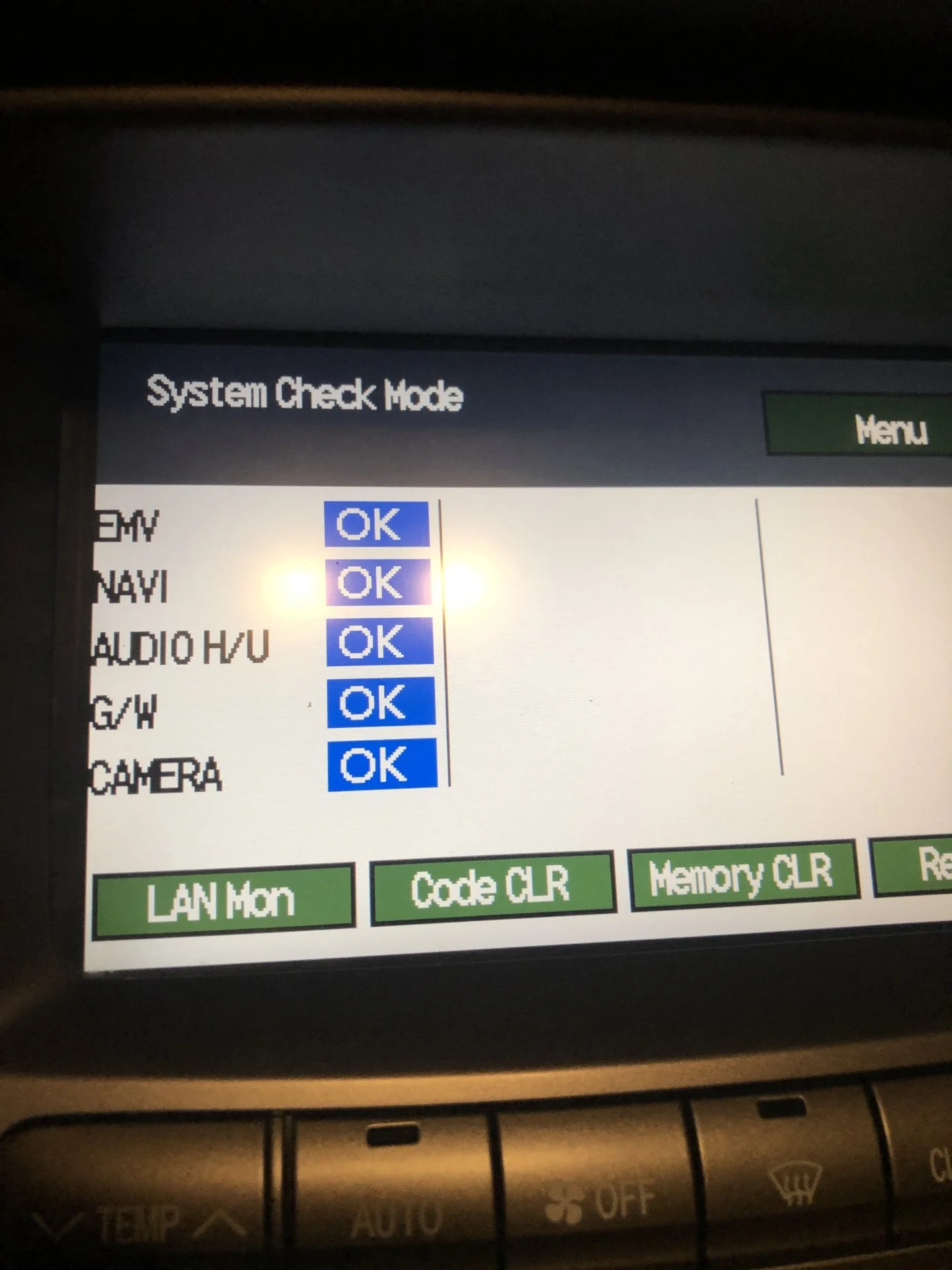

In the service check memory, it is stating that the RSA was ok so I cleared the codes and memory as well. Now when I went back to the System Check Mode, I got the following;
The RSA isn't on the list no more. What could be the possible issue here? The DVD changer still ejects but again when I hit the Disc button it's prompting with "The external system is not connected", Is the MFD need to be reprogrammed or is there a wiring issue or a faulty MFD? This is harder then what I thought. Any advice would be appreciated.
