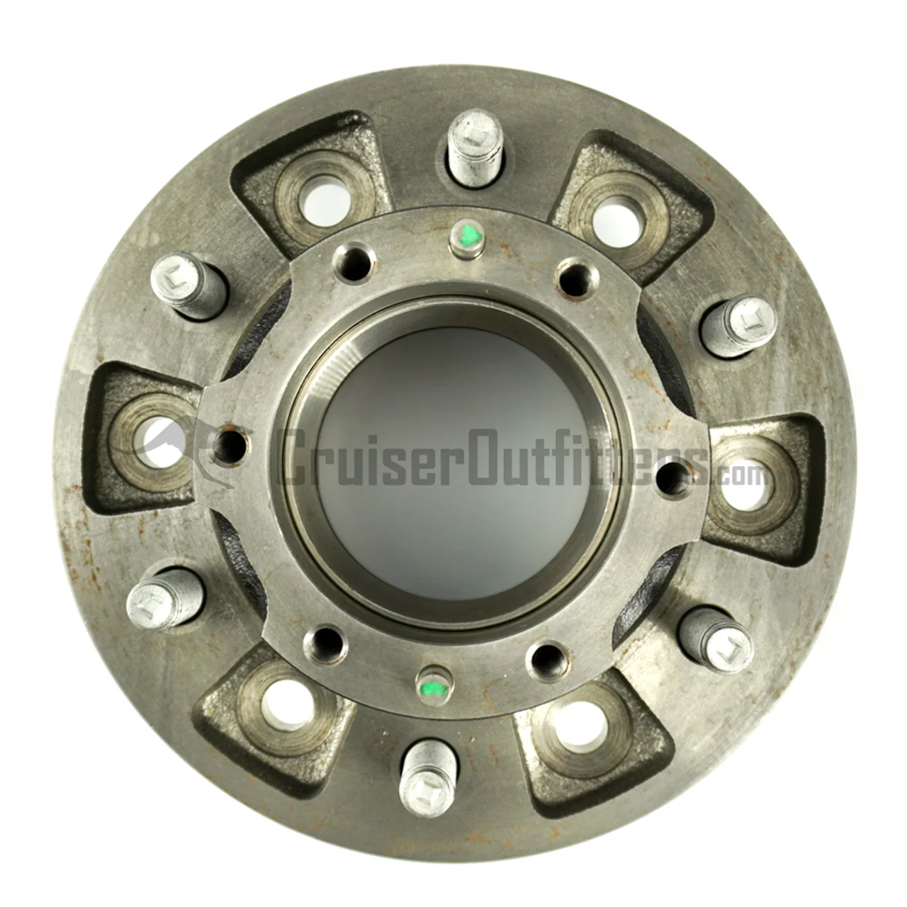

Thanks Kurt. Any idea what the reason is for the odd-shaped hub base (centre top in your picture)?
Nothing practical, but Toyota added the same "scallops" or reliefs to the wheel hub itself so AISIN matched it. So long as the pattern matches, the shape isn't a deal breaker UNLESS you want to upgrade to 6 dowels, can't be don't with the scalloped.
For example the 80 Series:
