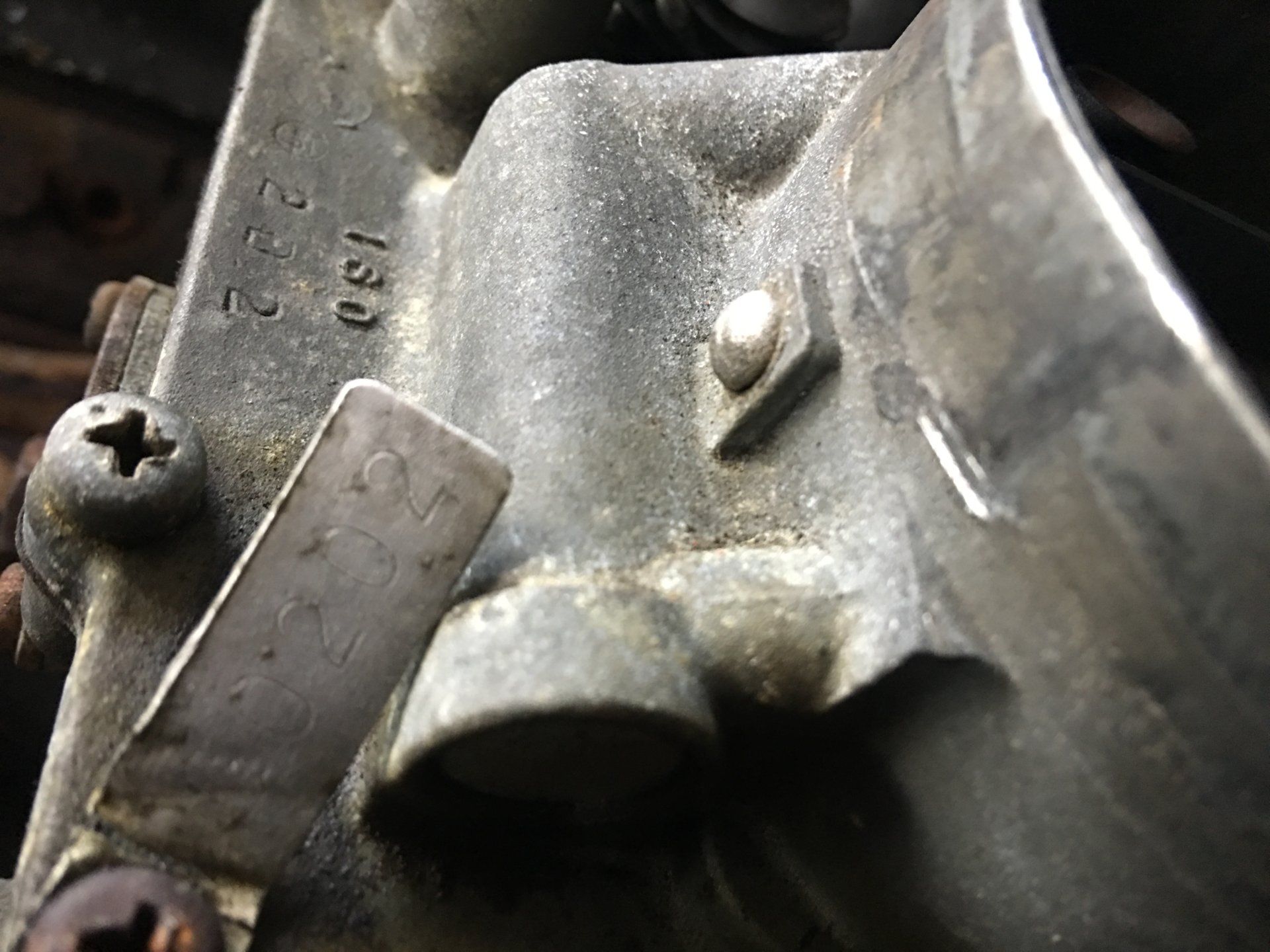

1972 FJ40 replaced with 2F engine by PO. The carb has stamped 2D2. Is that April 2, 1972 build? Is that an F carb? Dizzy looks to have vacuum line that goes to this black box and then hose to under carb.
Can someone explain this set up please?

and that does look like an F carb.
Yep 72 carb. As Pighead mentioned the dizzy is considered a (early-68). The black box is emissions gear, it is called a vacuum switching valve. If you want to eliminate your emissions stuff, one option is have 65swb45 or fj40jim add a ported fitting to your carb. You’d hook the dissy directly to the new port.
