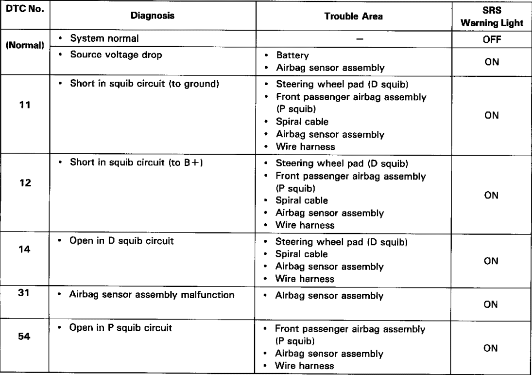

Not to be a dick, but what does the diagnostics page in the FMS say to look at? I don't know, I'm just putting it out there.
Like I said, Not being a dick...I looked it up.
"The diagnostic system malfunction display for this circuit is different to other circuits -when the SRS warning light remains lit up and the DTC is a normal code, source voltage drop is indicated."
The book says your trouble ares are the battery and/or the Airbag sensor assembly.

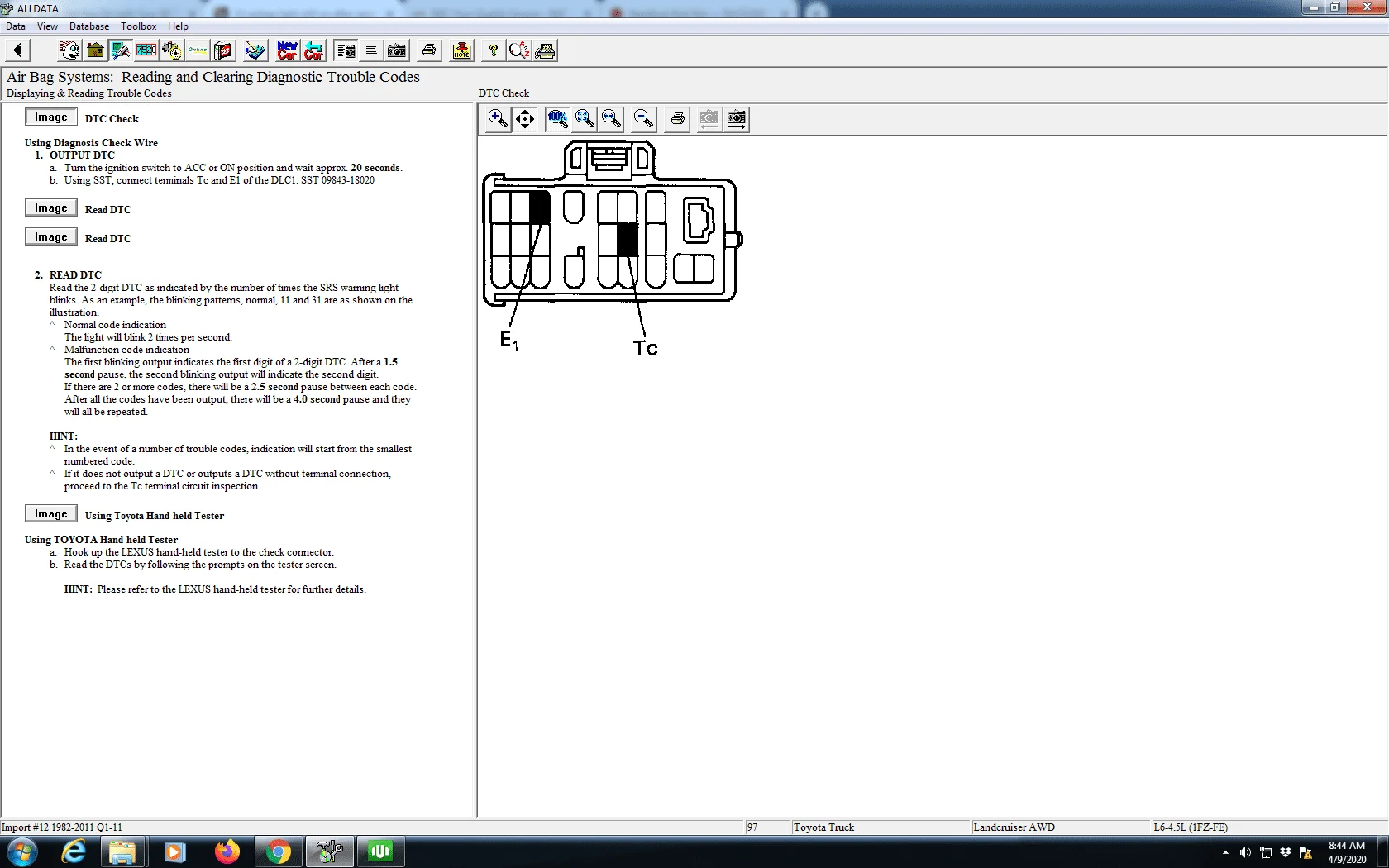

I have the E copy and find it hard to navigate. Did your find the part that you copy and pasted under "introduction-For all vehicles" or under steering "supplemental restraint system"? I'm looking into it more and cannot find the part you quoted for me.
Thanks again for your help. Either i'm retarded or the online fsm is a pita to navigate.
Under Diagnostics DI-238 in the 96 addition
I've been looking all morning and still haven't found it. lol I'll keep looking, thanks
Section "DI-Diagnostic Information" in the FSM, not the EWD. Page DI-238 "How To Proceed With Troubleshooting Supplemental Restraint System"
If you're looking at page numbers of the actual PDF file, it's page 671.

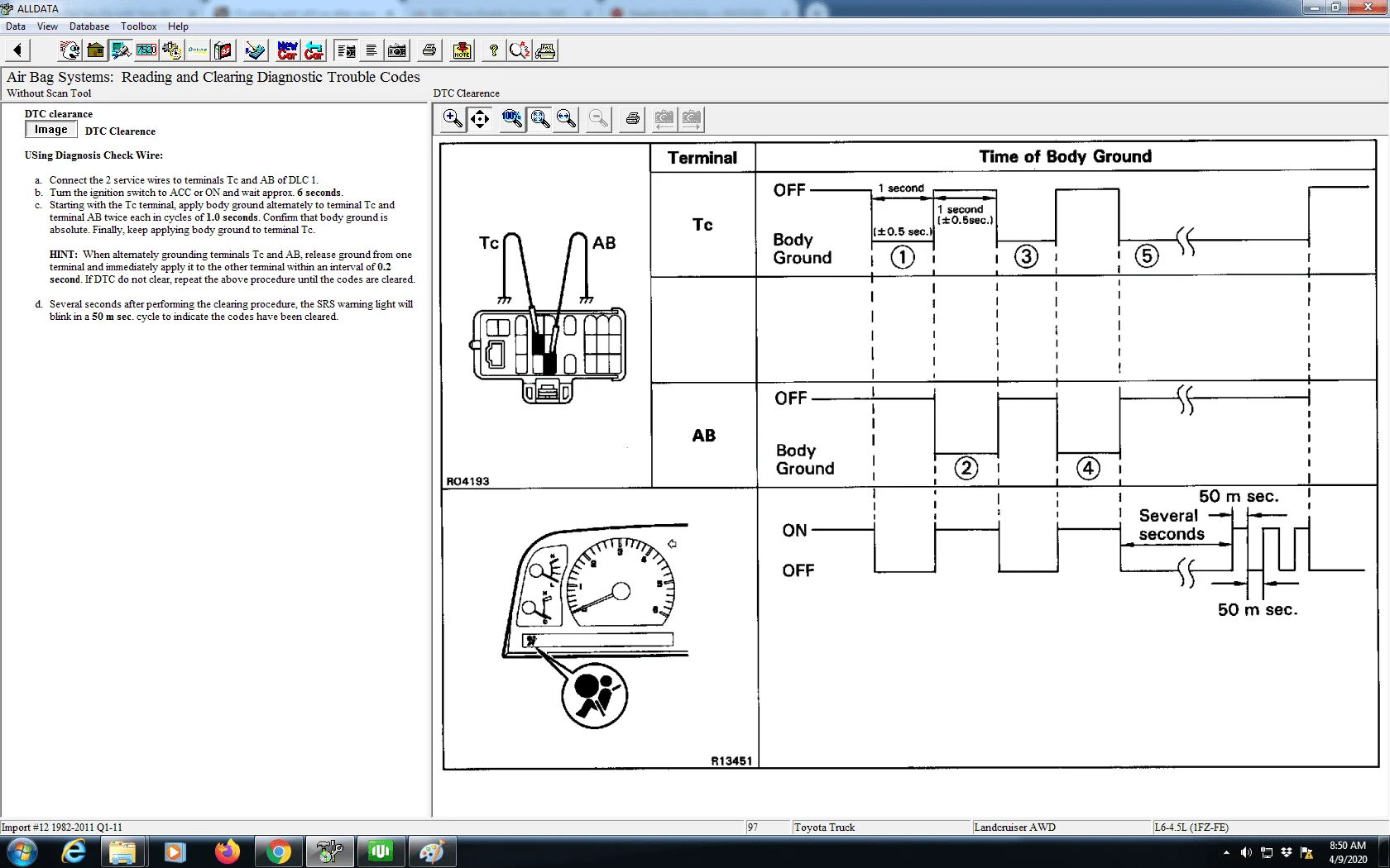

Tip for reset
Alternate between Tc and AB to ground, start with Tc with 1 sec interval.
On the 5th count, hold the Tc to ground approximate 3 sec.
when the airbag light blinking, let go the Tc.
If hold the Tc for to long, the airbag light will remain on.
Tip for reset

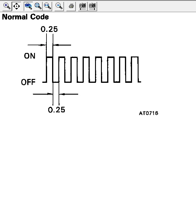

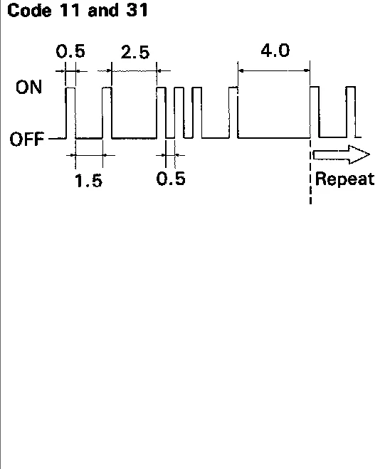

I reset the srs light again and it popped back up again in about 4-5 seconds. According to another thread on here, that means that there's a hard fault with the srs.
I got the dash to finally show a code 31, so I guess I'll just replace the airbag sensor assembly with a used one. It says never to use SRS parts from another vehicle and only use new parts, but I'm not spending 800 for a brand new airbag sensor lol.
