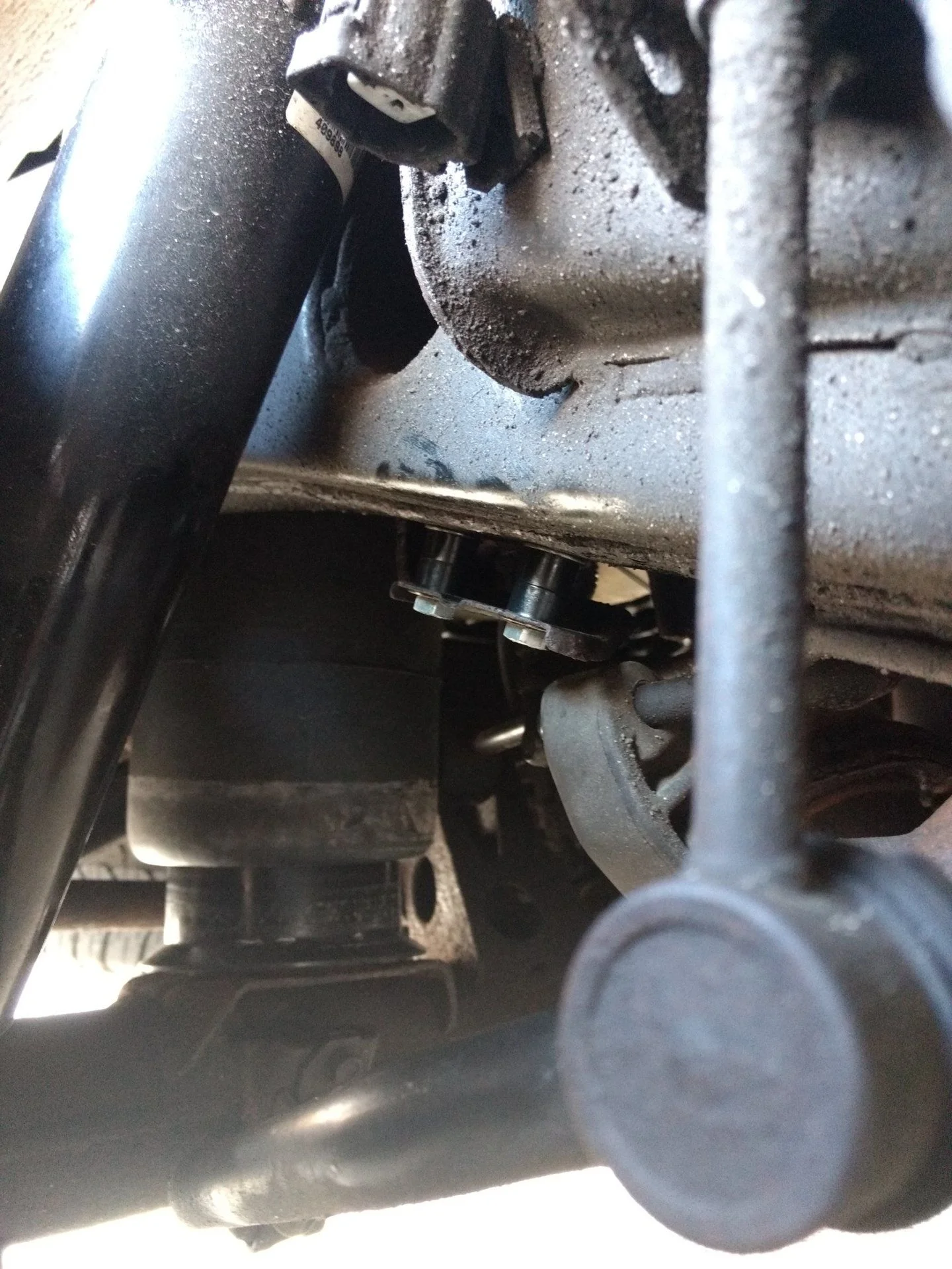

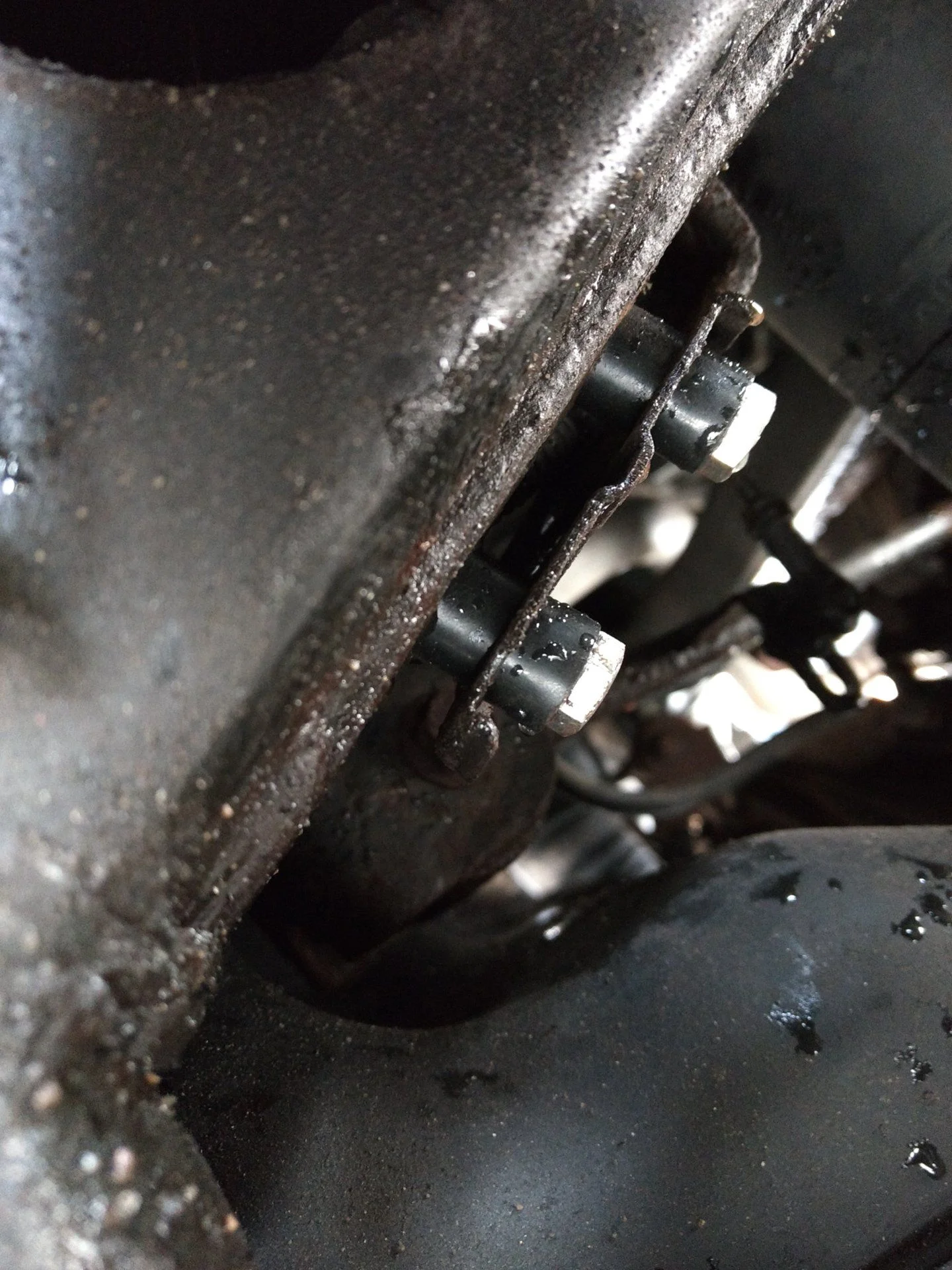

Pic shows the spacer.
Passenger side
Driver side ( double spacers)

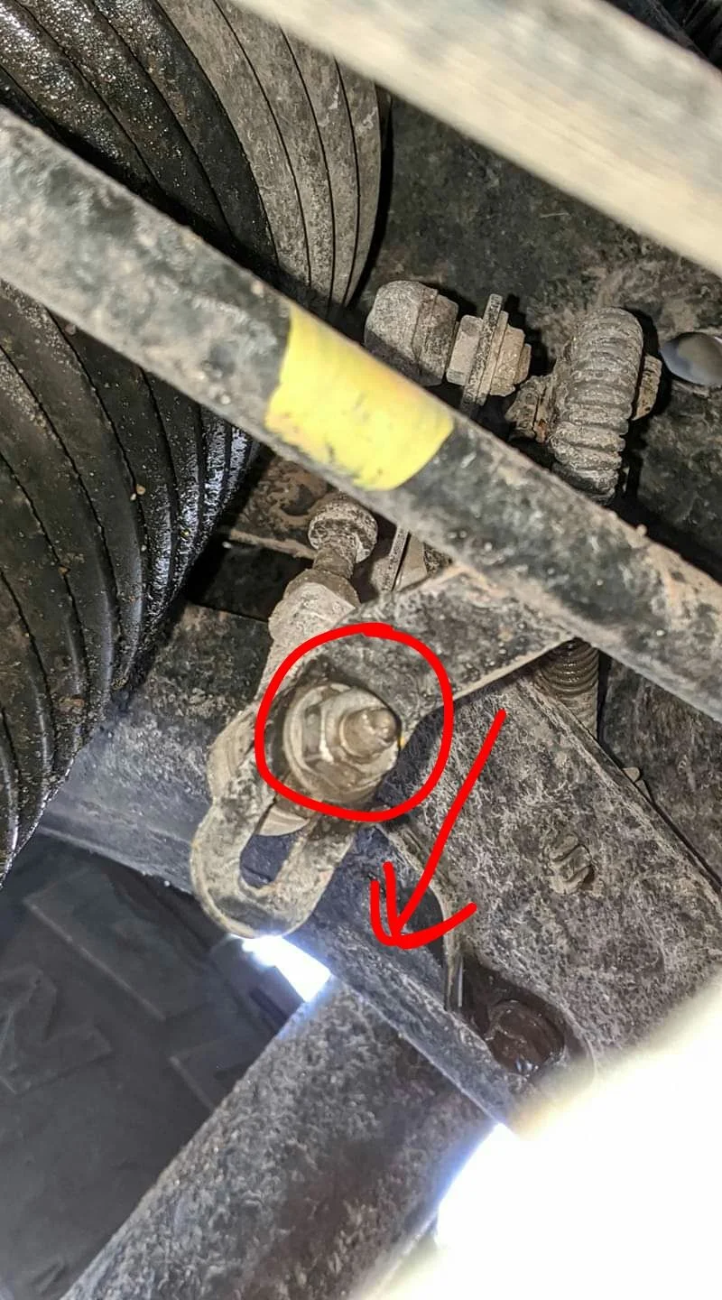

I then adjusted the nut on the arm of the sensor ( see the pic ) by put it all the way to the bottom and top and I still have the problem. And I still have the passenger side sits higher.
I don't know what to do next.
Should I change the sensor?
