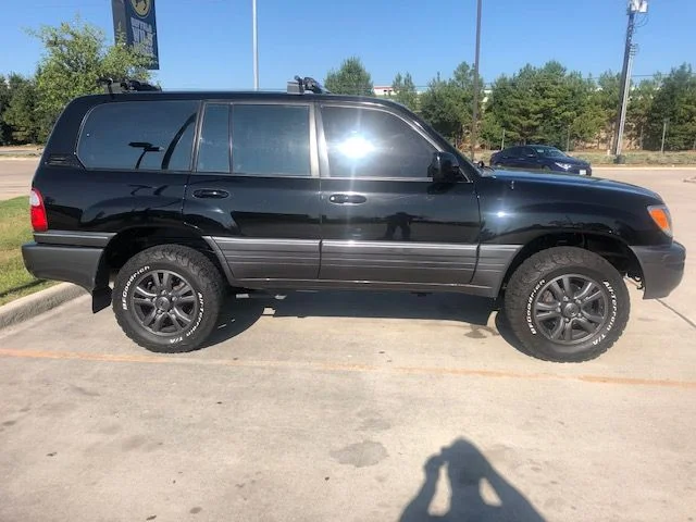

IMHO, I have the LX 470 (Landcruiser in a prom dress), 03 model with the AHC that worked fine. And I wanted to remove and lift it with a mild application (I know, it worked and I could have kept it but I wanted change--also, all parts worked, its a Texas rig so no rust, if someone wants it all or any, make me an offer and pay shipping).
Back to the experince I want to share, this is my first 100 series, as my son and I did lots of 4Runners in the past, so I tossed around many options for my particular use of this 100 series, which is about 85% pavement and the rest off road for hunting trips, trail riding or beach. So once I accepted my true needs vs the wants (yes it would be fun to build the crawler or climber) then I searched and read the forums, which contain a wealth of info and I envisioned my wallet getting thinner.
Conclusively, my application was for a for a seemingly good ride, functional for my offroad, along with the effeciency of change and most importantly economy. I chose the OME medium kit but with Sway Away Torsion bars, all from Rocky Road Outfitter (super customer service and knowledge base on the LC as well as others).
Brief run down:
A. The Sway Away TB were about $100 less than OME at the time, so I tred them and no issues at all, they work great for my application. Install was 6 mos ago. As noted above the LX 470 TB's are too week to turn up, they are made for the AHC combination that gives a wonder ride, so to the earlier comment they will need to be changed, (once their removed they make a good pry bar for your tool bin).
B. The OME Medium shocks ride nicely for me, it seems the old AHC shock bushings were shot so my replacement fixed a few minor rattles, then I followed up and replaced the sway bar bushings and everything is tight, and rattle free.
C. The rear springs for the Medium kit were actually stiffer than I liked but only stiffer in height than ride (I prefer a little rake with the front wheels higher but once its loaded, it levels out). Application OME 860.
D. For my lift, my objective was to achieve factory alignment and not have to do UCA's (my rig's previous, female owner over serviced this unit at the Lexus dealership so the ball joints were replaced at 100K, this among many other things allowed me to buy this without hesitation). Now there may some may debate, and I respect it, but I did not want to replace the UCA's with an adjustable ball joint at this time; however, this is a possibility for the future if raise it higher. Again, when I mentioned economy, its all about application and the size of the tire you want to squeeze in the well and the thickness of the wallet. So I pre measured my AHC at full height and readjusted my T bars to that setting.
E. Next, I bought a sack of cheeseburgers for the brake shop and we discussed the mechanics of how to alight a LC or LX to achieve factory specs for the camber, caster and toe in
F. Six months later, thousands of miles and tire wear is fine on my K02's, which is somewhat stiff for the road but that is because of the 10 ply tires (I know they were take offs and great deal). I prefer Pizza Cutter tires over width, my goal is contact pressure and minimal wheel rub plus I don't want to degrade the spectacular 12 MPG with a tail wind. Tires are BF Goodrich KO2 275/65R18, rims are factory but painted granite gray to match the trim.
Finally, I am old school and do all of my own work, except the alignment and wanted to share my experiences and outcome, because you have a great rig with somewhat unlimited options. Couple of photos below (rack are Yak bars with garage made Z bracket so I can pop my kayaks on top for fishing on the coast).
