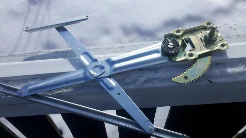

Got the Dorman front window regulator and it looks good.
EDITED with Correction: 749-821 is the RIGHT FRONT regulator. I installed it and it works fine
I ordered: http://www.partsgeek.com/ss/?i=1&ssq=749-821&x=0&y=0
The LEFT FRONT IS:
http://www.partsgeek.com/ss/?i=1&ssq=749-820&x=0&y=0
Pics of old and new below: Spring faced up, short brace on top, long brace (connects to window) on bottom
dougbert
How's the quality compared to the OE regulator ?
the pics pretty well cover it, the appearance looks good, the joints are tight, the "runners" seem stronger since they do not have lengthwise "holes" if you will.
How will they last and now smooth operation? After installation I will post info. Have to use them for some time for repeated up/down cycles, and return and report later. They are in better condition than the old ones for sure.
the "small gear" meshes well (need to lube it prior to installation), again it looks good.

Okay just got my Dorman 749-820 regulator below in pic 1
pic 1 is the LEFT Front
bottom is old RIGHT front

Picked up the Dorman from Partsgeek.com for the DS of my 60. Proper part for the proper side. Adjusted right. Lubed everything inside the door, except the crank which is filled with a bearing/joint type grease, with Toyota white lithium spray (One of the better $8 I've spent.) and the whole door operates like new, as in smoother than most of the new junk I've opened/operated the doors of. Also, highly recommend the Sil-Glyde as Norsk previously mentioned for all rubber and glass tracks. My window rolls up or down, single-handedly, when I want it to. Smooth, clean, and sweet @ any speed. What more could I ask for @ <$53 shipped. Can't speak directly to the quality of the bearings inside the crank or center pivot but there is no obvious play in the unit, at all. And, it's made in Taiwan, which for most quality indications is a plus.
