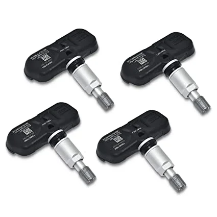

just had new wheels and tired put on. decided to go with new set of TPMS sensors.
used these https://www.amazon.com/dp/B00NQ05U24?psc=1&ref=ppx_yo2ov_dt_b_product_details and they worked.
shop had issue reading them, they used Autel tool, when tried using 2013 LX570 it didn't work.
changed year to 2012 and it worked. strange since there was no 2012 LXs in US... but thats what it took.
The link is broken... any part# that you used or new link?

You can get Denso / Pacific industries sensors from rock auto. PN should be 550-0103 for a 2014.
