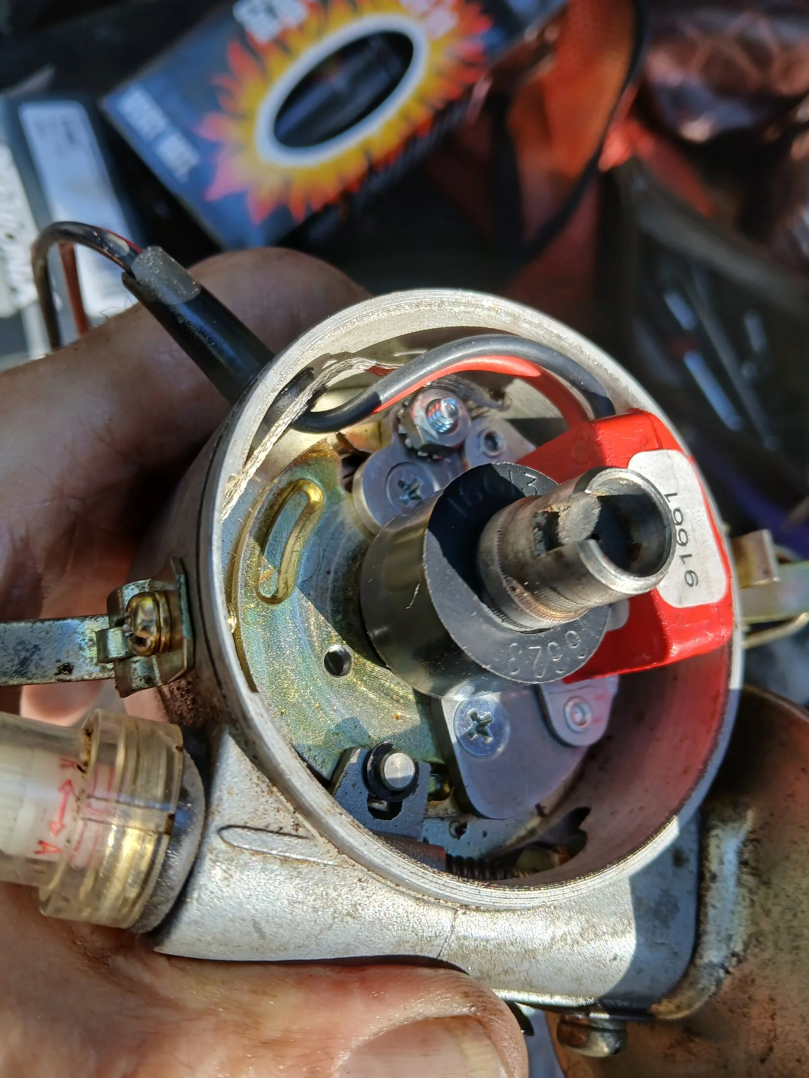

I ran the BigCap 60 series dizzy for a long time, It works really well, no complaints, it runs on bearings and might be waterproof. I changed the vacuum advancer to a single diaphragm and swapped in some different springs for fun. Then I found a like-new '76ish vacuum advance dizzy. It has the octane adjuster that I like. So I got a Pertronix for it and I'm running it now. Naturally, I carry the BigCap and ignitor with me. What I really want, a project I've got going now, is a '69 and earlier dizzy with a Pertronix. They have the octane adjuster too, but have that cute little brass oiler thingy that I really like.

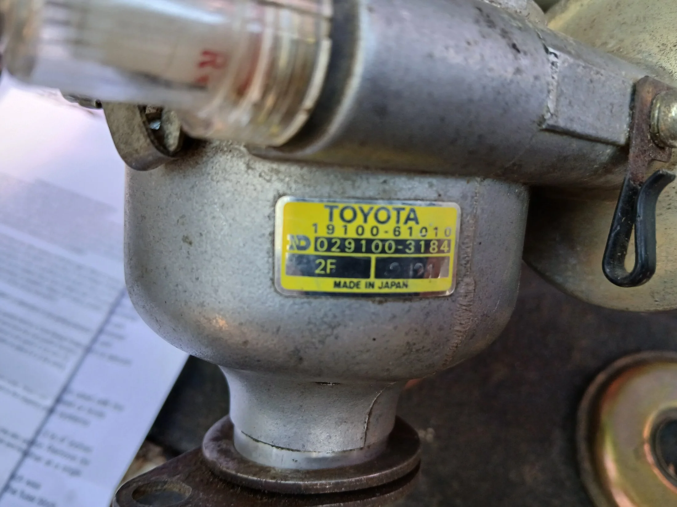

A complete USA-'76 coil / igniter is basically electronic ignition, but, conducting small amounts current across points, not induction. The '76 distributor is vacuum retard, so you might want to change that.

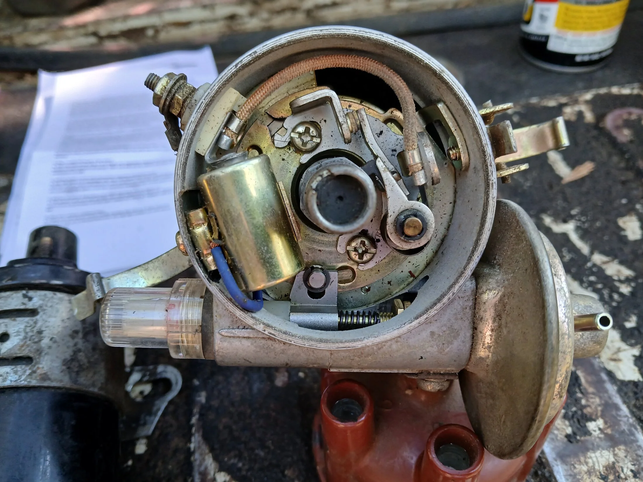

This one might be a '75(USA) or '76(non-USA?) vacuum advance. Pics of OP's dizzy would help...
