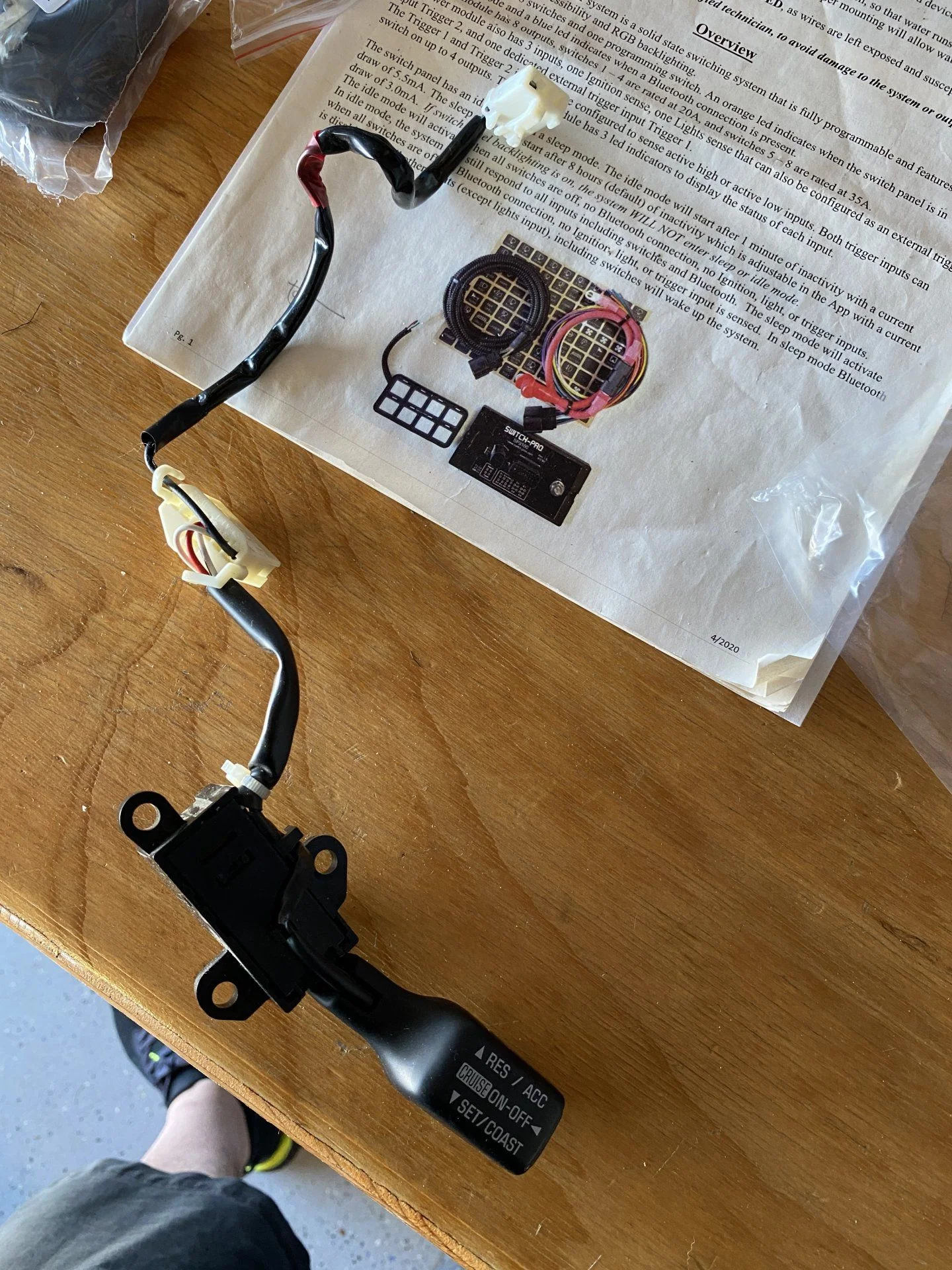

cruise isn’t lost with a steering wheel change as the cruise is a stalk that can transfer over
for some reason I was thinking it was attached to the wheel more permantely
here’s the stalk. should be easy to adapt.

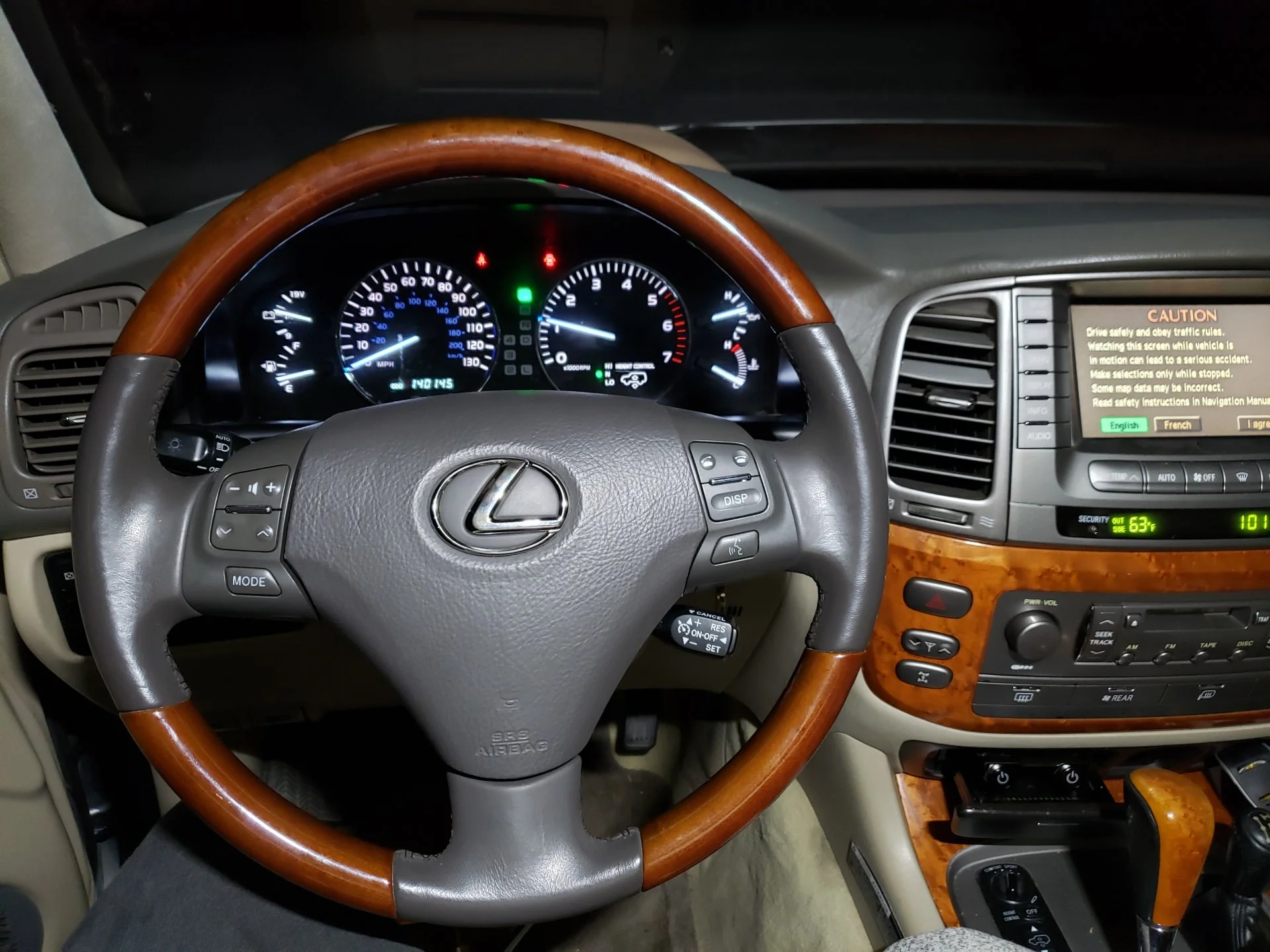

07 Gs460 Steering wheel
03 LX470
I kept the lx470 cruise control switch

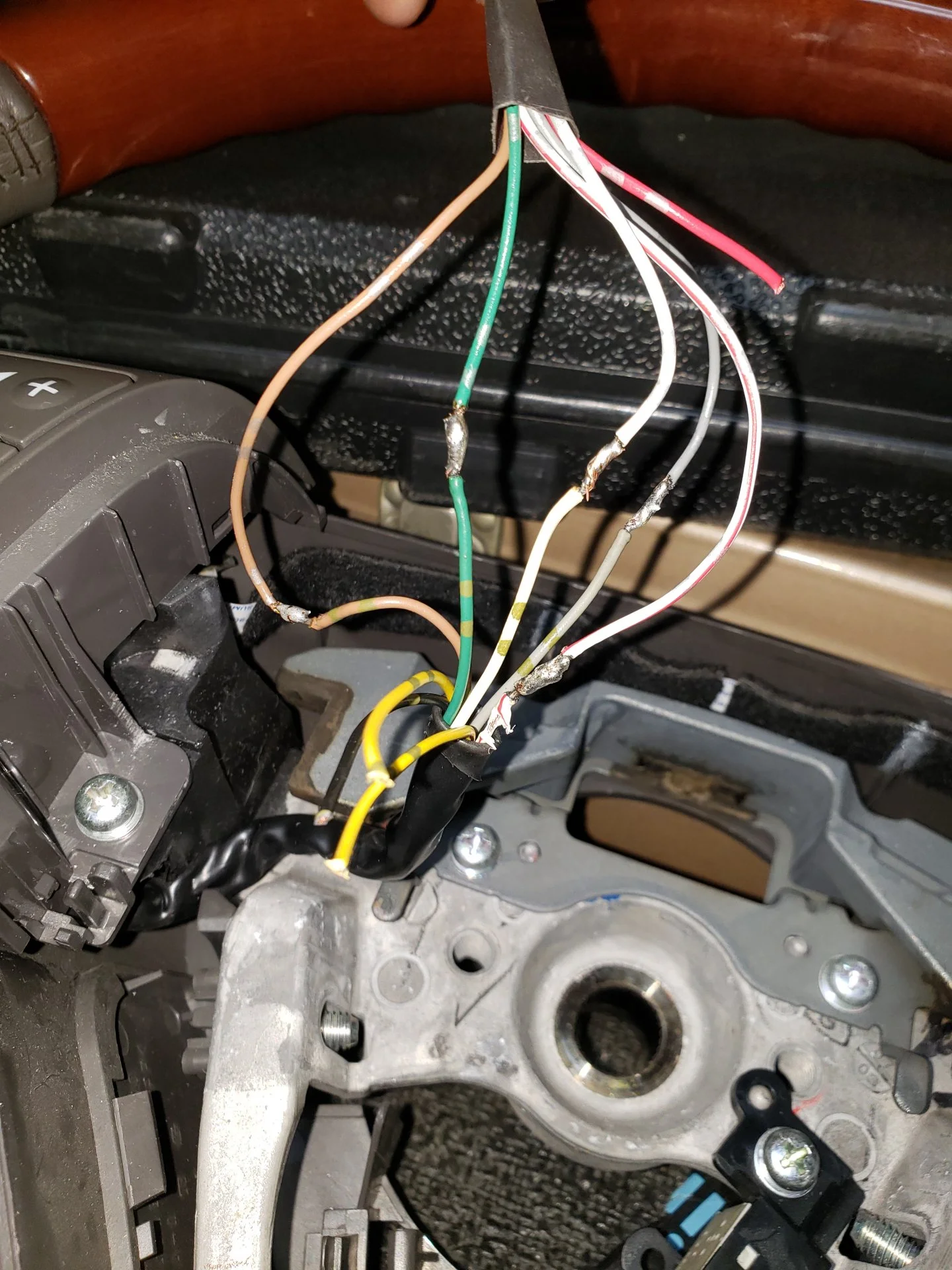

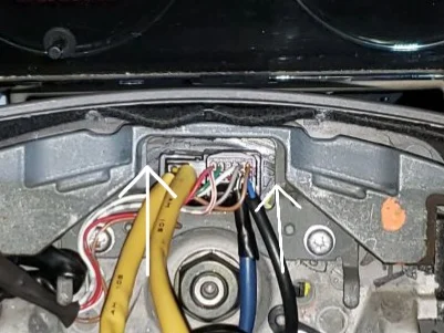

I cut gs plug and kept the plug for Lx470 clock spring 4 wire need to be connected to retain steering wheel features
This was the testing phase lol. Just wanted to show pic.
I cut and resoldered added heatshrink.
I also put rubber spacers in between clockspring n steering wheel. So it wont have any play.
3 wire left cut
