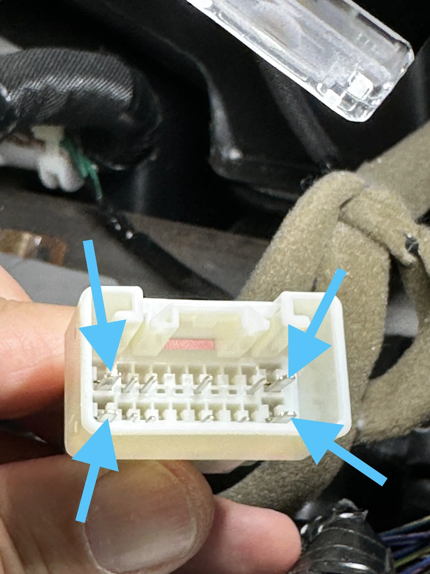

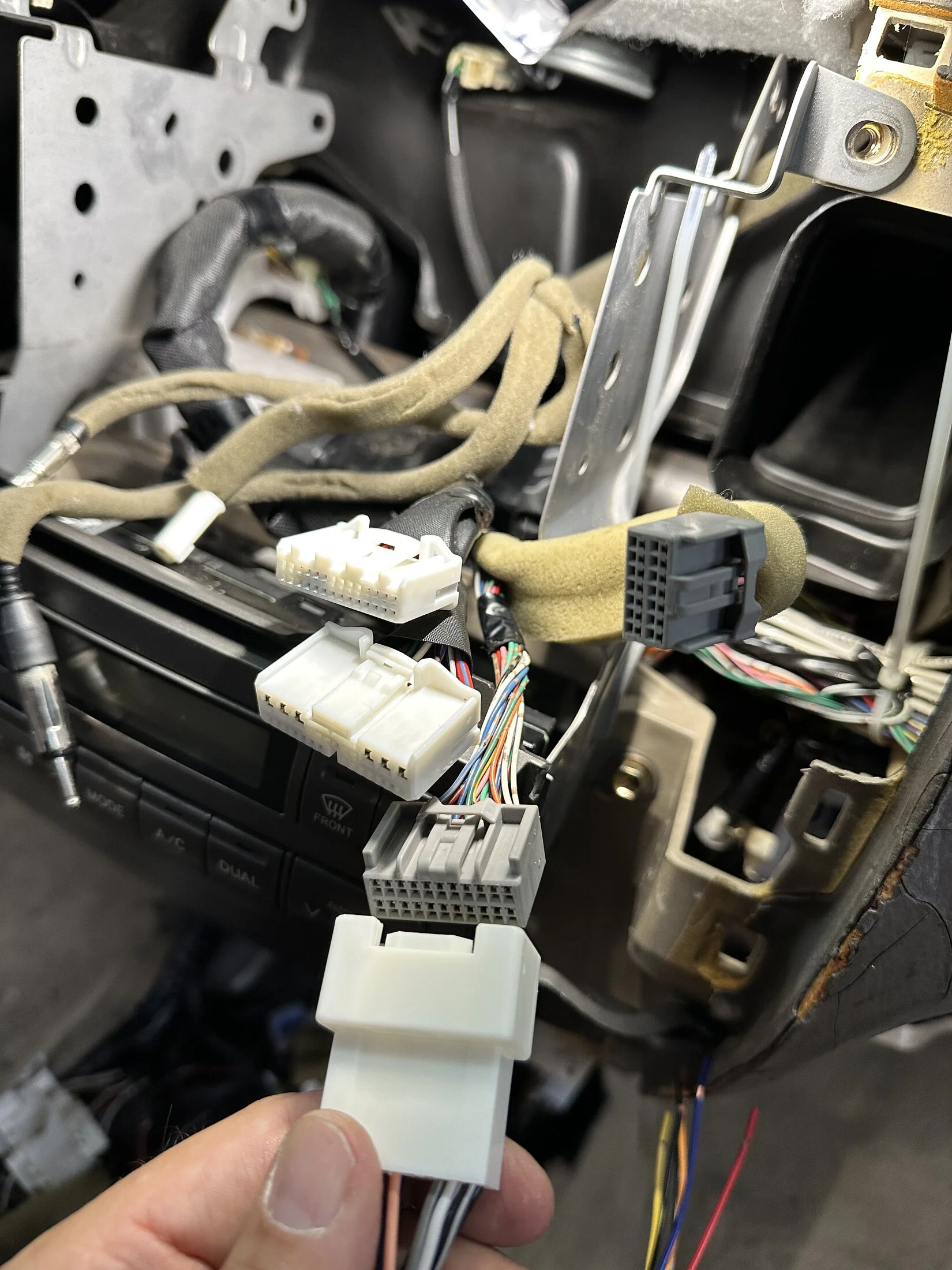

I just finished up my non-nav conversion and started on installing the new head unit. The setup I ordered from Crutchfield came with the Axxess TYTO-01 Wiring Interface, which I've read that other people are having success with. However, when I try to connect the wiring interface to the OEM harness, the pins in the interface are too big for the OEM harness end. It's hot and I'm a bit tired...but what am I doing wrong? Or is the wiring interface wrong?
Just figured it out..I'm using the wrong plug on the vehicle side. The correct plug (at least the one that fits) is part of the harness on the lower left of the radio that bolts into a bigger connection.

Yes I'm using a double din, and it's still in process. Trying to troubleshoot why there's no sound. 🤬
