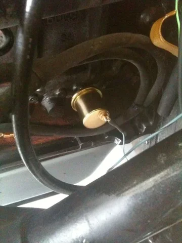

Yeah, I entertained that idea, but given the tight work area I didn't feel so confident, and i'm not sure if i even have a pipe tap that size. But, since you mentioned it, what the heck, I might just give that a shot.
Thanks for all the help, it is greatly appreciated.
Good luck bud!
Post up what you do.
:beer:
Tapped it! Worked like a dream. Thanks for all the help.
