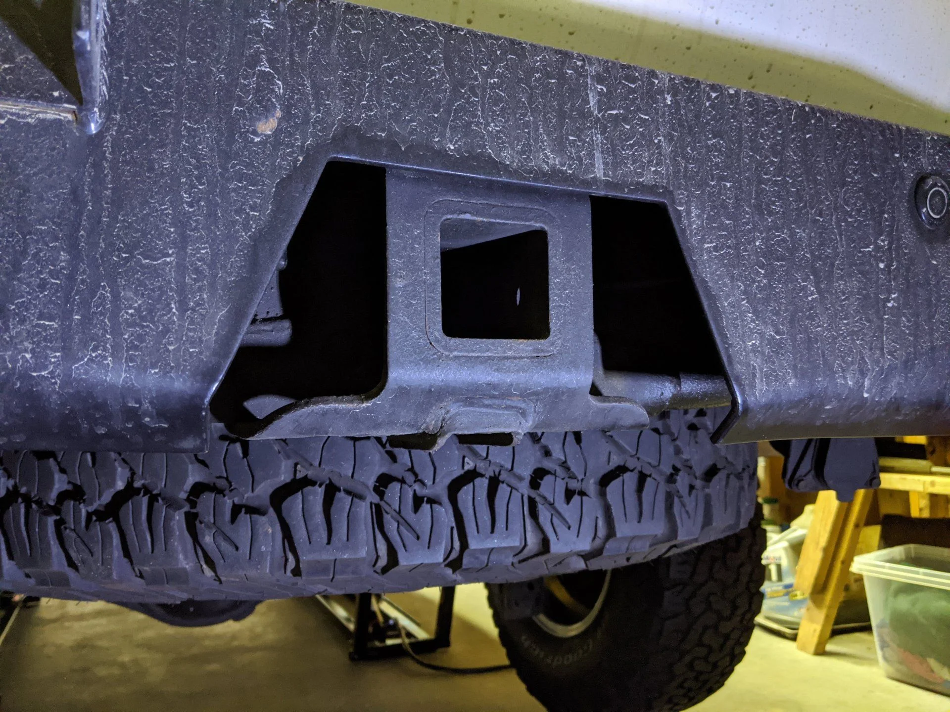

I've used pretty much everything (except "Corrosion Free", need to try that one), and I find the Amsoil HDMP to be the best at staying on and protection. It's too expensive to coat the entire underside, so I just do critical things, like the infamous KDSS valve body, and my rear crossmember at the trailer hitch receiver. I like how it cures after a few days to a nice durable waxy coating that does not wash off (unlike Fluid Film). I've been squirting in strategic spots on my rear RLC bumper and it's really doing a great job.
My trailer hitch, not a spec of rust:

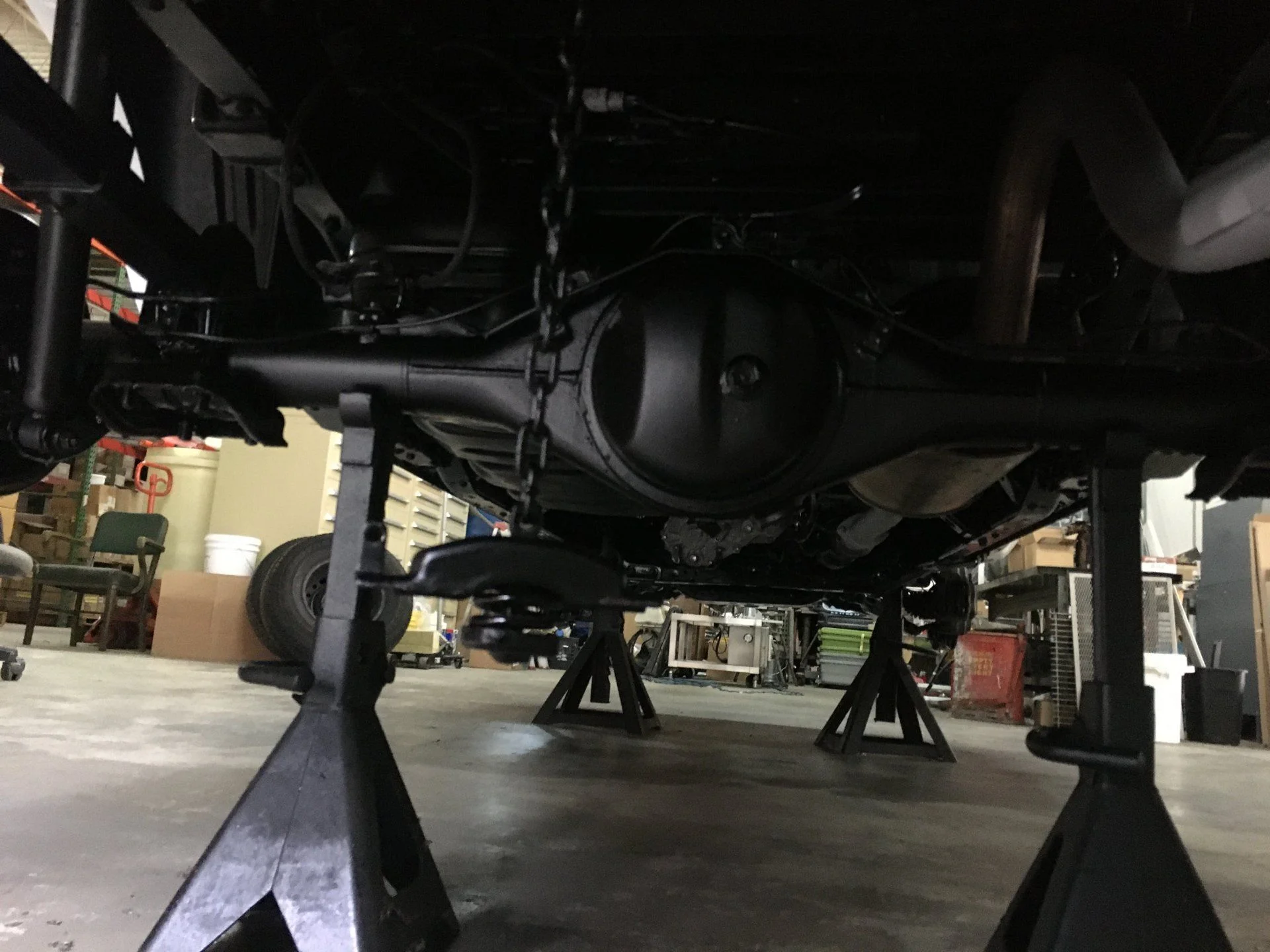

I am building a 200 now to live in Upstate, NY. I ordered a Dissent aluminum rear bumper. I asked the team at Ed Martin Toyota to use Eck on all bolts and UHMW washers at all bolt heads and under washers to isolate metals. I also had the aluminum epoxy primed then color matched. I have an ARB bumper for the front which will have a full color match. Once that is done the entire underside will be cleaned with Krown salt eliminator, dried then coated in Waxoyl Hardwax and the rockers and hidden areas and inside the frames with Waxoyl 120-4 cavity protection.

My daily driver is a 2015 Tacoma that was exposed to few winters that started to rust and I cleaned and Por-15 the entire chassis including the bottom of the floors .

Por-15 has held up well , no signs of corrosion so far , I plan on doing the 200 the same way .
