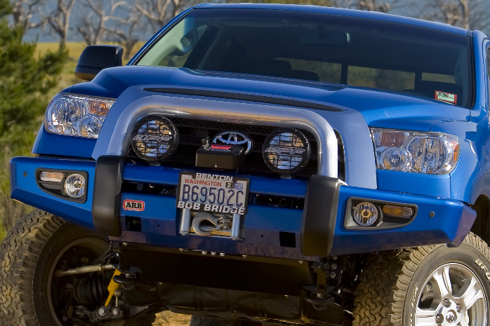

I just picked up a new Sequoia for my wife and am planning on turning it into the light-duty offroad/camping rig. From what I have read the 2007-2013 Tundra ARB bars will bolt directly on to a Gen2 Sequoia, and in general most 2007-2013 Tundra bumpers will work on Gen2 Sequoias with no or minimal trimming.
I think the ARB Sahara without the chrome hoop is my top choice currently
But the traditional Bull Bar definitely looks bad ass

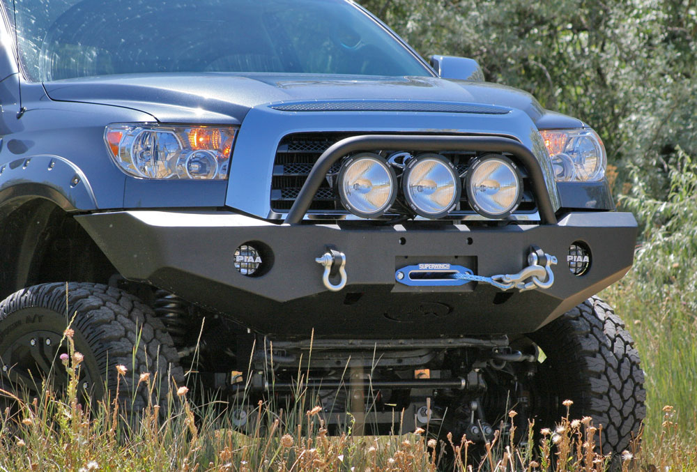

THIS IS WHAT I WAS TOLD REGARDING TUNDRA BUMPERS ON SEQUOIA'S " you can fit our tundra bumper on your Sequoia. It will fit right up but does leave about 1" gap under the grill- other customers have installed light bars there or you could also purchase a tundra grill which would bolt right up and get rid of that gap."

The post right above yours shows the tandem off-road bumper and their site says 08-22 compatibility.
I don’t think anything changed in the MY14 update other than the headlights (?).
@412Sequoia an 2007- 2013 Tundra bumper should be a direct fit. The front end is identical. Only in 2014 did the lines of the Tundra change. So Pre- 2014 bumpers will fit a Sequoia from 2008-2021. I am making the assumption based on having the early 2nd gen Tundra ARB on my 2008 with the 2021 headlights. No grill change was necessary.
