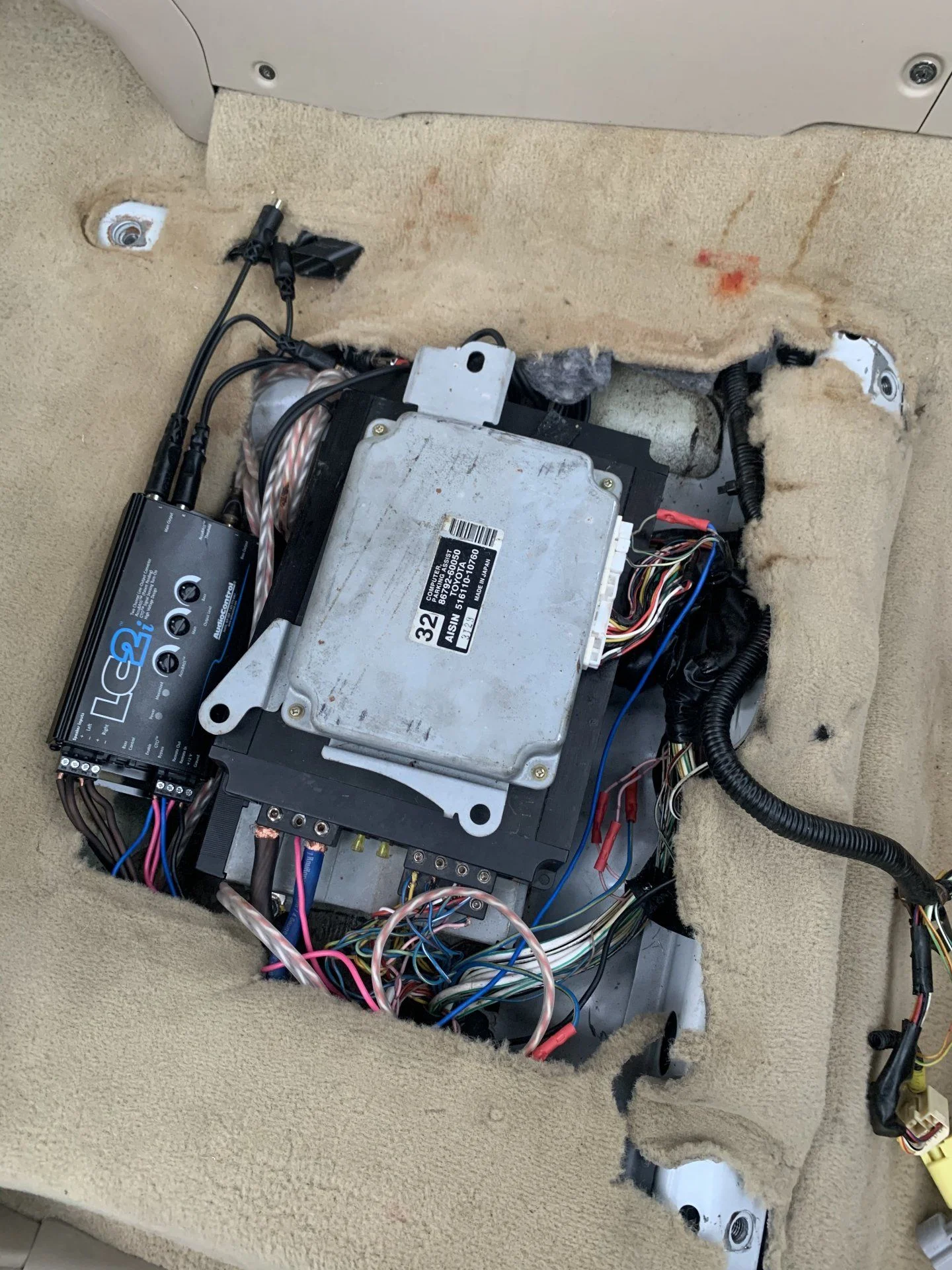

Well today was a huge slight success. I reinstalled the factory nav unit/radio, installed the LC2i, the US Spec Bluetooth adapter and have sound! “Everything” works great but there are some big downsides. Like mentioned before I lost the ability to control volume. Being I will stream music from my phone 99% of the time I will use my phones volume buttons to control volume, I have tested it and it works great. The radio will have to be at the same volume unless I adjust it on the LC2 which is under the seat. The other downsides are not being able to adjust the balance or fader via the head unit but the aftermarket amp and LC2i can do that.
while digging more into this I found a second amp installed by the PO that was setup to control the sub so I ordered a few wires to hook that back up and get all my speakers working.

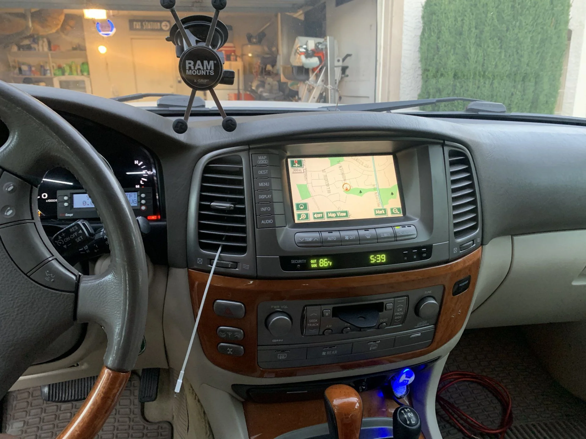

Nevertheless I’m happy to have the factory setup back in and working. I installed the Owl ram mount so once I get an iPad mini I will use that to run Gaia and everything else the Tesla could do.
