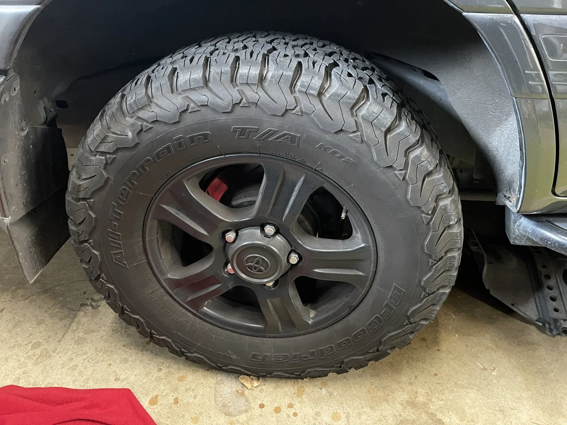

I am currently running Tundra 18" wheels (non steelies, pictured below) with 305/65/18 tires. With a 2.5" lift in the front and 1.5" in the rear, they fit perfectly without rubbing.

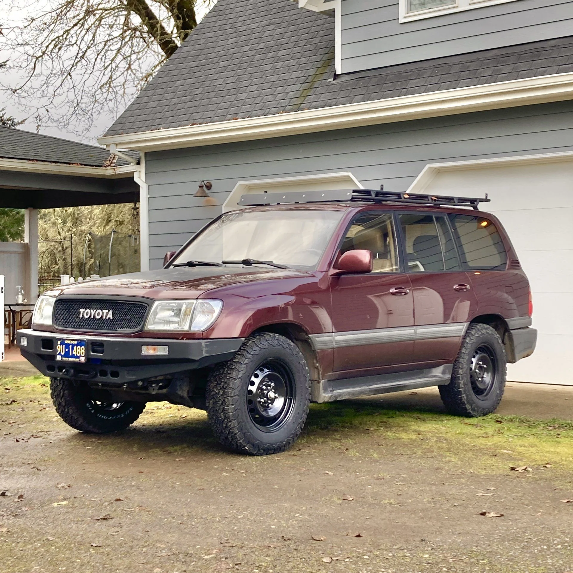

Pic of the cruiser below is for example only (not mine), but the Tundra wheel I have on there is mine.

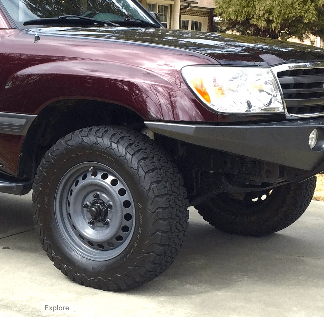

I just did this with 275/70R18 BFG KO2s. no spacers, no rubbing, everything fits perfect. I can’t speak to larger tires, though.
You should get different lug nuts since the alloy ones will have flat washers that’ll rattle around. The steel lug nuts just have a cone.
I bought everything from my local dealer since shipping was high from everywhere else. My local dealer has an online parts portal that gives a good discount, and a will-call option.
Wheels: 4x 42601-0C060
Lug nuts: 20x 90942-A1003
Notes: The steelies are heavier than the stock alloys by about 11lbs. each (35 vs. 24 lbs., see: OEM Wheel Weights). And the lug nut torque is higher at 154 ft-lbs.

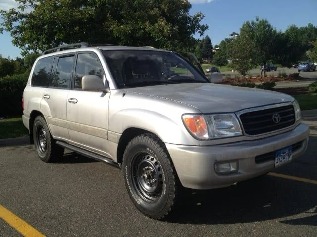

I've run the same combo on an LC and LX no issues.

And for what it's worth, here's the Melon sporting the same wheels and 275/70R18s and I love this setup. No negligent impact on the already abysmal mileage but totally worth it!
