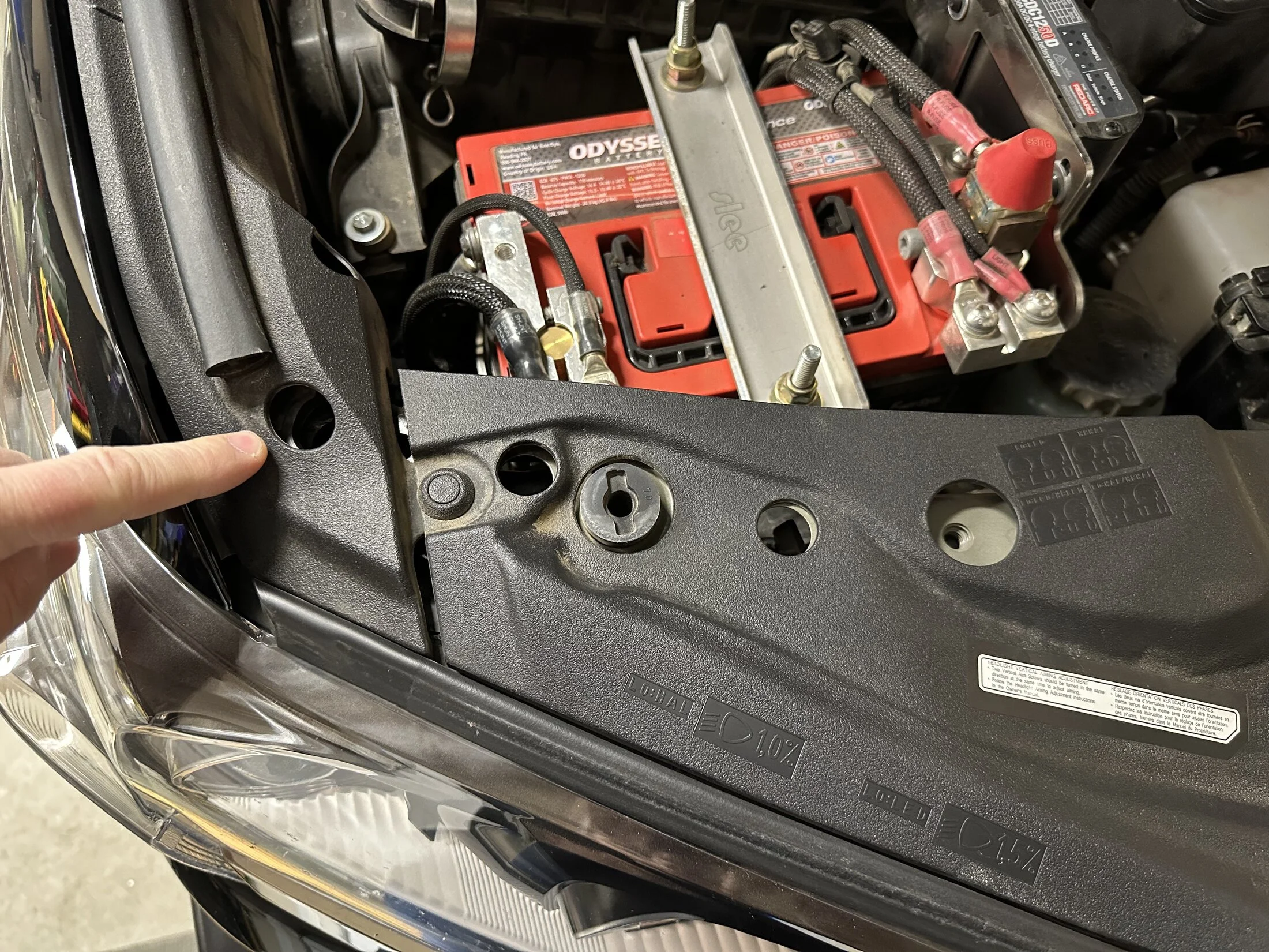

Are you still looking for guidance? I can grab some pictures from my '21 later today and show you where the adjustment screws are. There are two slots on either side. One controls up and down, one controls left to right, for a total of four screw slots.
The up and down slots are on the far outer edge a bit higher up than the left to right slot.
At least on my '21 with LED lows and highs, where I'm pointing to in each picture is where you'll find the screw for up/down.
There is a diagram near each that shows which way to turn, be sure you use the diagram that applies to your situation. In my case, it's LED hi/low, so I use the bottom left quadrant diagram.
