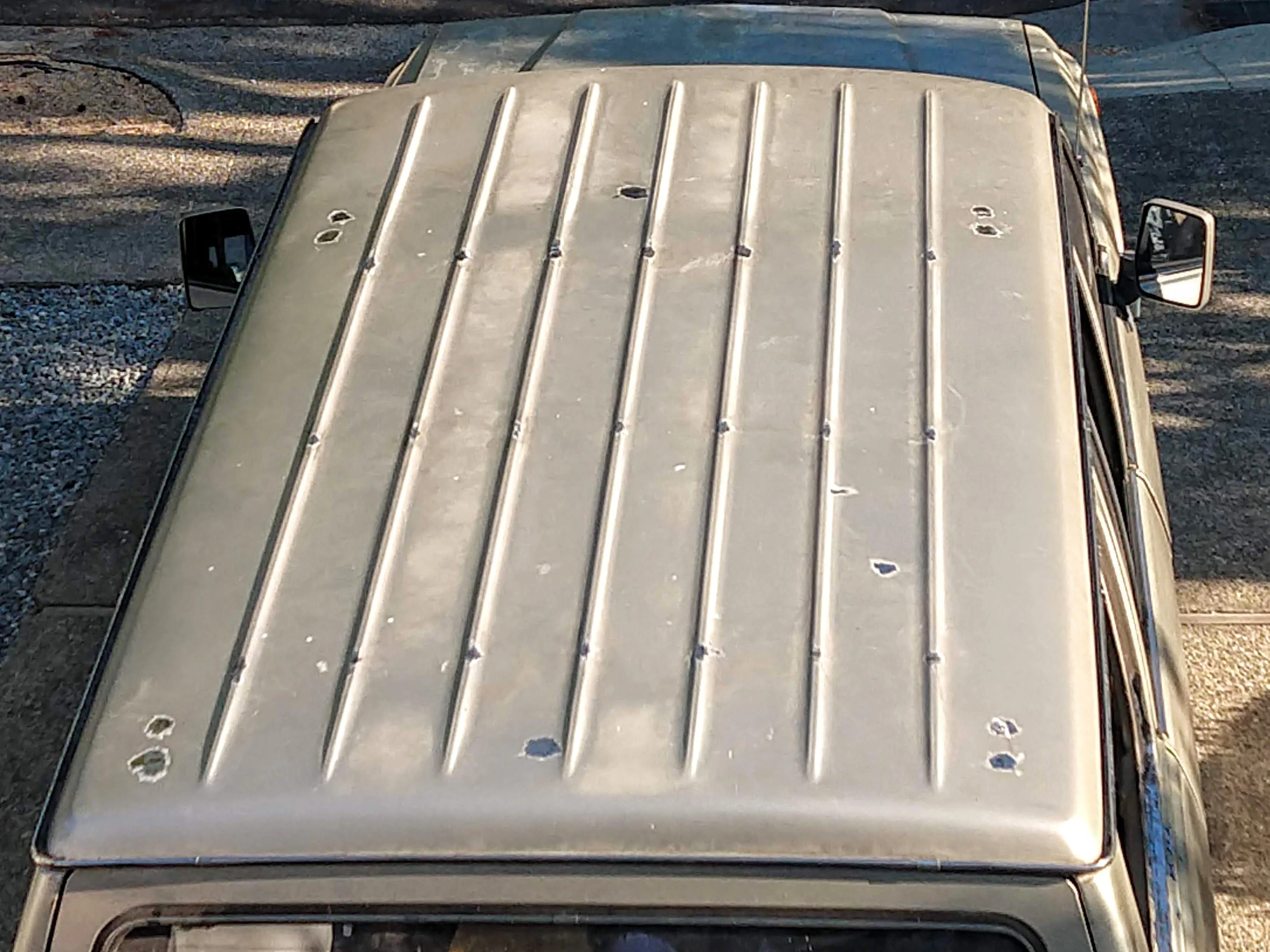

Got to work on the '60 since this whole COVID thing is keeping me from going into work... and started tearing out the headliner to get to mounting a C/B radio to the roof and address the x12 holes that some P/O had drilled into my roof for a 'safari' roof rack.
Here's what was left after the foam came down:
And here's a close up of one set of the holes:
Fortunately, my roof is relatively rust free. AND, I plan to Monstaline the truck's exterior when I'm done with this bit so I can afford to do some in depth (see; Welding) repairs and additions (see; Center Roof Console) to the sheetmetal and on the holes...
BUT, My concern is how to get this funky dried 1985 glue off my roof. It's CRUSTY, and hyper-dried out... and comes off as a dust when I chisel or grind it.

I started ripping mine out too. The interior always smells funky and good thing I did decide to rip it out. This is what I found, some nice mold:
There are holes in the roof, some with rivnuts and some without. It looks like the old factory roof mounts but the rivnuts and holes don't look very factory quality. Some of the holes are open which was causing rainwater to enter and grow the mold, and start rusting around the outside gutter rails from the inside out. There are also chrome strips on the ridges on the top of the roof which are just drilled through the roof with screws and of course there is rust starting around those.
All of this is fixable and the rust is minor at this point, and I'm also wondering how to remove the old insulation glue. I'll also be spraying some rust paint followed by linseed based rust inhibitor (not Fluid Film as it stinks like sheep inside the car) inside the enclosed rail along the top edge of the roof beside the gutter pinch weld. You can't access that weld directly but I'll first spray Eastwood Frame Repair rust paint to take care of the rust on the inside of the pinch weld (I've already painted the outside) using the supplied hose, then spray in the rust inhibitor using a similar tube sprayer to get it in there. That way, if any rust does decide to come back in the future, it will be stopped in its tracks by the rust inhibitor.

Similar to you, I ripped out my headliner - because I knew that I couldn't weld the roof without setting the headliner on fire. The original owner had a roof rack installed, a CB radio, and a cell phone antenna. Basically when I bought the truck there were 32 holes that needed to be welded. I haven't taken off all the dried adhesive from the roof yet - but have taken off all of the jute previous to welding all of the holes.
Now I am finishing up sealing my gutters and moving onto body work.

I think you may be my doppelganger. I was about to post the same thing. I have a silver BJ60 with 32 holes in the roof that I need to weld up...
I am going to rattle can the roof white. I painted my 4runner hood white with Rustoleum white auto paint and man that stuff has held up well over the couple years it's been on. Looks professional. If I sanded and clearcoated it would look even better.
All the other areas I'm just going to spray with silver Rustoleum wheel paint. For me that is the way to go because I then won't worry about scratches or sun fading. As log as the metal underneath is protected that is the most important thing. Plus, with a rattle can paint job it doesn't look like a nice rig, even though it will be... won't attract as much attention.
