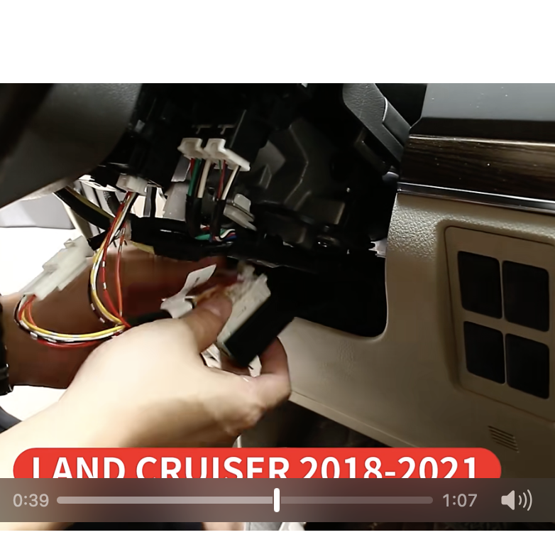

oh yeah, i'm a pro at this method! ...BUTTTT we just got a new navigator L black label for my wife, and i'm now daily driving the 200, and the navigator has autofold on lock as a factory setting you can enable through settings (and the f150 platinum that i just traded in also had this option, thanks to forscan)...so now i'm trying to do all the things to the 200.
i just ordered one of the OBD dongles from aliexpress that goes behind the canbus and mounts on the steering column after looking around at the link from @TeCKis300 in the prior post...and i'll post results here once that comes in and i get it installed. the one i ordered also lets you raise the windows with the key fob - you can only enable lowering the windows/sunroof with tech stream.

Got the part in a little less than 2 weeks. Took all of about 5 mins to install and test and button it back up. Works perfectly.
One item to note - this particular dongle apparently also rolls up the windows when you lock it with the key fob. I suppose if you want to leave the windows cracked in hot weather just don’t lock with the fob?

the OBD dongle i used doesn't occupy the port below the steering column and above the pedals - there is a port on the underside of the steering column and under the cover where the part piggy-backs into place - the OBDII port is still accessible.

there is a video of how to install the dongle i have on the purchase page - it literally took like 5 mins to pull the cover off install it and button it back up - beyond that, it really was plug-and-play. but it looks like the cable piggyback isn't an option for pre-2016 LC200s? the video is on the item purchase page, i put a screen cap below - the video subtitle says 2018 - 2021, but it worked great on my 2016. maybe that's the model years in asia? who knows...it also looks like maybe the wiring may have changed with the 2016+ models to allow the piggyback method with the wiring in the steering column?
